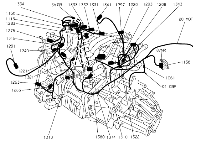

- x 6959
Re: Silly thought.
Glow plug relay....
The relay is on the right shown as 1158

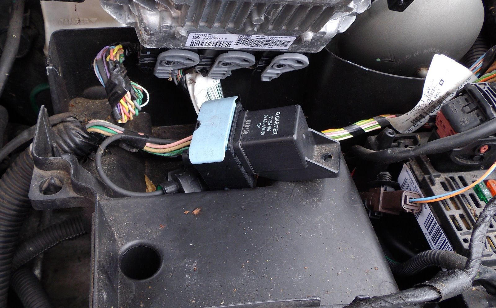

So here it is and at Neil's request the old glow plugs the one with the blue mark is the only one that works.
Also the relay which I've opened to show the innards, can get the points to close by connecting direct to the coil but otherwise nothing, new one ordered so I hope that's a fix.

I'm just hoping that the relay is a fix for the non-starting, not 100% sure.
I can't understand why it started first time after I put it back together then stopped after a couple of minutes.
