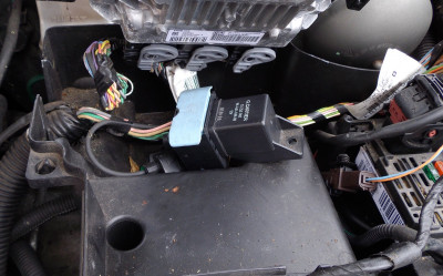

Thanks Marc I found it hidden away under the damned BSI I might take it apart and see what's going on in there.,

It should be near the engine fuse box, usually off the left side, it won’t be in the BSI which is in the glovebox Eric.

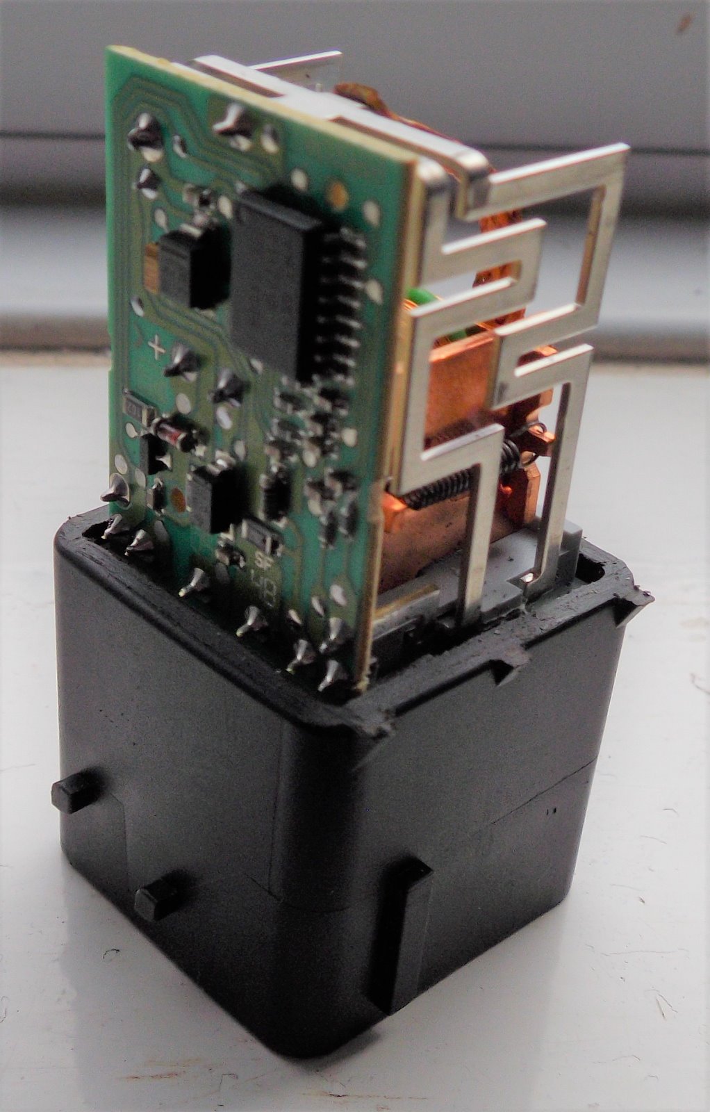

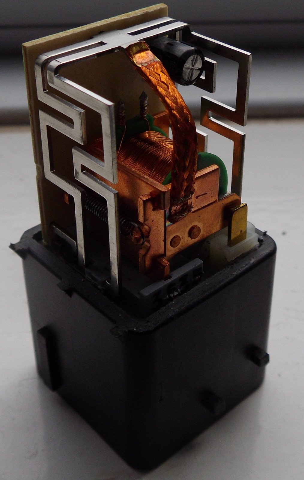

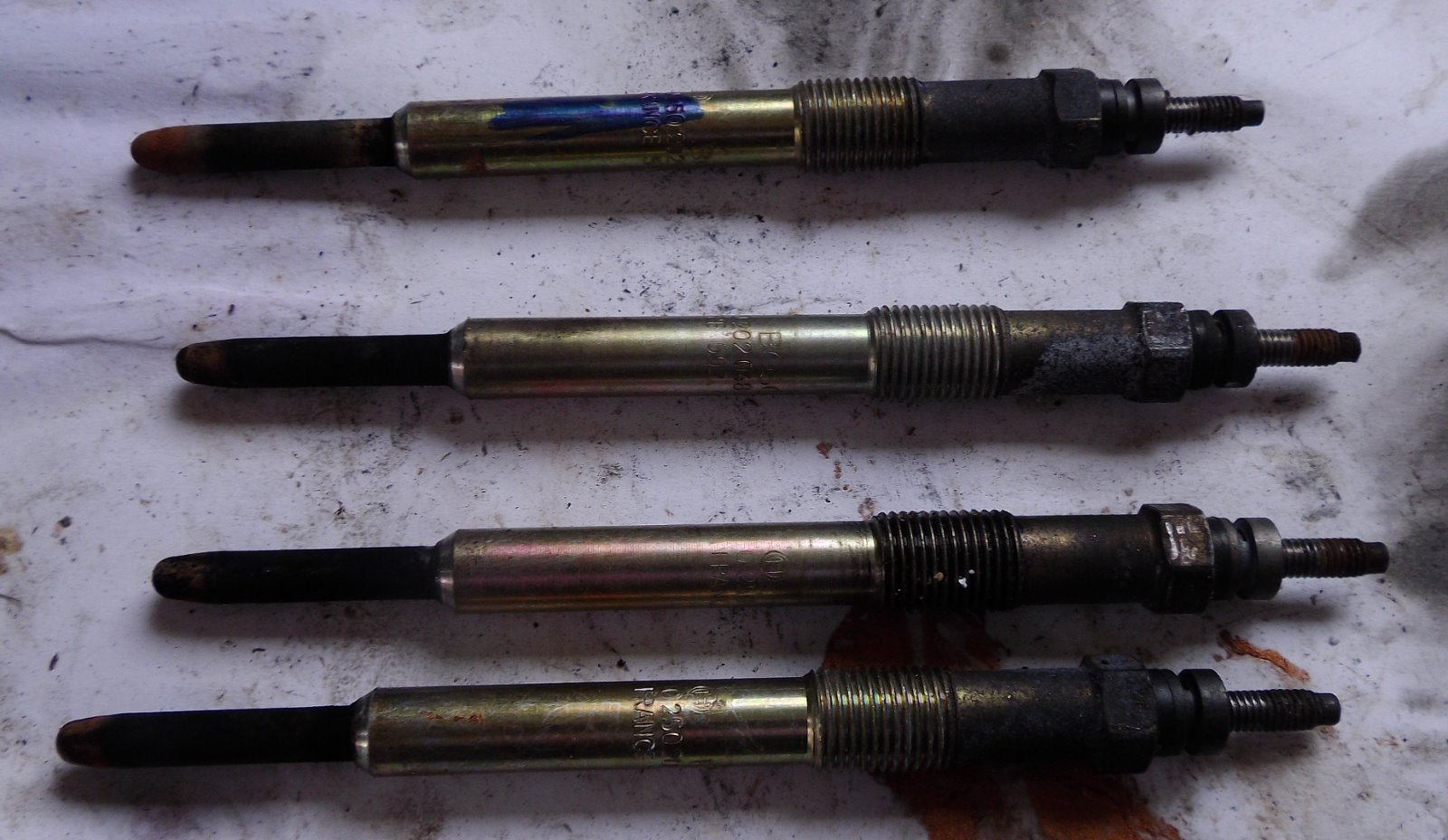

So here it is and at Neil's request the old glow plugs the one with the blue mark is the only one that works.
Also the relay which I've opened to show the innards, can get the points to close by connecting direct to the coil but otherwise nothing, new one ordered so I hope that's a fix.
