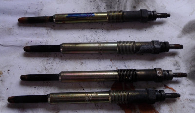

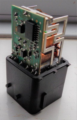

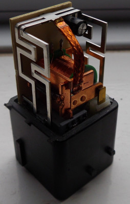

So here it is and at Neil's request the old glow plugs the one with the blue mark is the only one that works.
Also the relay which I've opened to show the innards, can get the points to close by connecting direct to the coil but otherwise nothing, new one ordered so I hope that's a fix.

Thanks Gibbo I like a picture or two. I may be following the same route myself with the Vectra, if my newly fitted glow plugs fail to spring into life. While glow plugs are not really needed for starting these days except in the most arctic of conditions, I do believe that the glow plugs could require to be operational in a regen, and a fault in the glow plugs/relay leg could stop the "computa" either initiating or completing a regen.
Maybe someone with greater knowledge of me on the C5 could confirm whether this is the case.
My little task on the Vectra has been to sort out an incompleted regen on the DPF. About to put it all back together after replacing the glow plugs and the downstream Exhaust Gas Temperature Sensor, giving the DPF the hose pipe treatment, and checking out the pipework to the pressure sensor.
Physically everything seems ok, but if one part of the sytem is not working then it blocks a regen of the DPF taking place. On the Vectra its as rudimentary as DPF systems go but whether the "computa" still has its knickers in a twist thinking that it is still stuck needing a regen even though it doesnt time will tell.
