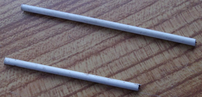

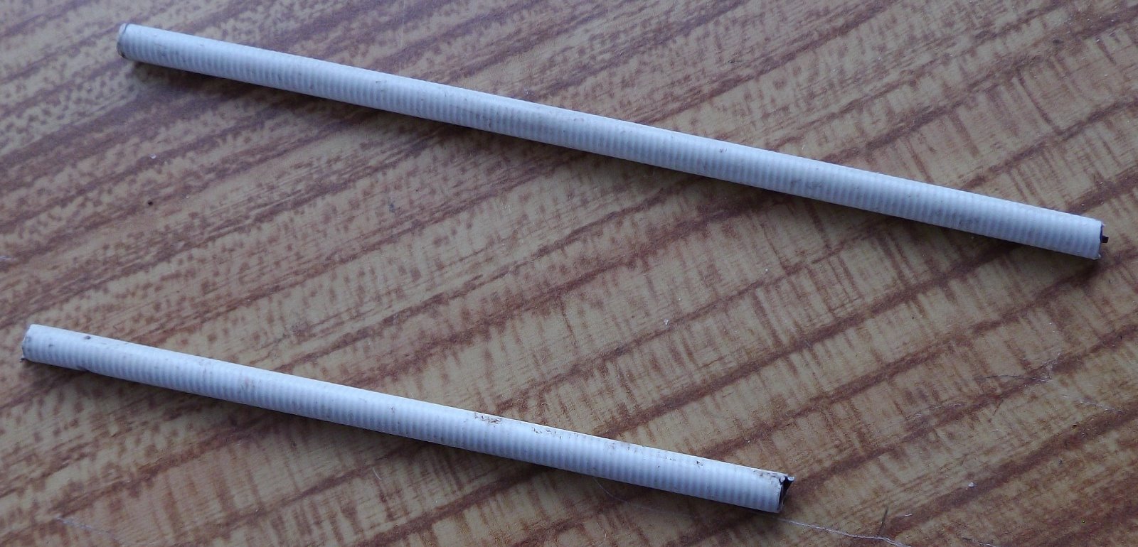

A tip for getting at the contacts in those deep connector sockets, use a couple of pieces of curtain wire, it fits well and is insulated, makes it easier to use your meter..
