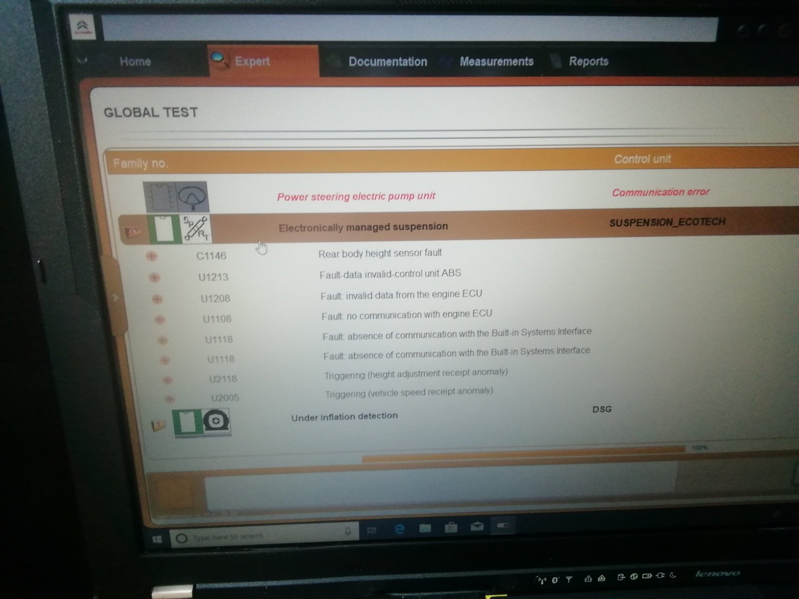

Hi,
Software and PC arrived today finally. Installed DiagBox 7.57 OK.
Ran diagnostics, faults all in top section. Mainly BSI engine speed sensor, then suspension (which I know about, and will ignore until engine starts).
The ESS connection block was the only harness I disconnected, my fault not disconnecting the battery beforehand.
However, I attach several photos in batches showing other errors.
The engine was running perfectly before work on cambelt etc, and all put back together properly; caveat, I don't know if I damaged the ESS connector or not.
I have owned the vehicle just 2 months, last 3 weeks it has been in hospital...

There is no date on these error messages, so some could be before my time.
Shall I press.... 'Repair'?! :shock:
Rgds
AJM

Note all codes and descriptions then clear them and see if they return. As you say, old ones could be lurking.

That's a lot of fault codes - but a lot of them are related.
All the ESP functions will be disabled if there is a problem with engine speed - and suspension data you can ignore for the present at those errors can be returned when the suspension ECU is interrogated.
Your starting issue though may be simpler - I saw that it has recorded 2 remotes and the engine ECU is unlocked - but none of the remotes are synchronised! That will stop the engine from being authorised to start. Here's the procedure:

I'm looking through some of those faults and the shear quantity of them - coupled with the communication errors is making me very suspicious that of the engine fuse box / but especially the Maxi Fuse part. The Maxi fuses provide supply to parts of the engine fuse box and the BSI.
During manhandling it is possible a short may of occurred, or the unit has been damaged. I would strongly suggest you remove the battery and inspect both the engine fusebox, all fuses and especially the maxi fuse box.
I know that a C6 owner had a multitude of faults and communications errors (too many different systems, and all at once). He replaced the Maxi fuse part and it got rid of the errors. They suspected that it had been upset and a short had occurred / damaging the unit - probably as so often happens the battery had not been removed before the work was being done.

Ran the Diagbox after doing key sync, rolled left trouser leg up, ran three times around the car backwards humming the French national anthem, cleared all faults, removed RH wheel and disconnected the Engine Speed Sensor, reconnected, cleared fault again, hummed the National anthem again while turning the ignition and she Started! Runs beautifully. Turned ignition off, restarted, runs beautifully! Left it for 15 minutes, had a cup of tea and a cigar, turned ignition, started beautifully, windows work, everything works on that front now, so a big thank you to you!
Tried to Donate, it failed twice with several retries, will do again shortly!
Syphoned off 2.5 litres of LDS and refilled to solve the remaining problem of rear self levelling.... But that's another thread!
Thank you so much Marc for your wonderful advice and mega efforts, it is greatly appreciated.
Can we talk about the Moon Landings again now please, that was surely the second best achievement of mankind after starting my C5 🤔😀😂

Excellent - just keep an eye on things for a bit - I'm pleased it wasn't any of the fuse boxes in the end.
