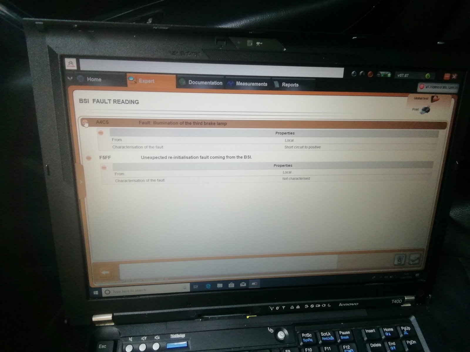

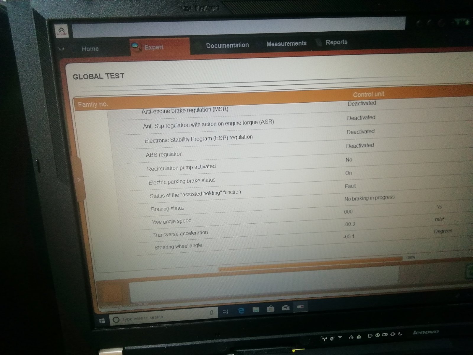

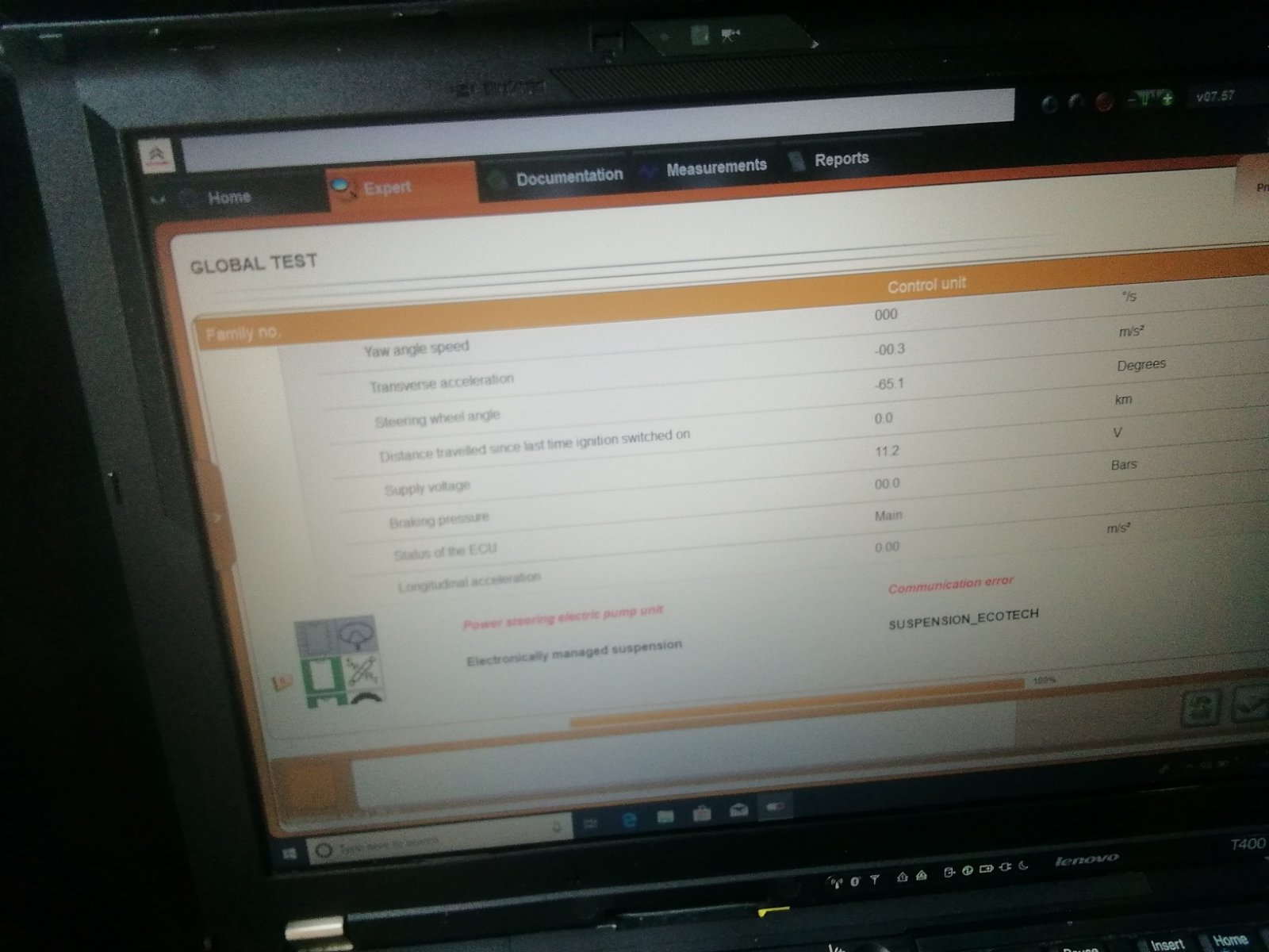

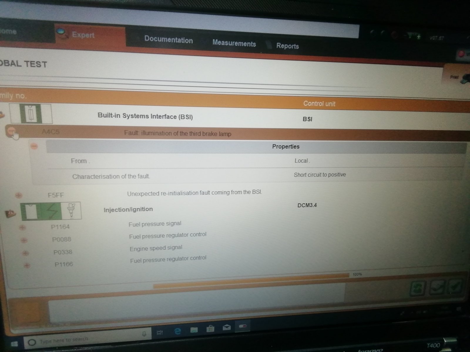

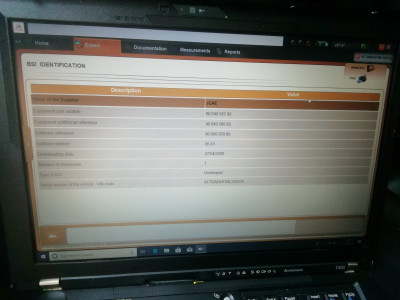

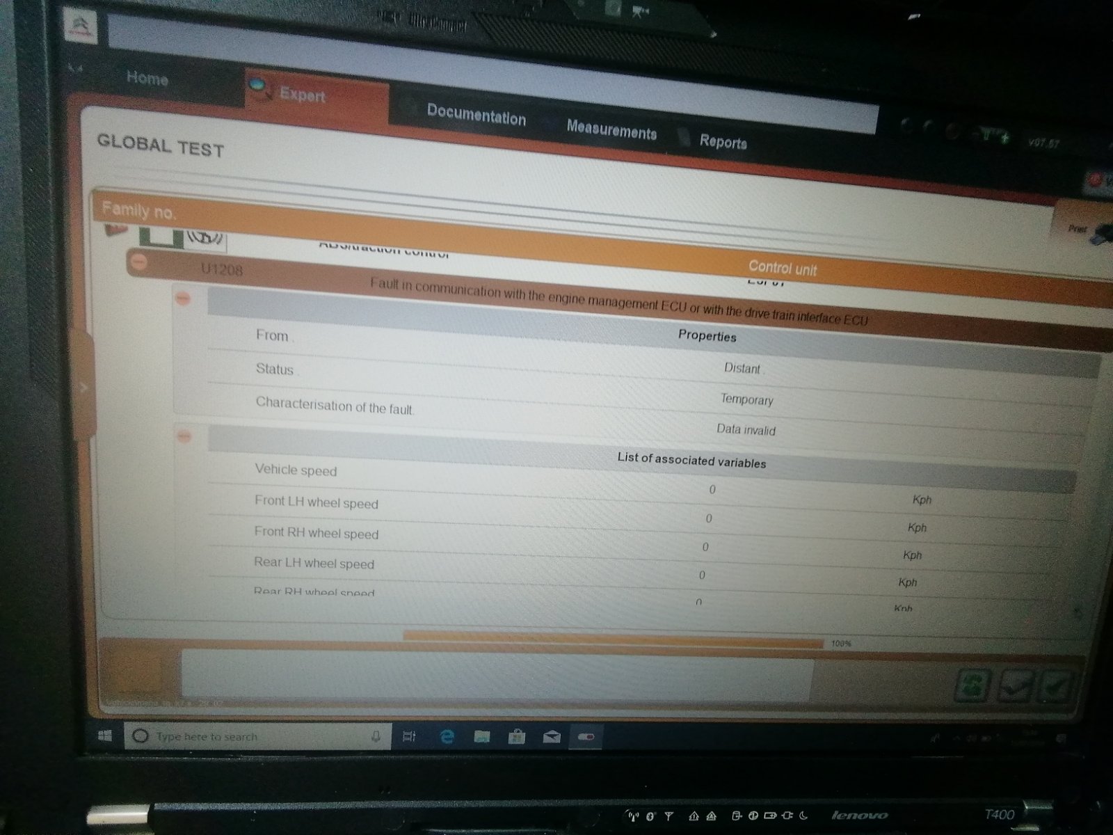

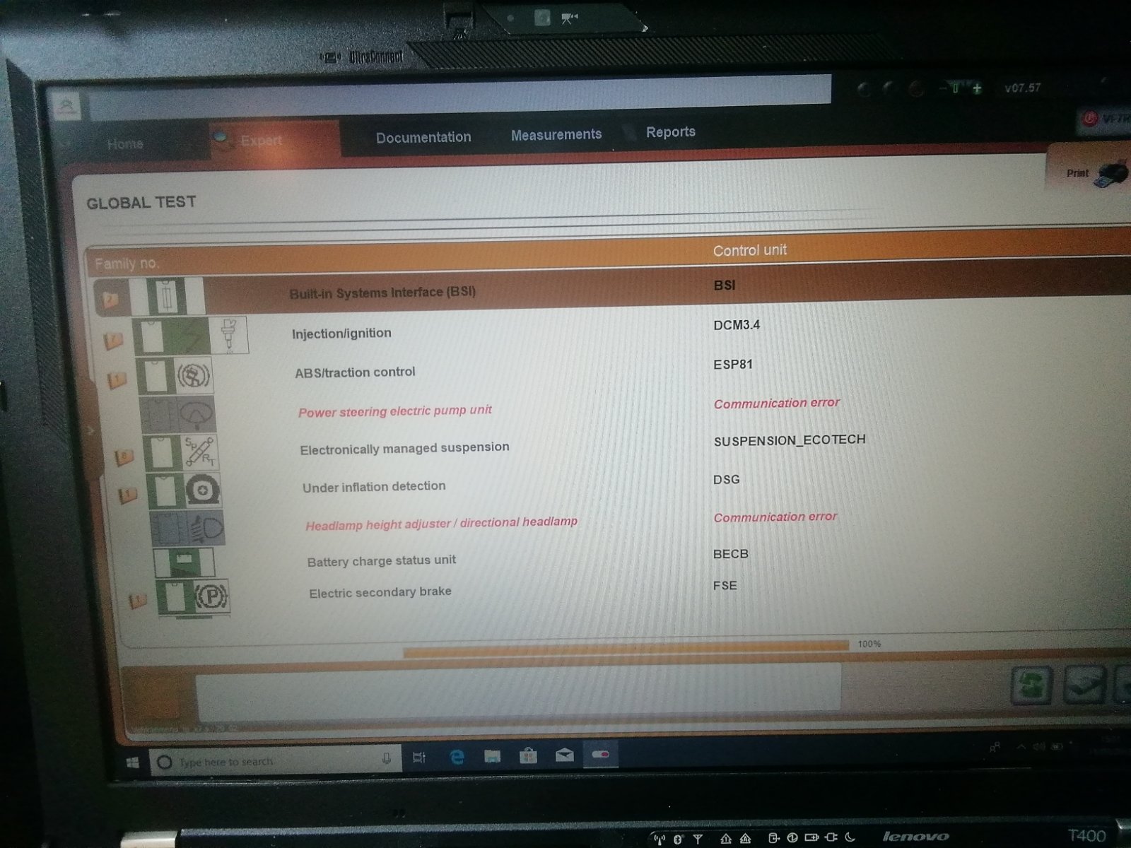

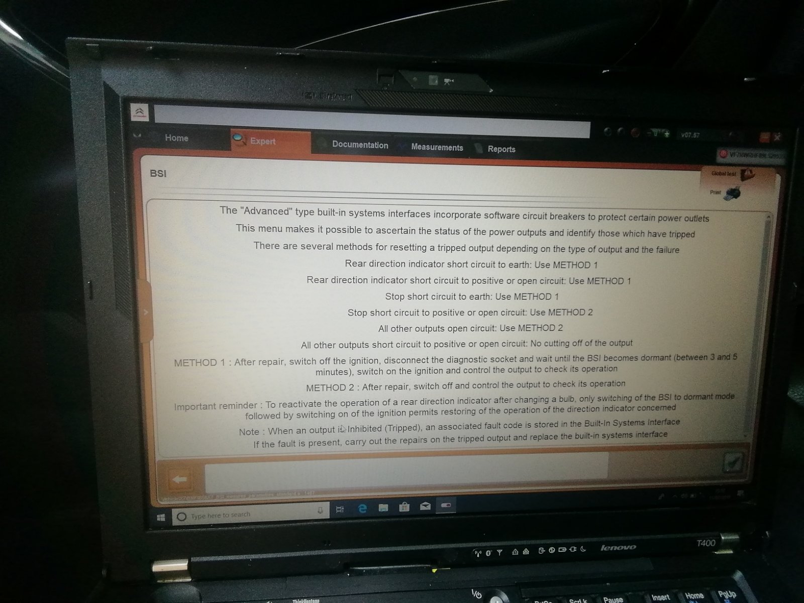

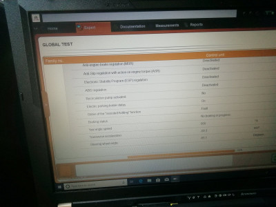

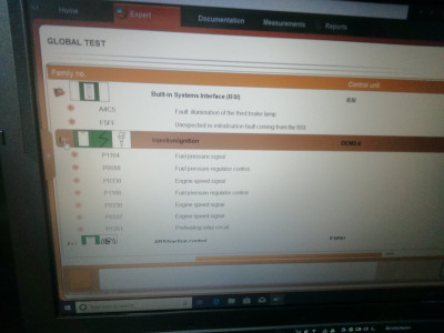

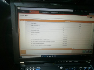

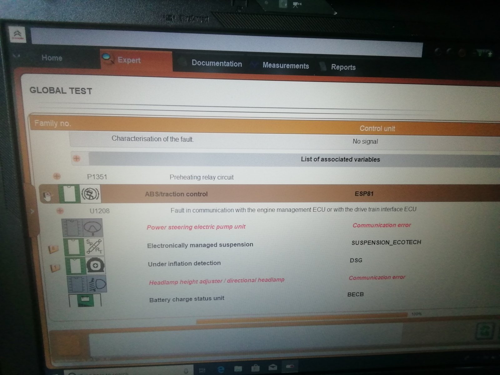

Hi,
Software and PC arrived today finally. Installed DiagBox 7.57 OK.
Ran diagnostics, faults all in top section. Mainly BSI engine speed sensor, then suspension (which I know about, and will ignore until engine starts).
The ESS connection block was the only harness I disconnected, my fault not disconnecting the battery beforehand.
However, I attach several photos in batches showing other errors.
The engine was running perfectly before work on cambelt etc, and all put back together properly; caveat, I don't know if I damaged the ESS connector or not.
I have owned the vehicle just 2 months, last 3 weeks it has been in hospital...
Rgds

There is no date on these error messages, so some could be before my time.
Shall I press.... 'Repair'?! :shock:
Rgds
AJM

Note all codes and descriptions then clear them and see if they return. As you say, old ones could be lurking.

That's a lot of fault codes - but a lot of them are related.
All the ESP functions will be disabled if there is a problem with engine speed - and suspension data you can ignore for the present at those errors can be returned when the suspension ECU is interrogated.
Your starting issue though may be simpler - I saw that it has recorded 2 remotes and the engine ECU is unlocked - but none of the remotes are synchronised! That will stop the engine from being authorised to start. Here's the procedure:

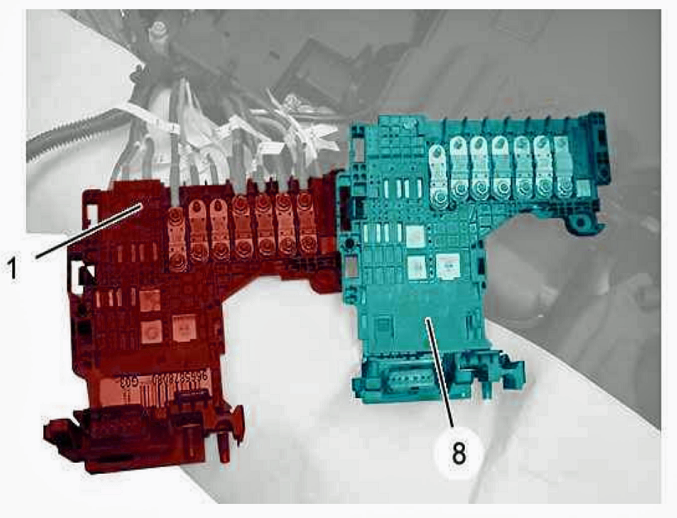

I'm looking through some of those faults and the shear quantity of them - coupled with the communication errors is making me very suspicious that of the engine fuse box / but especially the Maxi Fuse part. The Maxi fuses provide supply to parts of the engine fuse box and the BSI.
During manhandling it is possible a short may of occurred, or the unit has been damaged. I would strongly suggest you remove the battery and inspect both the engine fusebox, all fuses and especially the maxi fuse box.
I know that a C6 owner had a multitude of faults and communications errors (too many different systems, and all at once). He replaced the Maxi fuse part and it got rid of the errors. They suspected that it had been upset and a short had occurred / damaging the unit - probably as so often happens the battery had not been removed before the work was being done.
x 6954
Re: C5 X7 Multiple Electrical Systems Faults After Cambelt Change
This is what the Maxi Fuses are allocated to (not all options relate to your X7 - i.e. DT17 engine where marked and the additional suspension computer).
But there is a link here to your faults in the Power Steering, the ESP System (and associated faults), and the BSI supplies which may be resulting in the BSI errors and tail light fault for example. The BFH12 and BFH5 are the supplies to the cabin fuse boxes.
So I think that this is a prime suspect given the magnitude of system faults. It will certainly be worthy of investigation to see if there is an obvious damage or if any of the fuses have blown.
If there is a supplies problem, then it will of course affect the ability of the vehicle's systems to start the car. If the Fobs are synchronised and we know from the data that the engine ECU is not locked - then all those rail fuel pressure errors and such are possibly because there is no power to those systems.

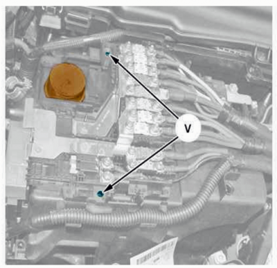

I'll put up a guide to getting access to the supplies box shortly....
x 6954

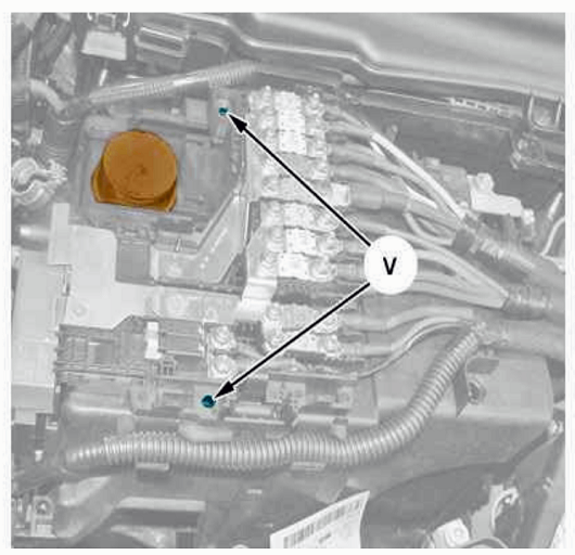

I've put this guide up here for getting to and potentially replacing / refitting the Maxi Fuse Box Unit (Supplies Protection & Management Unit) on the DW10BTED4 C5 X7.
Location
(1) Supplies protection and management unit.
The supply protection and management control unit (1)
is located on top of the battery.
Note: The supplies protection and management unit (1)
cuts the power supply to make the vehicle
safe in the event of a short-circuit.
Removing
Place a protector on the following elements:
  • Front LH wing
  • Left-hand front headlamp
  • Front grille
Disconnect the ancillaries battery
positive cable (at "a").
Remove:
  • The air intake ducts (according to equipment)
  • The air cleaner (according to equipment)
  • The cover (2)
Press (at "b") on the cover (3) of the fuse box.
Lift the engine fusebox cover (3) (towards the top).
Remove the cover of the fuse box (3).

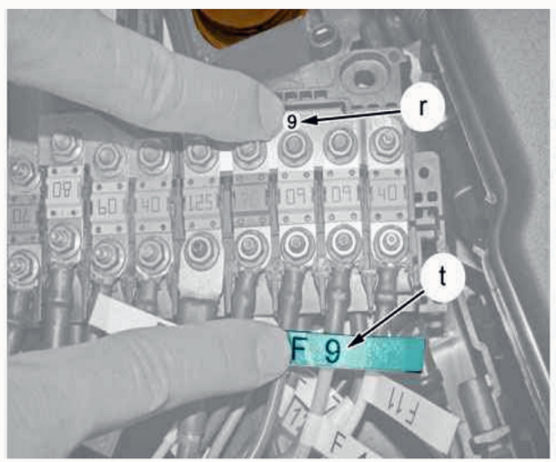

Fuse Reference
CAUTION: Identify and label each electrical wire with
the corresponding fuse identification before disconnecting the supplies protection and management unit (Vehicle breakdown (or potential risk))
Note: The number of fuses and wires varies according to the vehicle’s equipment
Identification of the fuses (Lower panel):
  • "m" Identification of the fuses on the supply protection and management unit
  • "n" Identification of the fuses on the cover of the fuse box (5)
Identify the electric wires (at "p") in relation to the identified fuses (at "m", "n").
Label the wires with the identification of the corresponding fuse (at "q") using some adhesive paper tape.
Note: Before removing the nuts (6), ensure that the labels (at "q") match the identifications (at "m", "n").
Identification of the fuses (Upper face):
  • "r" Identification of the fuses on the supply protection and management unit
  • "s" Identification of the fuses on the cover of the fuse box (3)
Label the wires with the identification of the corresponding fuse (at "t") using some adhesive paper tape.
Note : Before removing the nuts (7), ensure that
the labels (at "q") match the identifications (at "r", "s").

Remove the insulating plug (at "c").
Refit:
  • The cover of the fuse holder unit (3)
  • The cover (2)
CAUTION: If there is damage, secure
the supply protection and management unit (1)
on the ancillaries battery tray: Using the 2 screws (at "v").
CAUTION: Perform the operations that are required following
a reconnection of the ancillaries battery.
Reconnect the Battery (following the battery disconnect / reconnect procedure
AJM C5
(Donor 2019)
Posts: 69
Joined: 28 Jun 2019, 15:32
x 10
Unread post by AJM C5 »
Geronimo!
Ran the Diagbox after doing key sync, rolled left trouser leg up, ran three times around the car backwards humming the French national anthem, cleared all faults, removed RH wheel and disconnected the Engine Speed Sensor, reconnected, cleared fault again, hummed the National anthem again while turning the ignition and she Started! Runs beautifully. Turned ignition off, restarted, runs beautifully! Left it for 15 minutes, had a cup of tea and a cigar, turned ignition, started beautifully, windows work, everything works on that front now, so a big thank you to you!
Tried to Donate, it failed twice with several retries, will do again shortly!
Syphoned off 2.5 litres of LDS and refilled to solve the remaining problem of rear self levelling.... But that's another thread!
Thank you so much Marc for your wonderful advice and mega efforts, it is greatly appreciated.
Can we talk about the Moon Landings again now please, that was surely the second best achievement of mankind after starting my C5 🤔😀😂
x 6954
Excellent - just keep an eye on things for a bit - I'm pleased it wasn't any of the fuse boxes in the end.
AJM C5 wrote: 12 Jul 2019, 17:56 Can we talk about the Moon Landings again now please, that was surely the second best achievement of mankind after starting my C5 🤔😀😂
That reminds me I need to unlock that topic now... cooling off period has timed out.
