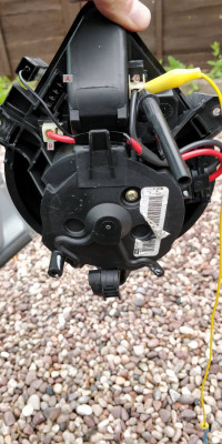

I have just dropped the fan and performed the results from the multimeter test are on the photo below.
I'm not sure which wire should be providing the power to the blower, I would have thought it was the red cable but the results show it is the thin orange cable.
Does this mean the blower gets power and therefore the ignition switch cable is ok?
Thanks
Mike
Thanks
Mike

I think the cable in my photo (orange, black, yellow, red wires) is the cable going into 8045.
I'm not sure if there is anything else to test if the results above show that 12v is going to the motor.

Re: Citroen Xsara - Heater Blower NOT WORKING
Hi Marc,
Thanks for your time and patience.
I think the fundamental test is to determine if the fan motor works.
The 4 pin plug in my photo above shows (Orange, Black, Yellow, and Red). If I run a cable from the battery to the motor, battery positive to Red (4) and battery negative to Black (2), the motor should kick in? As the above circuit removes the switches etc will this work? The moto tests on youtube have 2 pins and not 4?
Thanks again
Mike
Thanks again
Mike
Test 2 results.
i have ran a cable form the battery and connectd it to the two relelvant pins at location A - nothing happened.
I connected the cable form the battery to the two pins at location B and C - the fan kicked in and only stopped when I removed the live feed. I connected the live feed again but nothing happened.
As this removes the switched and the ignition cable could the fan be faulty? Should the fan operate when pins at location B and C are connected?
