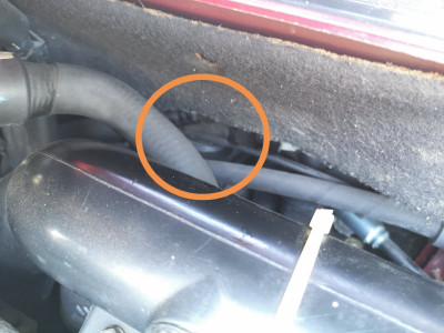

Tiny clutch reservoir NOT LHM (with black rubber push fit cover) is almost hidden in rear of engine compartment, on the upper bulkhead just underneath bonnet seal in front of driver's area ....

Man I feel an idiot never having spotted that.
Just had a look at a couple of my old photos and reckon I've spotted it.
I never gave that thing a second glance... I'd always thought that was the inertia switch!
You'd really not think I'd been messing around with cars for more than 30 years would you...

I think that on RHD Xantias, The clutch reservior is better hidden than that!
Late LHD xantias (1999 I think) did get a remote reservior under the bonnet.
The clutch reservior is just in front of the LHM tank:
