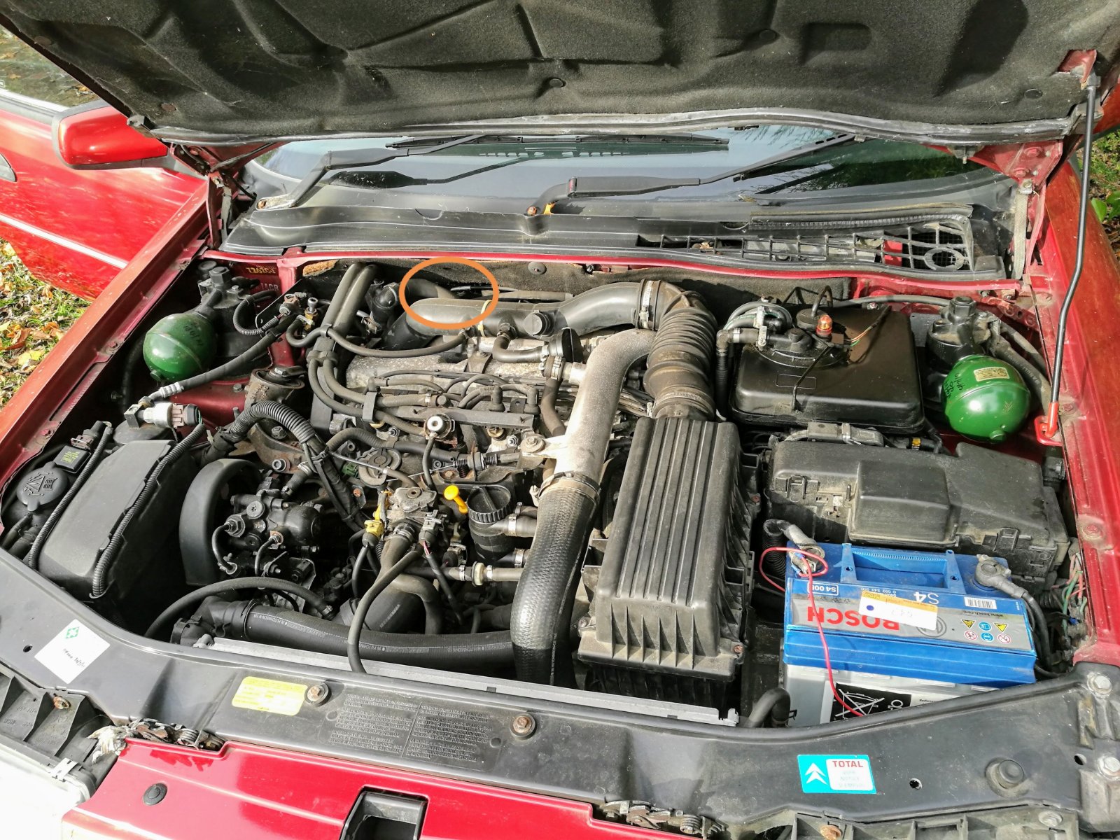

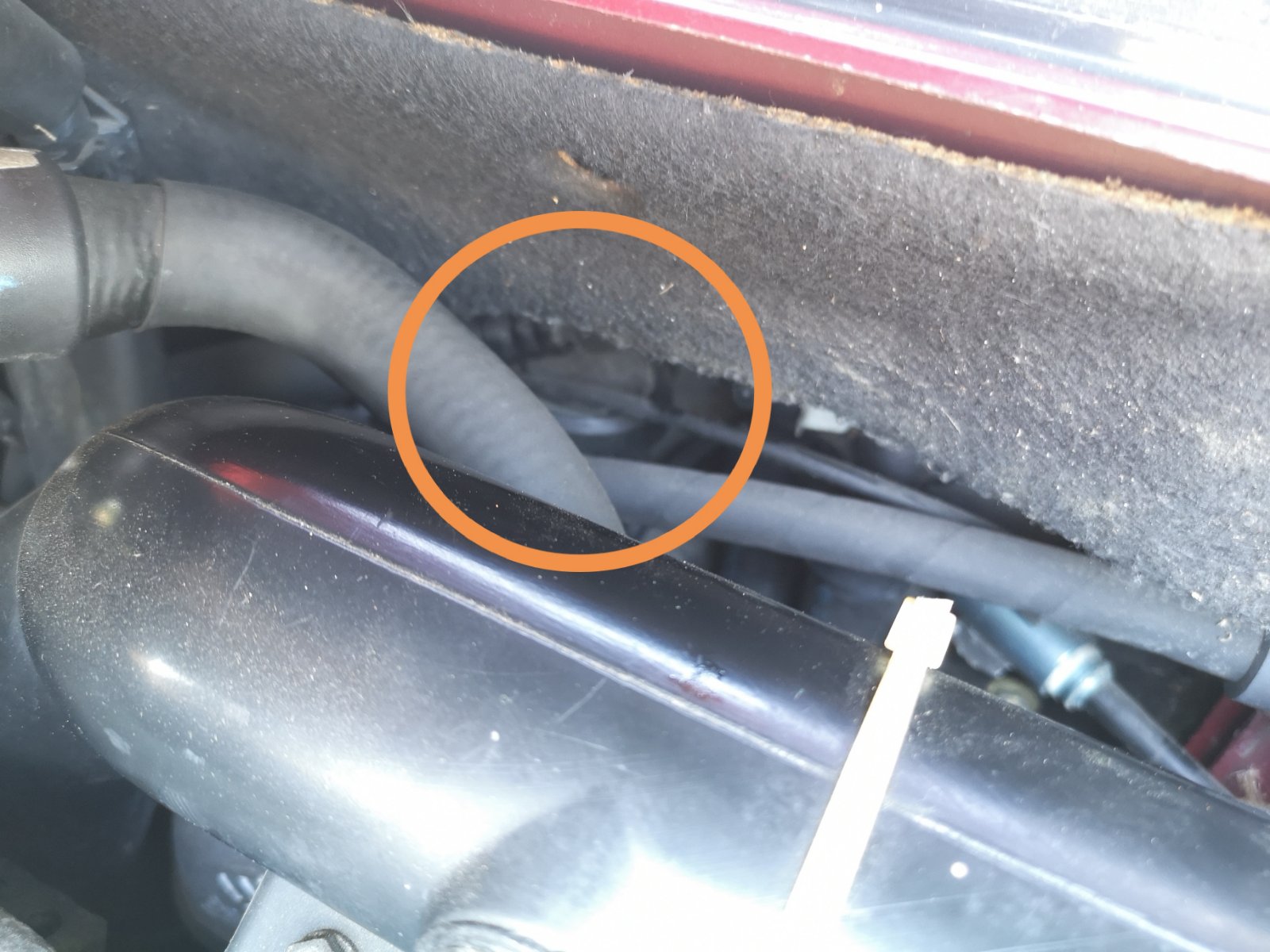

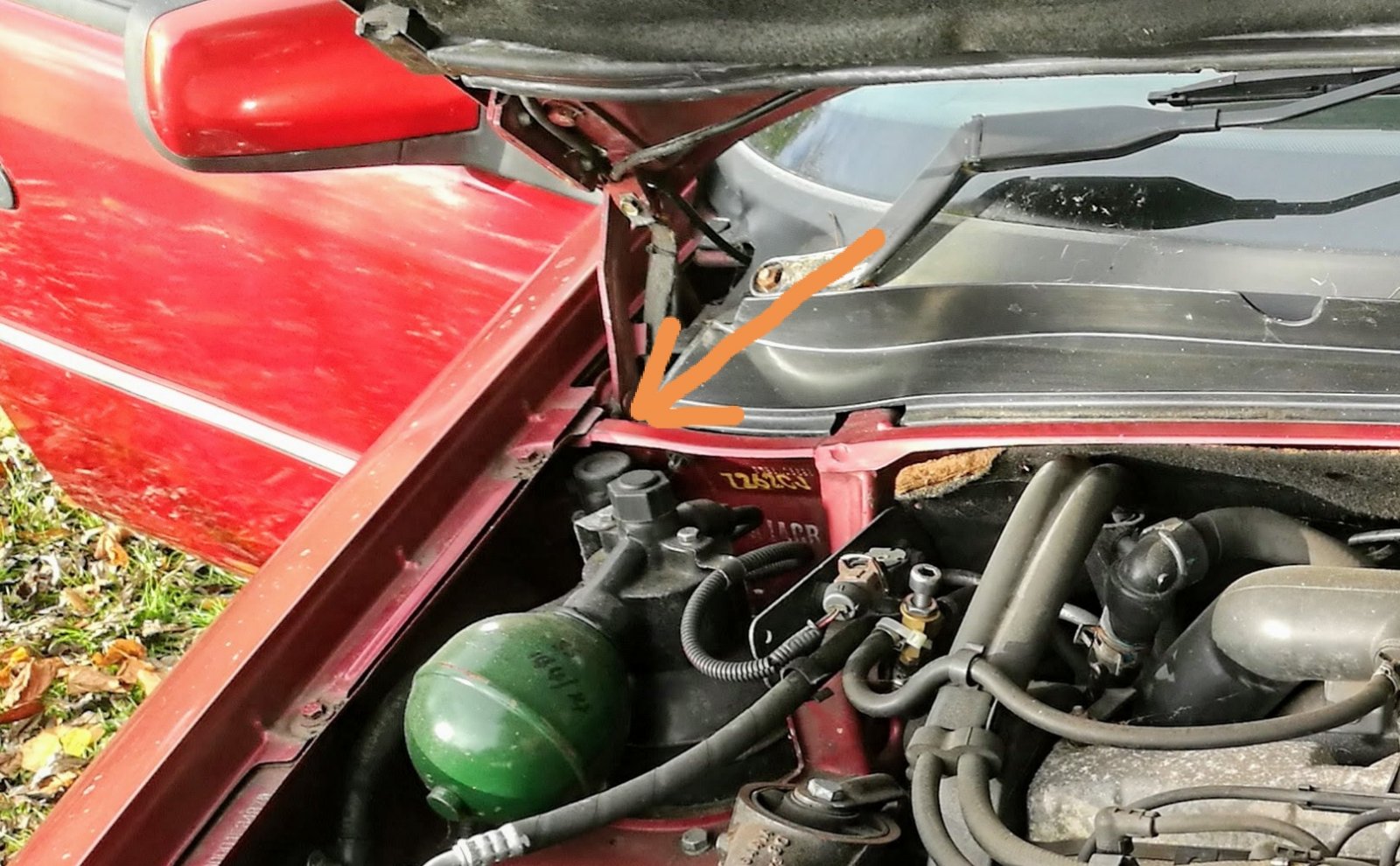

That's definitely the most ridiculously placed fluid reservoir I have ever seen.
Xantia Activa Clutch Fluid Reservoir Location.
Oh yes...lovely access
What were they smoking when they decided this was smart?!? If the pipework wasn't that odd plastic stuff and there was a total lack of bleeding provision, I'd almost be tempted to relocate if to somewhere more sensible.
Current fleet:
