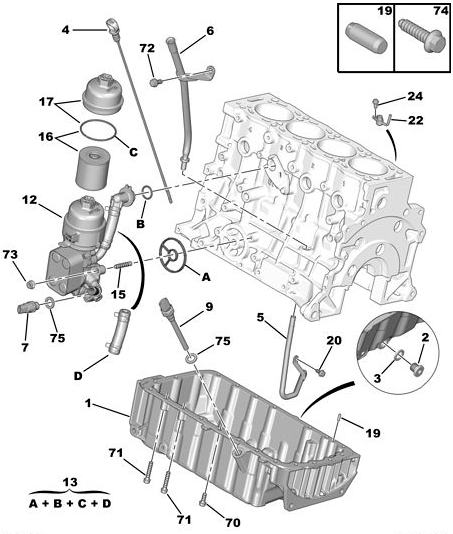

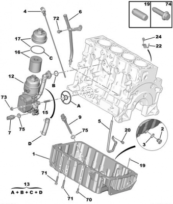

You have the DW10BTED4 138 engine..
This is a combined oil temperature and level sensor, item 9, part 1131G9, £76.88 inc. VAT from Citroen. You'll also need to replace the cooper seal (item 75), part: 698870, £0.41p inc. VAT. Access:

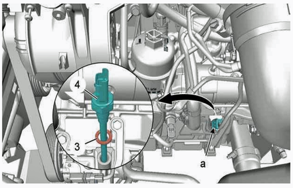

Disconnect the battery - follow the procedure here:
BSI Reset / Battery Disconnect / Reconnect Procedure
Remove:
| Disconnect the connector (at "a"). Remove:
CAUTION: Always replace the seal (3).
Fit:
- The seal (3) (new)
- The oil level sensor - The oil temperature (4); Tighten to 2,7 ± 0,2 daN.m
- Connect the connector (at "a").
- The air entry union (2)
- The clip (1)
Reconnect the battery following the remainder of procedure linked to in this post after you have completed the work.
