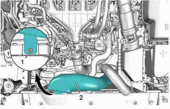

You have the DW10BTED4 138 engine..
This is a combined oil temperature and level sensor, item 9, part 1131G9, £76.88 inc. VAT from Citroen. You'll also need to replace the cooper seal (item 75), part: 698870, £0.41p inc. VAT. Access:
Disconnect the battery - follow the procedure here:
BSI Reset / Battery Disconnect / Reconnect Procedure
Refitting:
CAUTION: Always replace the seal (3).
Fit:
Reconnect the battery following the remainder of procedure linked to in this post after you have completed the work.
Remove:
| Disconnect the connector (at "a"). Remove:
Fit:
- The seal (3) (new)
- The oil level sensor - The oil temperature (4); Tighten to 2,7 ± 0,2 daN.m
- Connect the connector (at "a").
- The air entry union (2)
- The clip (1)

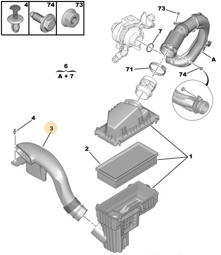

Re: C5 X7 2.0 Hdi Oil level sensor
It you are referring to the Air Intake Pipe below (item 3), it is part: 144058 and £54.34 inc. VAT.
It is only secured by a clip (4), so could fall out of the connecting pipe I guess - mine is held on with a cable tie!
I can concur that my lads C5 X7 2010 2.0 Hdi has 2 cable ties holding it in place
