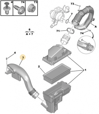

OK - I've just realised that the air entry pipe that you have to remove has gone missing.
I suspect the garage that replaced the cam belt forgot this part when they reassembled the engine.
I can't see how you can actually loose it when installed :shock:
Do you have part number and price for this, I need to have a discussion with them!

It you are referring to the Air Intake Pipe below (item 3), it is part: 144058 and £54.34 inc. VAT.
It is only secured by a clip (4), so could fall out of the connecting pipe I guess - mine is held on with a cable tie!

I can concur that my lads C5 X7 2010 2.0 Hdi has 2 cable ties holding it in place

A look through eBay found just one air inlet for my car, for the grand sum of 16 quid :-)
It's now been cleaned up, and looks like new, so if/when it very stops raining I'll fit with some extra cable ties for security :)
