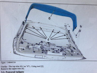

As it happens I sorted the rear washers out yesterday on my C5 Tourer. Although you are supposed to remove the 8 retaining clips with tool 7504-T, I managed to carefully pull off the top inner trim by hand without breaking any. As Lenny says though, probably better to have a few new clips to hand. Interesting that a repair kit is supplied by Citroen - what does it consist of? I had to sleeve a section of the plastic convoluted tubing which had started to split and leak enough to not let anything through to the washer jet.

The bottom inner trim pulls off after removing the four bolts under the covers along the bottom edge. Again - the clips may break as they are removed.

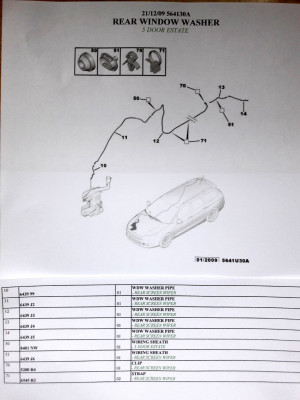

Thanks for the info, chaps, especially the diagram which shows where the clips are located.
The washer repair kit consists of about 10" or so of the convoluted pipe, with a straight push-in connector which mates with a connector above the headlining, a new sealing grommet assembly, and a right-angled push-in connector at the other end which mates with the final connection to the washer jet (this is the bit that requires the spoiler to be removed for access). Ironically, the final 3" or so of pipe connecting to the washer jet is the normal rubber washer pipe, so why this wasn't used for the external connection, instead of the convoluted stuff that breaks, is beyond me.

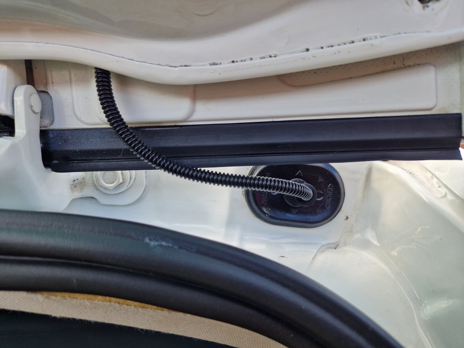

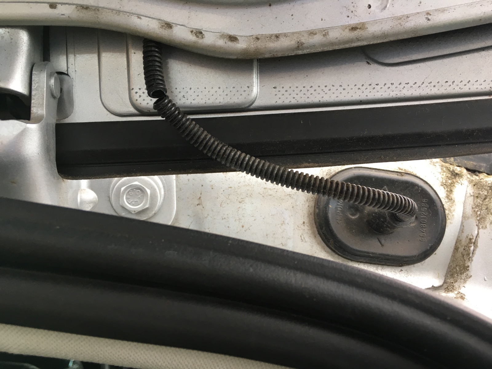

I have a broken supply pipe which is visisble at the hinge when the tailgate is open.
I am hoping if I separate the broken bit into two parts I can just buy a sleeve to rejoin them.
Is there a recommended method or part?

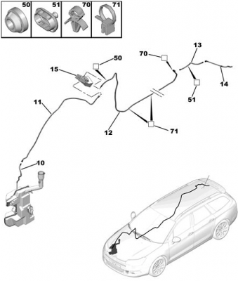

Ok, so the rear washer piping:
Parts 13 or 14 would seem to be the ones:
6439J4 (13) £14.29 inc. VAT from Citroen
6439J5 (14) £12.79 inc. VAT from Citroen
I wouldn't bother trying to repair it - the pressure and water will probably make any repair temporary at best and runs the risk of leaking water down into the tailgate area where you have a LOT of electrical stuff.

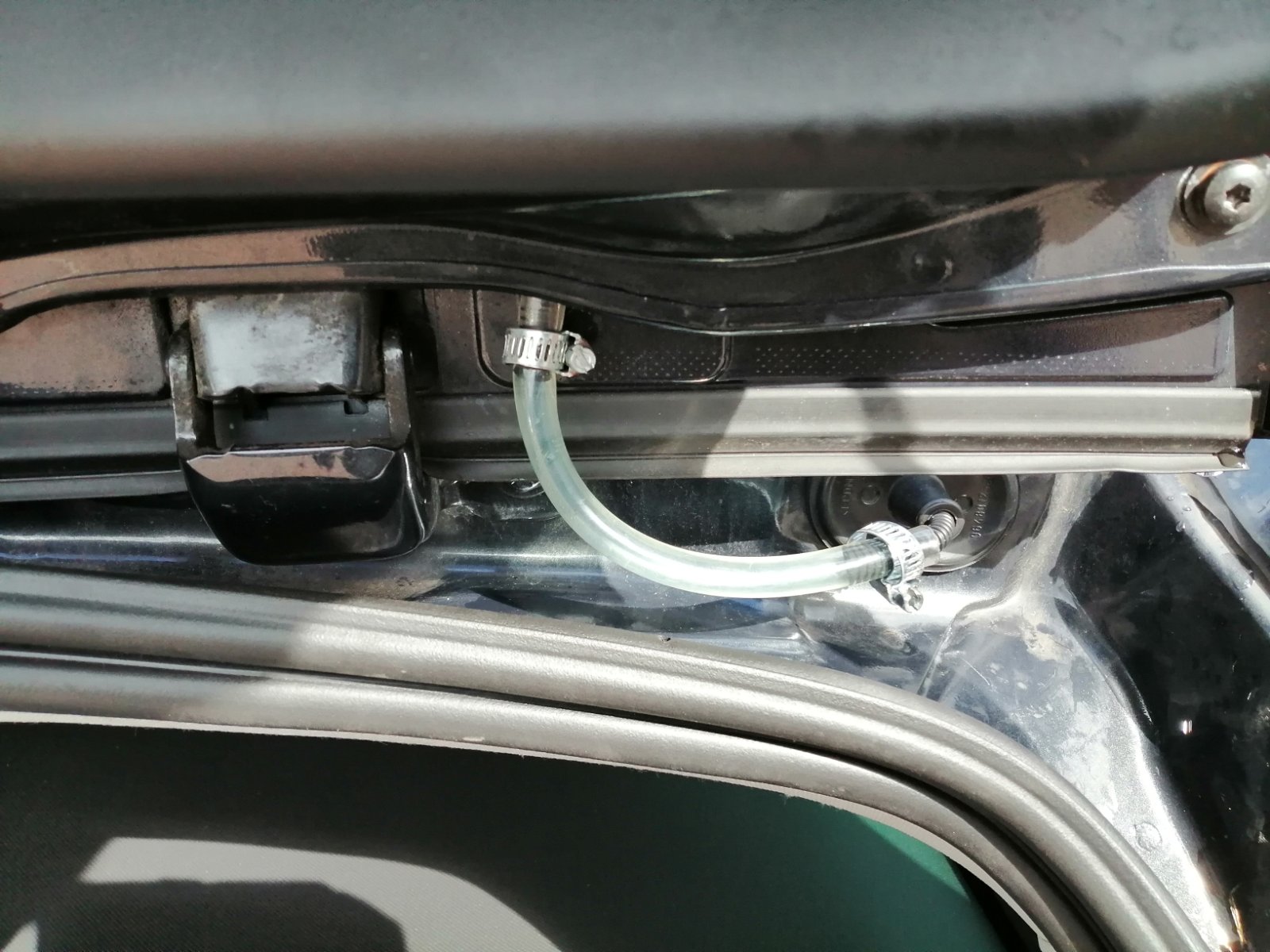

Re: C5 X7 Tourer Tailgate Trim
Won't it be pushing water into the tailgate anyway? May be because its at the hinge it gets away without getting into the tail gate. I thought I might try some heatshrink. As you say it could be more trouble than it is worth. By the way that is an amazing route that the pipe runs!

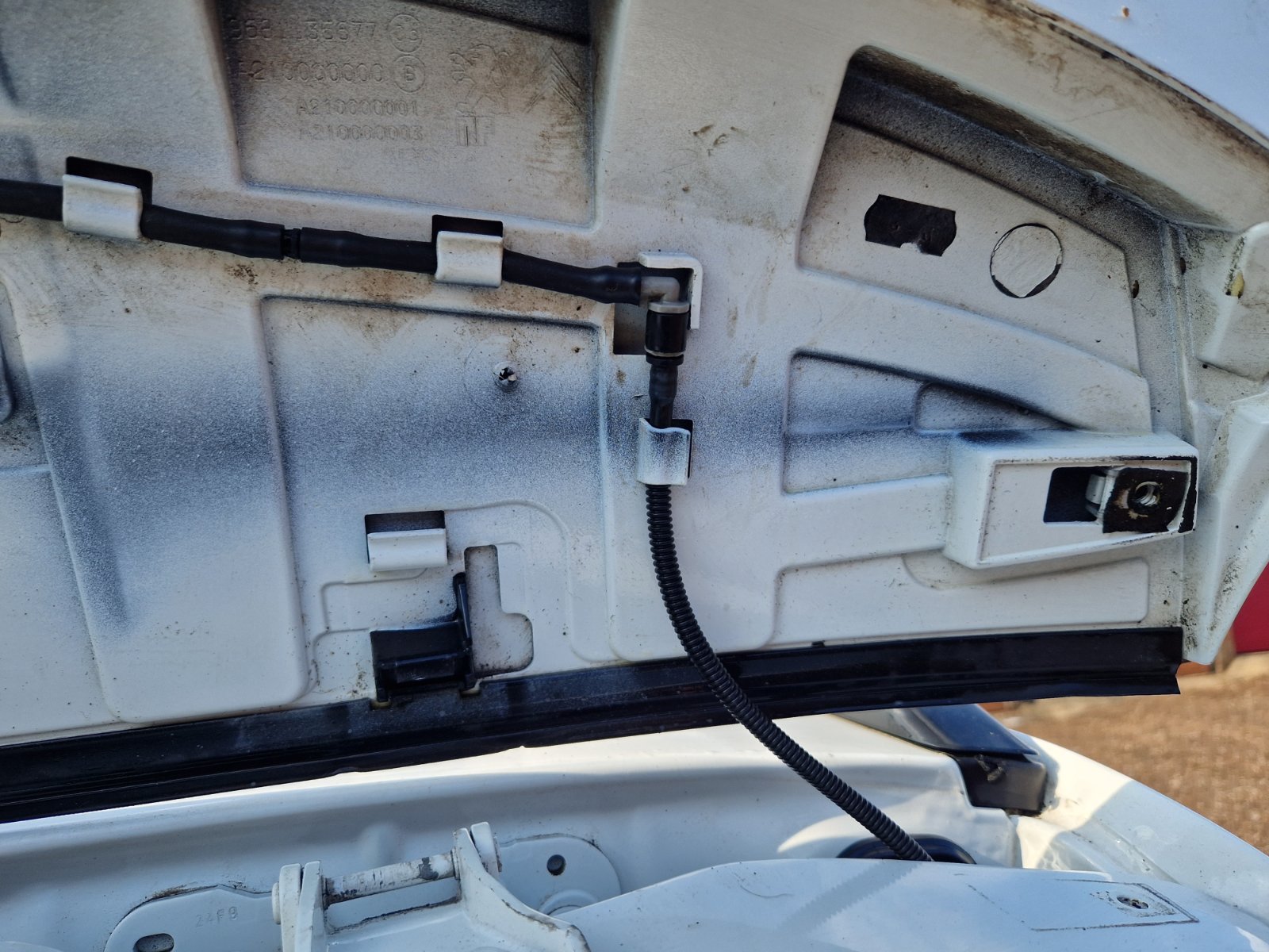

fixed for now ..what a daft plastic tube to have on that every time i tucked it
it broke so now this fix will do..o and it was the brake light i was looking at not this
but then it broke.as for the stop light on the spoiler it needs new light! not working
now but i have checked the power and its good. put the light to 12v battery nothing
so light is dead will order new one.

mypinknee
- (Donor 2021)
- Posts: 43
- Joined: 15 Apr 2019, 08:44
- x 11
How accessible is the pipe from the point where you see it at the top of the boot door forwards to the front of the car? Do you have to undo loads of stuff or will it pull through from somewhere convenient?
