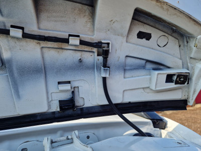

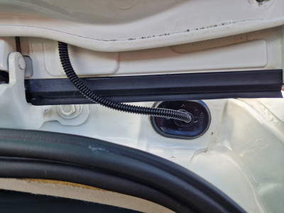

I have a broken supply pipe which is visisble at the hinge when the tailgate is open.
I am hoping if I separate the broken bit into two parts I can just buy a sleeve to rejoin them.
Is there a recommended method or part?

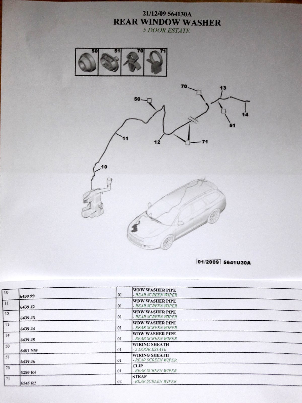

I assumed by 'feed' you were talking about the electrical harness at the top.
Ok, so the rear washer piping:
Parts 13 or 14 would seem to be the ones:
6439J4 (13) £14.29 inc. VAT from Citroen
6439J5 (14) £12.79 inc. VAT from Citroen
I wouldn't bother trying to repair it - the pressure and water will probably make any repair temporary at best and runs the risk of leaking water down into the tailgate area where you have a LOT of electrical stuff.
