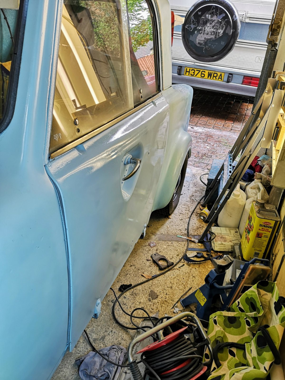

Aside from the scruffy corners, one thing which has been really obviously detracting from the bodywork on the Invacar is the fact that the doors are a totally different colour to the rest of the body.
Today I threw a bit of paint at the nearside one to see if I could do anything to improve it.
Mostly has taken really well, just one area directly above the door handle where something has reacted with the paint. So I'll need to get that area rubbed back and repainted before getting things ready for another coat.
Definitely looks better than it did I think.

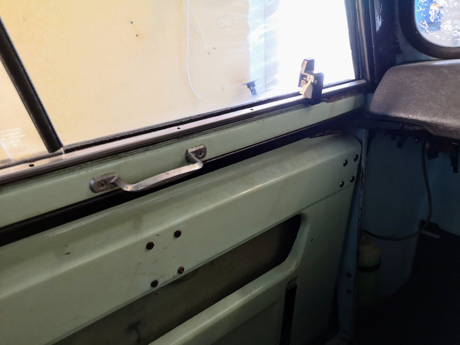

I've also????? made a personal choice with regards to interior decor. The inside of the door upper runner and the pre?viously flaky windscreen? pillar trims have also been painted bla?ck. ?
No, it's not factory???? spec...but it's entirely reversible with naught but a paint brush, and it's my car. I think it looks better like? this as it ties several parts of the interior together visually. Yes I'll touch in the little patch between the windscreen an dash top once I have a smaller brush to hand. Didn't want to get paint on the dashboard as it would be a pig to remove it from that finish. ?
Personally I think having a bit of detailing br?e??aking up what was otherwise an unending sea of solid blue is an improvement.
