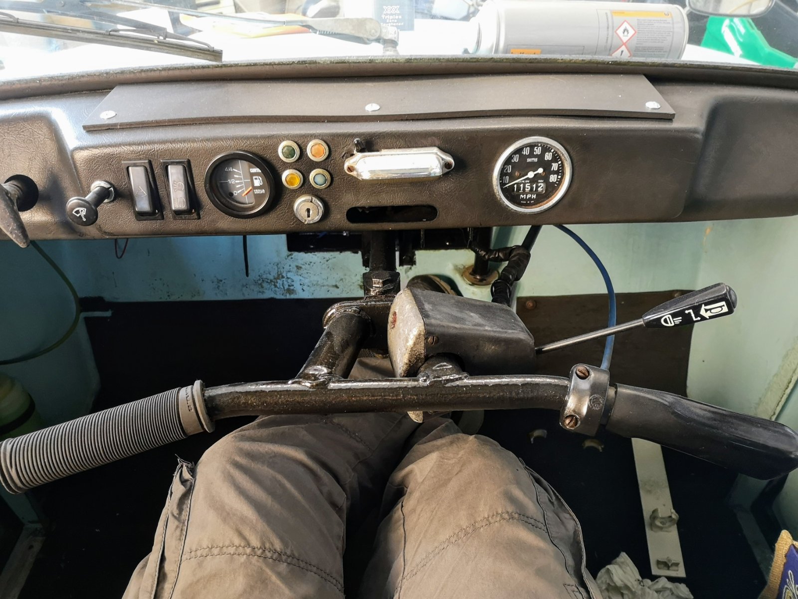

Running? around like a headless chicken all day today so nothing much to report...only thing I did was finally get around to mutilat?ing a set of floor mats for the cab of the van. Suffice to say none of the generic ones ever fit because the footwells of the van are way different in shape to those in a car.

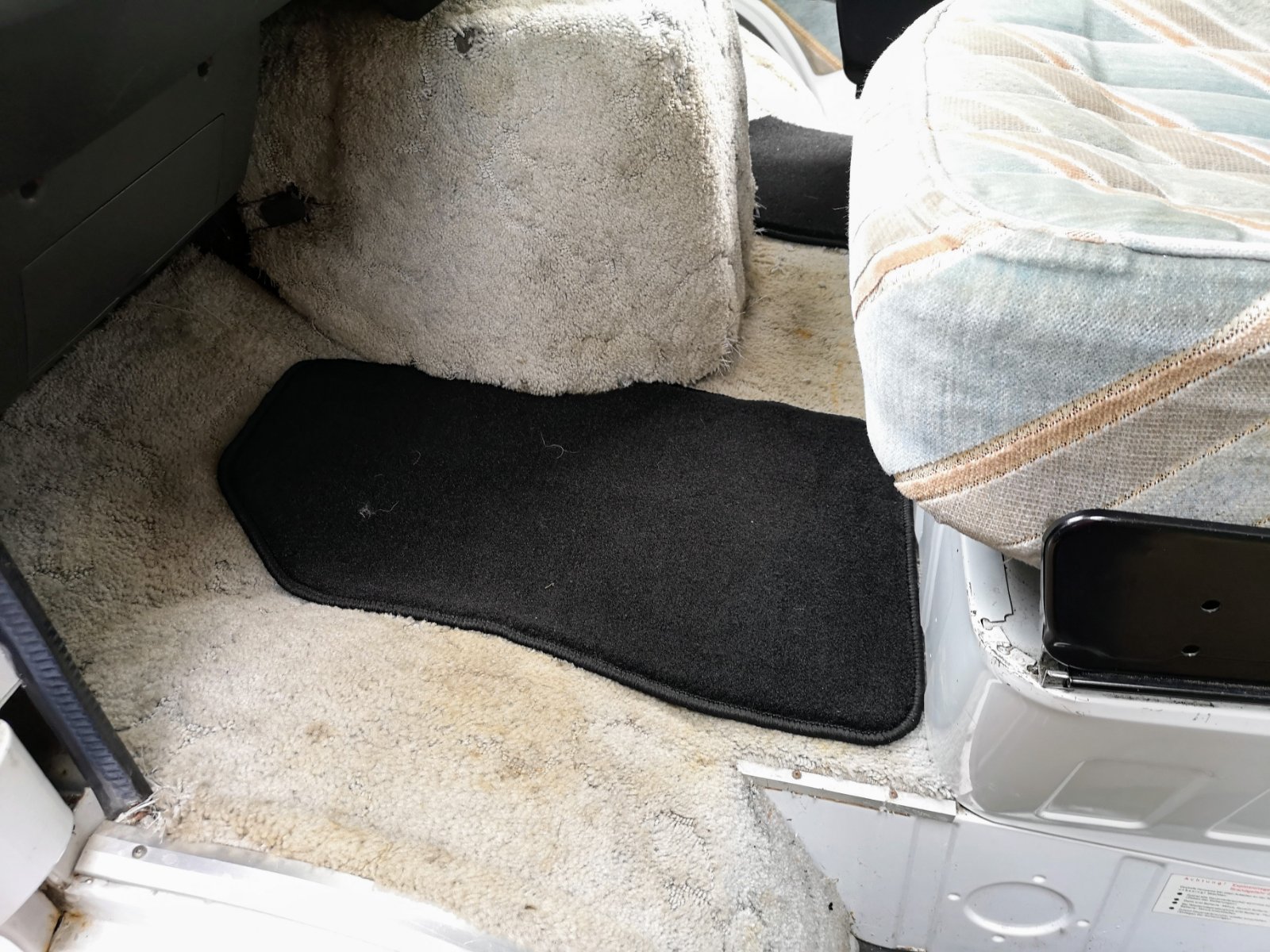

Nearside one is relatively simpl?e?, just needs a little chunk removed for the space taken up by the engine cover. ?
Offside one requires rather more hackery. Two reasons. Firstly is that the engine cover is not actually central in the cab - it's a good couple of inches nearer???? to the offside of the van. Secondly is that this van has a floor mounted throttle pedal with a huge heel rest, so you need to cut a slot out for it to sit in?. ?
The cab will be getting new carpet at some point (yes, in something more sensible than the factory beige shag pile), so I really wanted some mats in???? there before that happened so as to keep things clean. Oh, and I had been repeatedly knocking this set of mats over in the garage for months and I wanted them out the way. ?
Hopefully will get some actual garage time tomorro?w so will have something more worthwhile to report on. ?

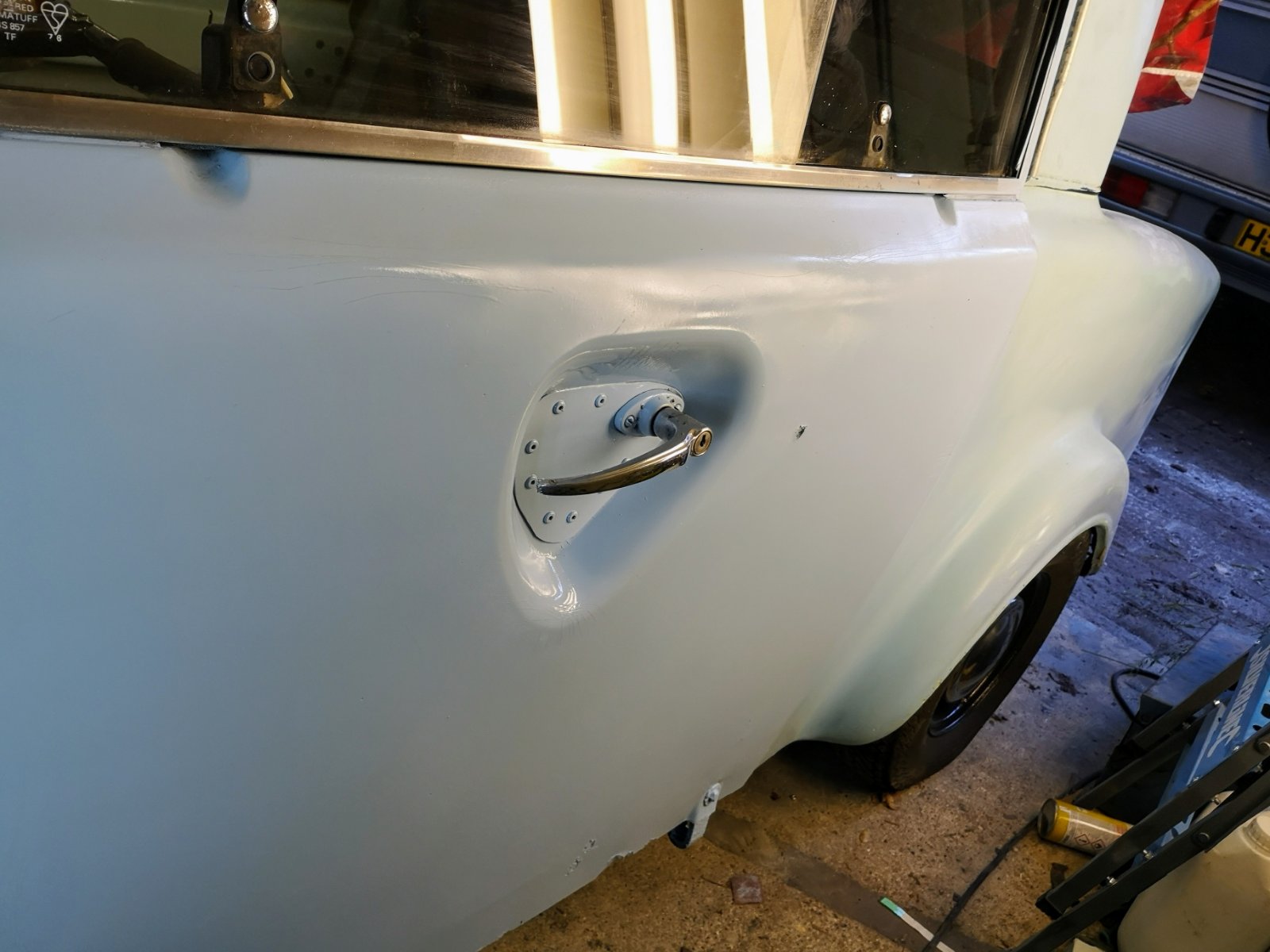

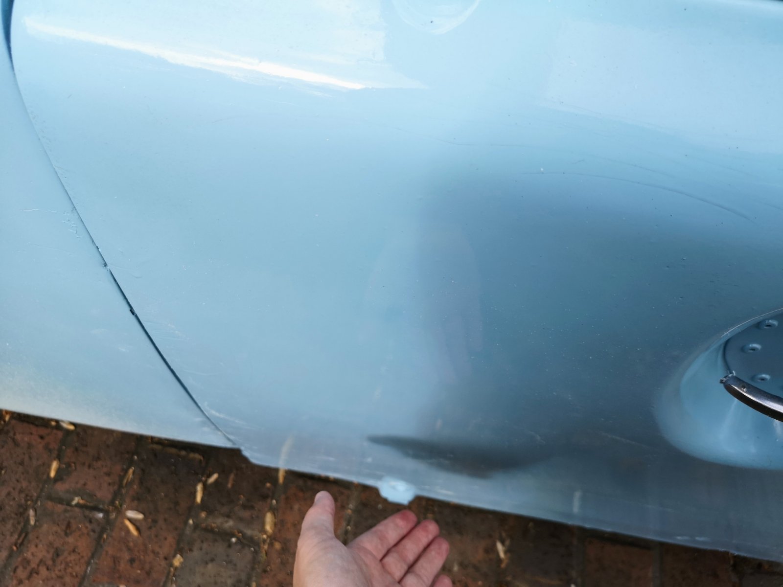

Aside from the scruffy corners, one thing which has been really obviously detracting from the bodywork on the Invacar is the fact that the doors are a totally different colour to the rest of the body.
Today I threw a bit of paint at the nearside one to see if I could do anything to improve it.
Mostly has taken really well, just one area directly above the door handle where something has reacted with the paint. So I'll need to get that area rubbed back and repainted before getting things ready for another coat.
Definitely looks better than it did I think.

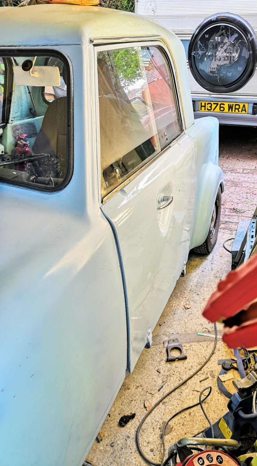

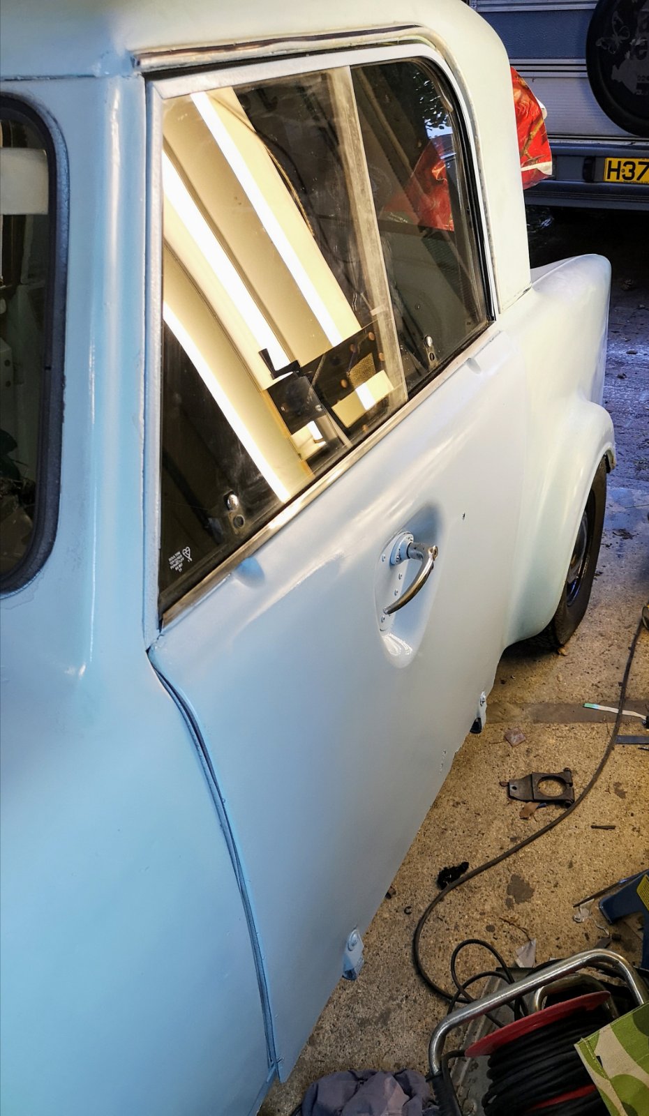

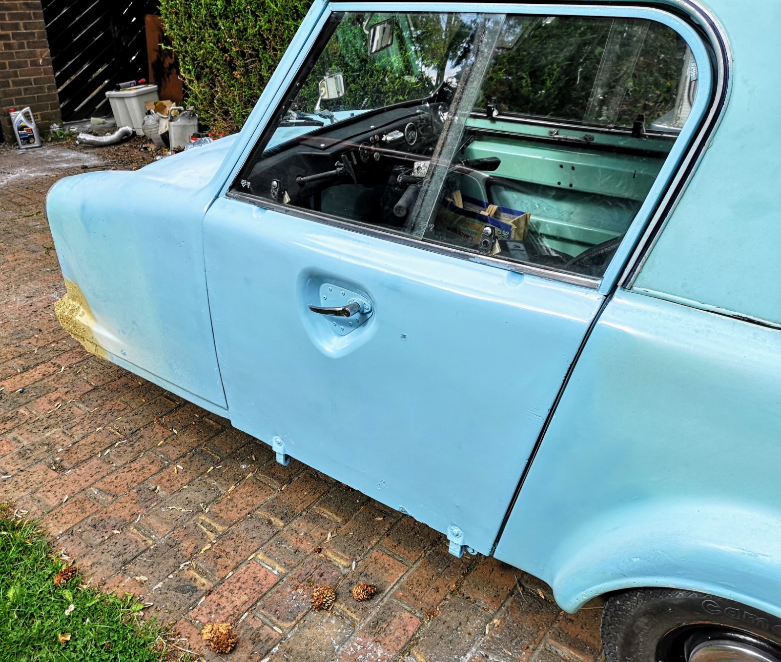

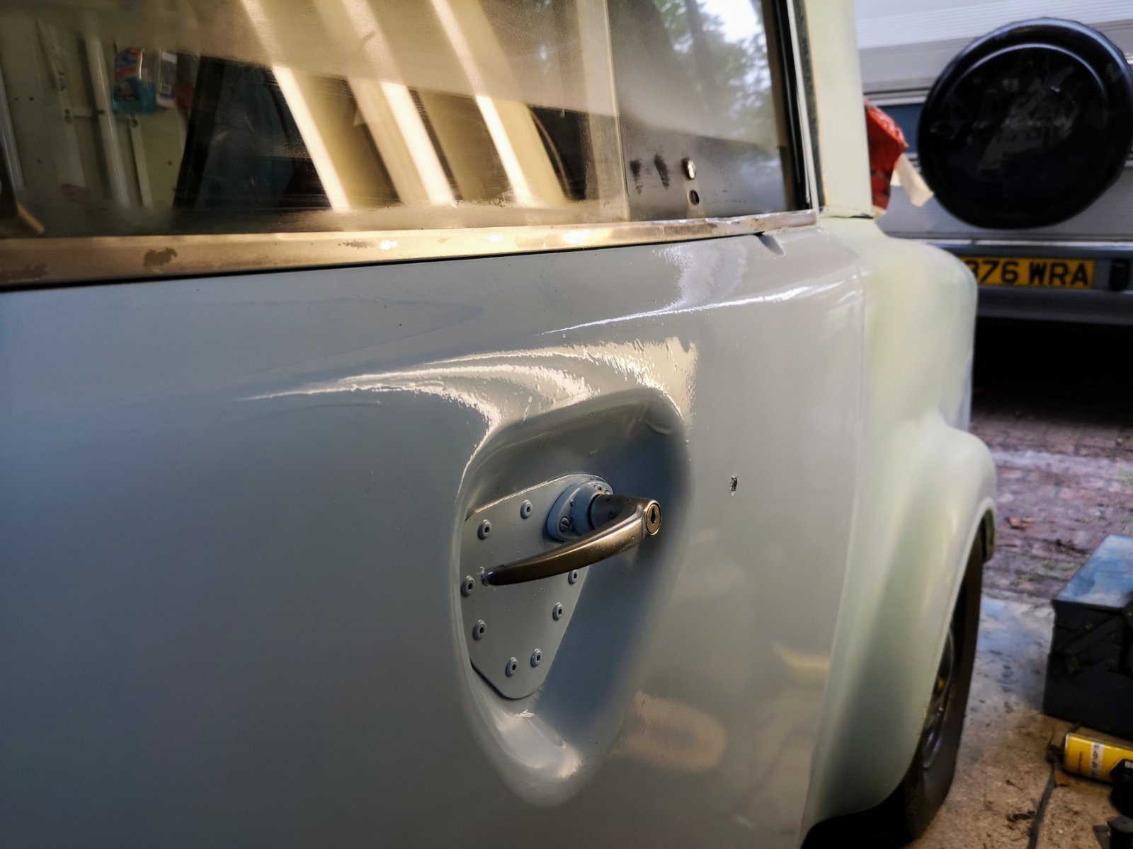

Got everything??? wiped down today and have given it another few coats. Looking reasonable I think given what I'm working with.
Still needs??? anot?her couple of coats I think, as the finish is a bit patchy yet, but we're getting there. It's forever since I've painted a larger panel so I've been playing the how-do-get-an-even-finish game. Especially in my cramped garage where I'm working in my own shadow the whole time. ?
? I may well just take the door off and outside to do the final coat or two.? If th?is hadn't landed on top of us when I was doing the work today I'd maybe have done so today. ?
Yes, the?? resulting rain was precisely as heavy as it looked like it would be.
Have done another bit of tidying. Handlebars are no lon?ger rusty and as rough a?s sandpap?er.?
I've also????? made a personal choice with regards to interior decor. The inside of the door upper runner and the pre?viously flaky windscreen? pillar trims have also been painted bla?ck. ?
No, it's not factory???? spec...but it's entirely reversible with naught but a paint brush, and it's my car. I think it looks better like? this as it ties several parts of the interior together visually. Yes I'll touch in the little patch between the windscreen an dash top once I have a smaller brush to hand. Didn't want to get paint on the dashboard as it would be a pig to remove it from that finish. ?
Personally I think having a bit of detailing br?e??aking up what was otherwise an unending sea of solid blue is an improvement.

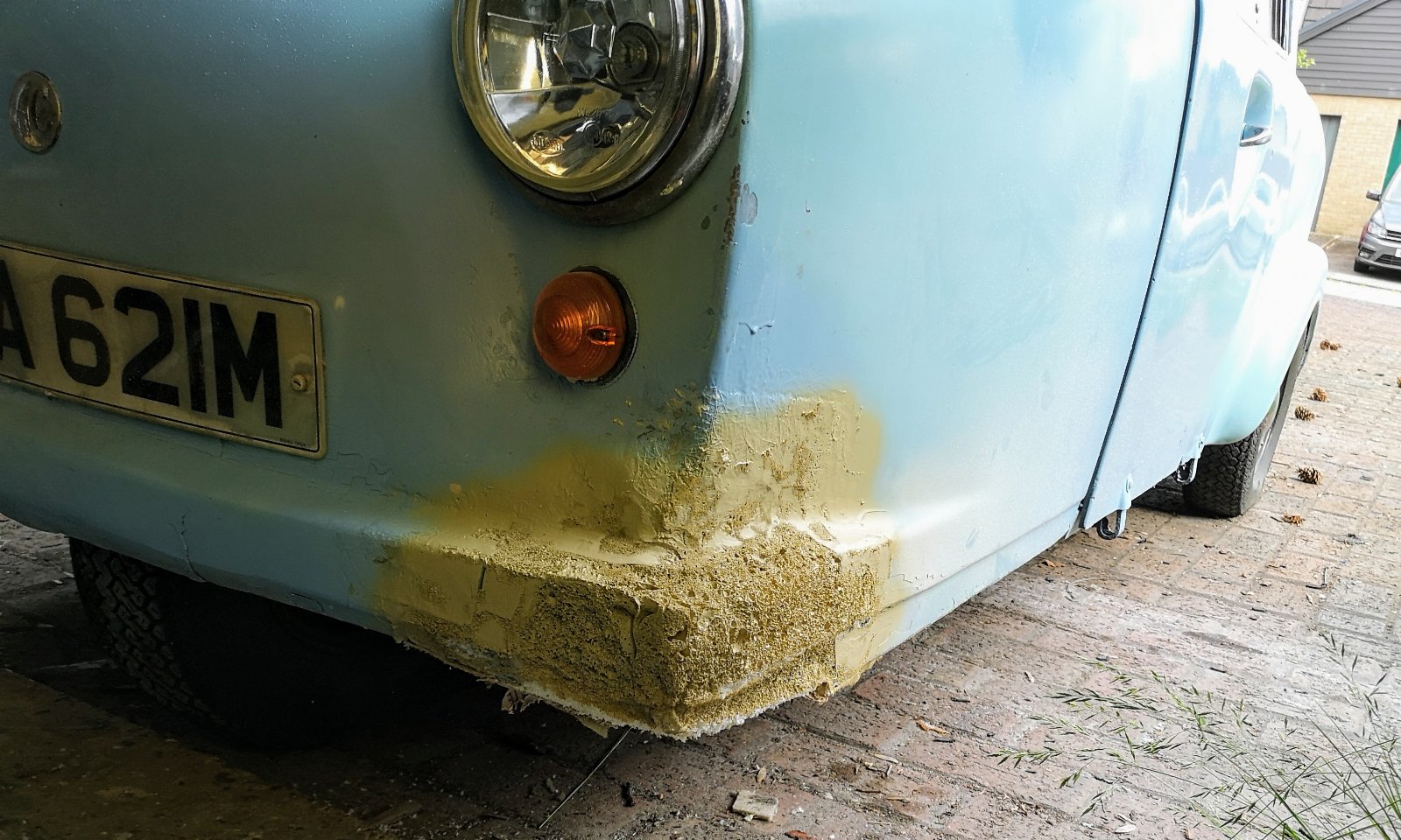

Now we're cooking with bacon (as my late father would have said).
I'm actually really happy with the finish I'm getting here. The original finish on these cars was laughable to be honest - I've seen kid's toys better finished. With a bit of flatting back this should be just fine. If I can manage to get this level of finish on the car as a whole I'll be a very happy camper. Annoyingly I got slightly too heavy handed right at the end and wound up with a couple of minor runs...even so I'm not too worried, runs and all it's still a million times better than it was.

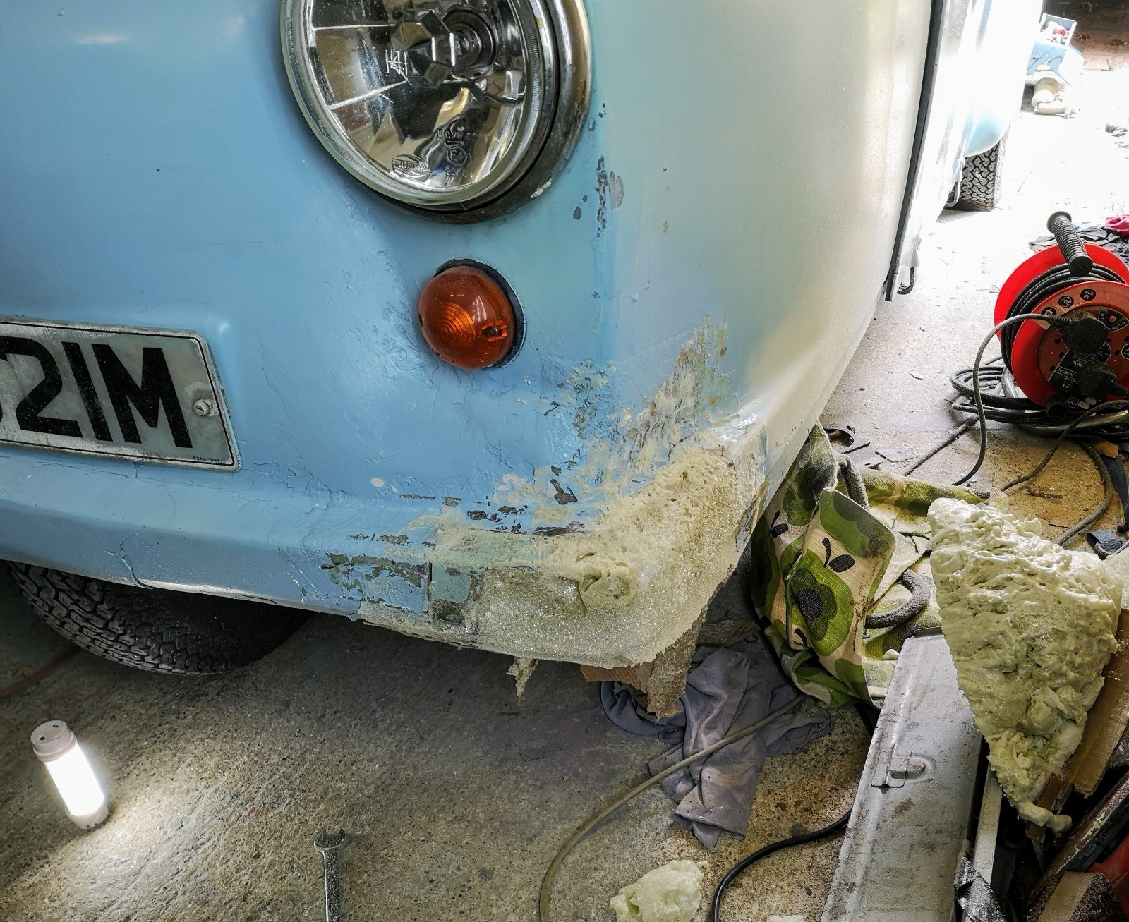

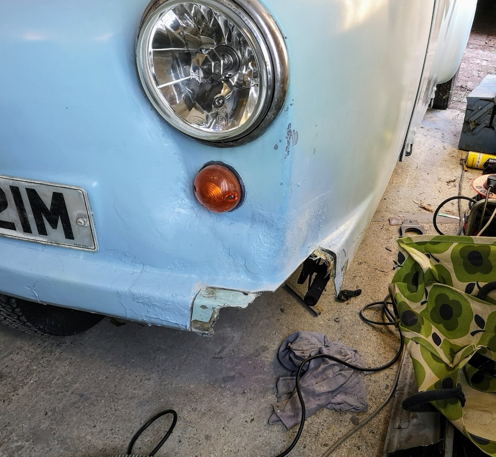

Before the front end can be painted though I need to finish rebuilding the corners...the nearside one in particular was a joke. First bit of GRP work I'd done beyond patching up cracks in a bashed bus corner, and it showed. I've done some experiments now with the materials I have to hand and have a plan.
Step one is to cut back out my original fugly handiwork.
Which left me with a much more evenly shaped void than the ragged hole that was originally there. The panel above isn't too bad, just the bumper moulding and below that needs done.
Originally I had tried to build up a rough mould out of cardboard etc and to glass over that...which I found quite difficult to do accurately - especially trying to get the mat to adhere to the underside of the bumper moulding and the valance.
Have decided to take a different approach. I've built up a loose barrier behind the panel, then entombed the entire area in expanding foam.
Once that's set I'll "whittle it down" to sculpt the correct profile. A simple matter then to stick a layer or two of GRP over it, some filler and then we should have as close to an invisible repair as I'm likely to manage with the materials I have to hand. I'm far more used to sculpting stuff from foam, so reckon I've a far better shot at getting the profile right this way. Once the outer surface is built up the foam base can then be broken away from behind the panel.
The whole front of the car is basically just a giant mud guard, it's just a plastic box, so this approach is actually valid...rather than expanding foam being the absolutely last thing you want to ever see on a car when doing body repairs! Especially when a mate discovered the sills on their Jag XJ6 were entirely built of the stuff...

Expanding foam is wonderful stuff - but - it will continue to expand for weeks as it absorbs moisture, unless they have fixed this problem with it.
Window fitters who were a bit too generous with it would be called back after a couple of months as the window frames were slowly being pushed out of the walls.

This stuff seems to be all right, where I've used it on the van to insulate around the toilet enclosure it didn't move once it had set.
Not really an issue here anyway - once the shape is there it will be getting glassed over - and as the back is open it would just push itself out the back I'd think. Only thing braced behind it is a bit of cardboard...and I'll probably dig it out once the first layer of glass has been put in place anyway so I can reinforce it from the back.
I did discover one nasty quirk of it when I got a bit on the back of my hand. It doesn't stick well to skin - it does however stick *really* well to hair. So it now looks like I've waxed the hairs off the back of my left hand. That didn't half sting!

Zelandeth wrote: 30 May 2019, 00:20 This stuff seems to be all right, where I've used it on the van to insulate around the toilet enclosure it didn't move once it had set.
I had to use it in my son's new house. Mice were getting in through gaps in the floor (concrete) where the water main comes in and the kitchen sink drain exits.
Naturally done laid flat out on kitchen floor reaching under the unit and only 3" to work with.
You can imagine how that turned out
Worked though.

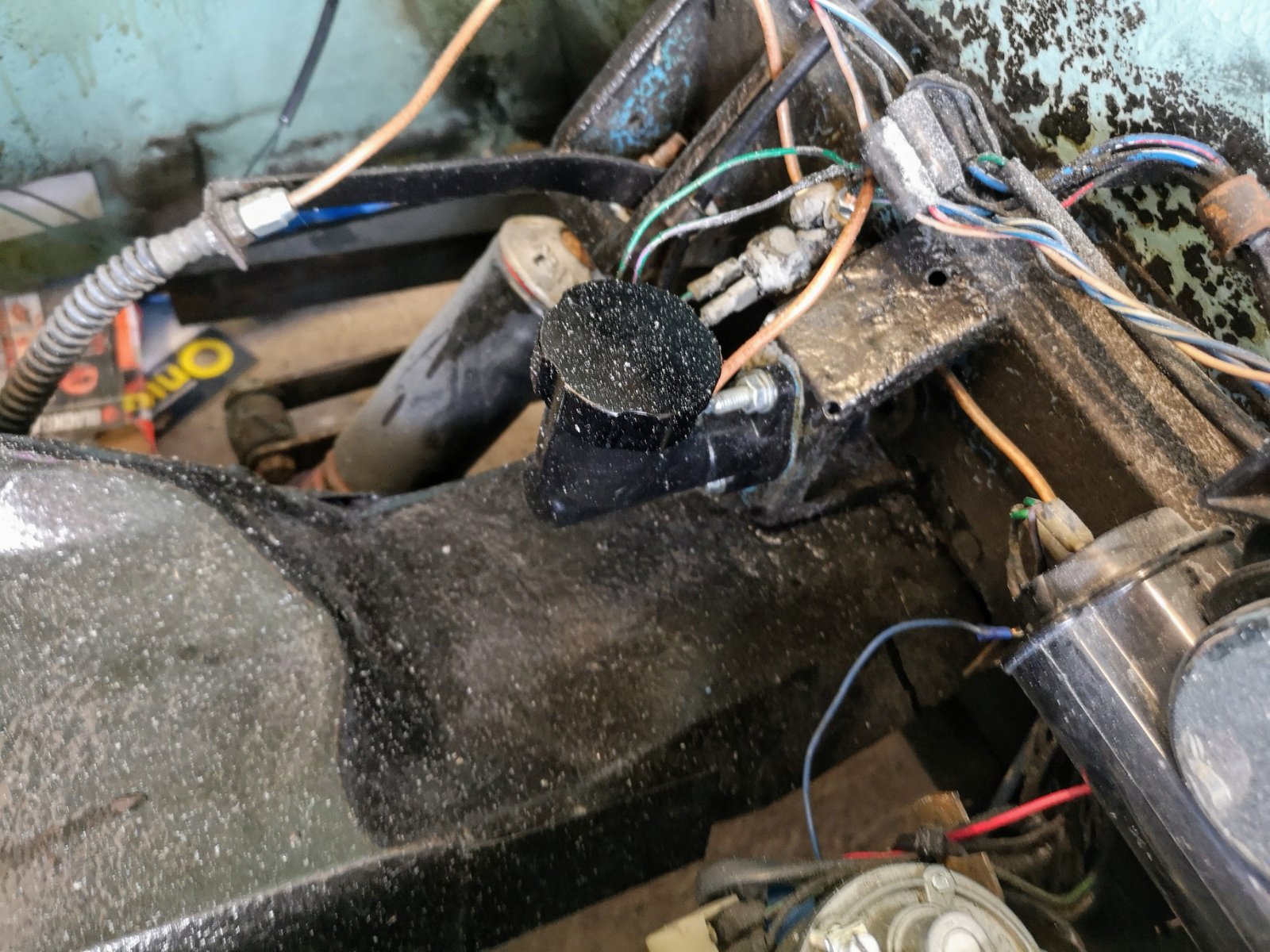

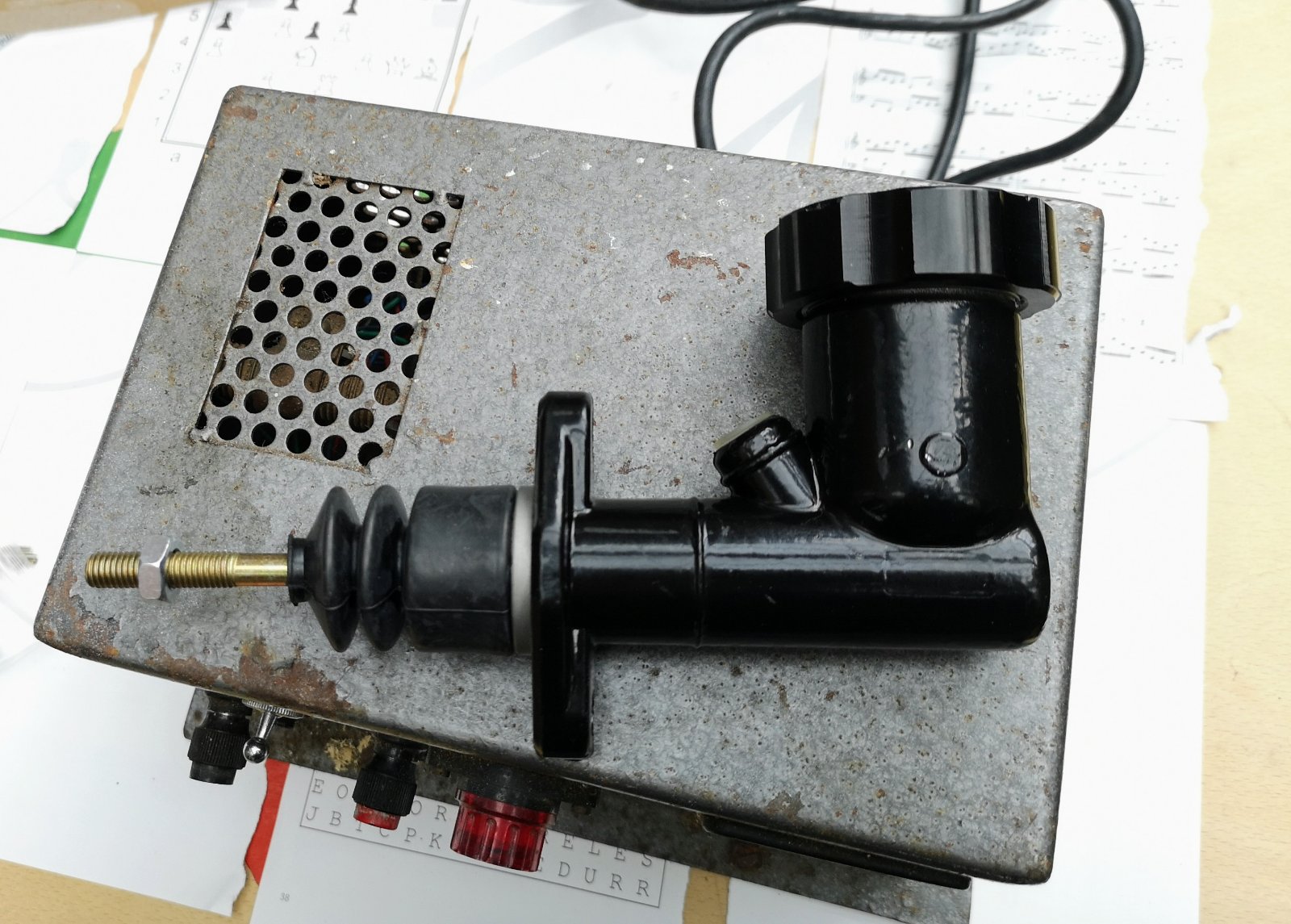

Hey, look what *finally* turned up in the post this morning...
Was ordered on the third of May, from a seller which made a very loud point all over their webpage about how they were UK based...however failed to make any mention until after you had made the order that parts were shipped from "their partner warehouse" - in China. Go figure. However it was essentially free, and the part itself actually looks reasonable where it counts. The threads are all nice and clean and the bore looks to be nicely machined (yes, first thing I did was take it apart before I considered trusting it to be the source of my stopping power), and there's no swarf in evidence as often seems to be the case with stuff like this. Was quite surprised to be honest...I was honestly expecting a lot worse.
Swapped over the pushrod from the original one from the car and then got it installed.
The dust is from later in the day, obviously kept things as clean as possible while the hydraulic work was underway.
Bleeding the system was simple enough, and immediately after the bleed nipples were closed it was obvious we had pretty much resolved the issue. Full brake travel is now a couple of inches...rather than two to four inches of dead travel before anything starts happening. Much better. A quick test run later on revealed that we indeed now have plenty of brakes. Reckon there is a little adjustment still to be done as if you really stand on the brakes she does pull slightly to the left, not apparent in normal driving though.
Figured it was time to have a quick experiment with my foam based wing corner rebuild.
This was after literally five minutes with the grinder to pull the excess material off.
Yes...this is definitely heading down the right road I think...with a bit of work I reckon I should be able to get this pretty close to an invisible repair.
