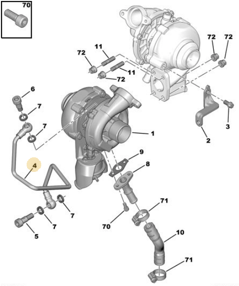

I'm pretty sure the C4 GP only came with the 110 version of the engine, which gives the part no as 037968 at £61.85 (
FFS!). Several on e-bay starting at <£20. But, post up the VIN and I will confirm the part no.

Yes, part 037968. Don't forget there was a modified lower bolt (number 5) part 037660. Copper seals (Number 7) are 015708.
They did do the C4 GP in a 138 2.0 HDi version too.

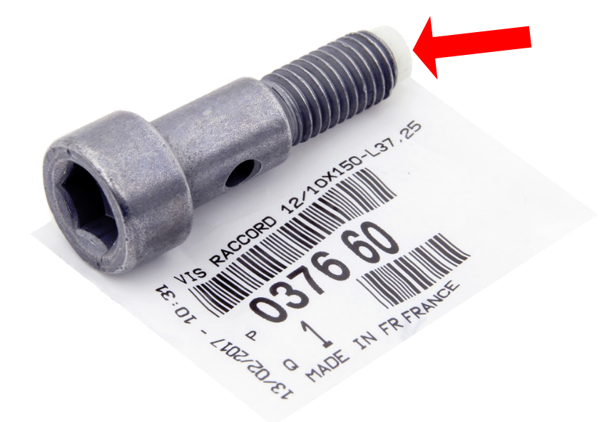

On the C4 Picasso mk2 DV6C engine is the filter inside the banjo bolt still a feature? Does the modified part 037660 lower bolt have no filter?
Can people pull the filter out themselves?

The revised part 037660 still has the filter in as you can see from the picture below - look at the top of the bolt and you can see the white plastic filter (arrowed).
