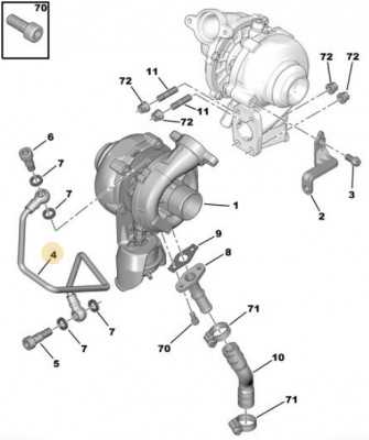

Re: Banjo pipe/bolt joint query
I'm pretty sure the C4 GP only came with the 110 version of the engine, which gives the part no as 037968 at £61.85 (
FFS!). Several on e-bay starting at <£20. But, post up the VIN and I will confirm the part no.
If you haven't done so already, then remove the sump and rip the strainer out of the oil pick up, otherwise you will probably end up with no oil pressure after 6-7k miles... Oh, and if you didn't remove the filter from the turbo banjo bolt, then do that as well, otherwise your new turbo will probably last about 5 miles....
- x 6945
Yes, part 037968. Don't forget there was a modified lower bolt (number 5) part 037660. Copper seals (Number 7) are 015708.

- x 6945
The revised part 037660 still has the filter in as you can see from the picture below - look at the top of the bolt and you can see the white plastic filter (arrowed).
