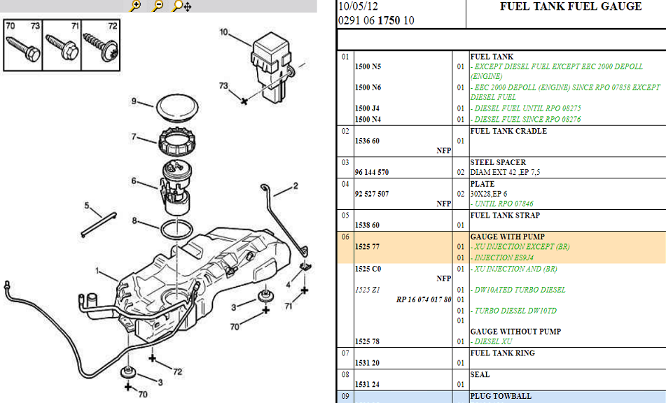

Well, if you need convincing, here is the official diagram for your vehicle (and I had one of these too) that shows the tank with the gauge - and as you can clearly see from item 2 description to confirm what has been said "Gauge Without Pump":mikeyb1949 wrote: 12 May 2019, 11:19 I can't buy into the idea that the car should not have both a lift pump and a primer bulb, or that someone in the past has wrongly fitted a lift pump. My reasons for this are:

Click Image to Zoom Forget Haynes they are useless and do not cover all the models.
Compare the above with an earlier Xantia HDi Turbo Diesel that does have a pump with the gauge:
The wiring and connectors will be for the gauge assembly and for informing the engine ECU of fuel levels and for calculating additive quantity that needs to be injected etc.
The fuel, once primed with the bulb, should be drawn from a part of the high pressure pump as I indicated on the earlier diagram for the Siemens system.

Here's a 'Sender Unit' part number 1613302580 that would be for your C5 if replaced - brand new Bosch only £34 inc. VAT - so obviously has no pump unit.
Here's the wiring diagram showing the 2 wires fo the sender unit:
And here on the injection wiring diagram - items circled with 'marching ants' indicate optional equipment - that may or may not be fitted. 1208 is the Injection Pump - of which the pump component is not fitted.
So back on my original diagram Item 14 is the pre-supply transfer pump - built into the High pressure fuel pump.
