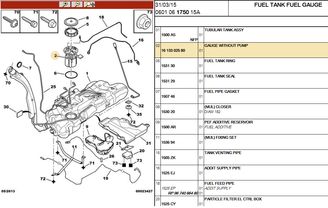

Well, if you need convincing, here is the official diagram for your vehicle (and I had one of these too) that shows the tank with the gauge - and as you can clearly see from item 2 description to confirm what has been said "Gauge Without Pump":mikeyb1949 wrote: 12 May 2019, 11:19 I can't buy into the idea that the car should not have both a lift pump and a primer bulb, or that someone in the past has wrongly fitted a lift pump. My reasons for this are:

Click Image to Zoom Forget Haynes they are useless and do not cover all the models.
Compare the above with an earlier Xantia HDi Turbo Diesel that does have a pump with the gauge:
The wiring and connectors will be for the gauge assembly and for informing the engine ECU of fuel levels and for calculating additive quantity that needs to be injected etc.
The fuel, once primed with the bulb, should be drawn from a part of the high pressure pump as I indicated on the earlier diagram for the Siemens system.

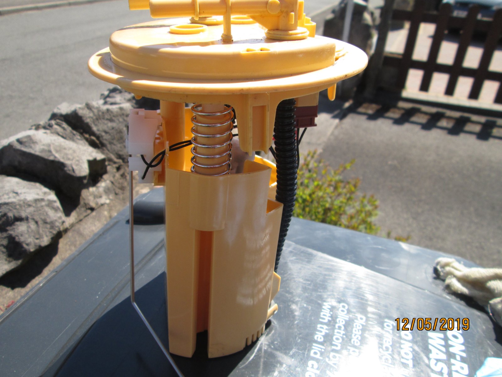

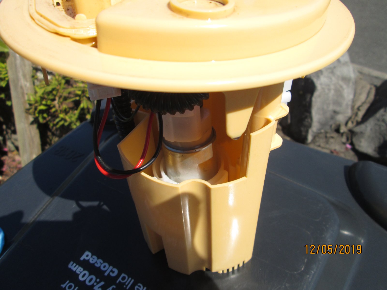

OK, so now you've really got me intrigued Marc, so I removed the "yellowish thing" from the tank, and found a float and sender, and in the middle of the unit what , to me, looks suspiciously like a pump. If my photos upload, you'll see what I found. I really can't think of anything that the silver tubular shaped device is other than a pump. There is a pipe connecting it to the outlet elbow on the top face, and a red wire and black wire connecting it to the connector block also on the top face.! I'd value your comments. Mike.

Here's a 'Sender Unit' part number 1613302580 that would be for your C5 if replaced - brand new Bosch only £34 inc. VAT - so obviously has no pump unit.
Here's the wiring diagram showing the 2 wires fo the sender unit:
And here on the injection wiring diagram - items circled with 'marching ants' indicate optional equipment - that may or may not be fitted. 1208 is the Injection Pump - of which the pump component is not fitted.
So back on my original diagram Item 14 is the pre-supply transfer pump - built into the High pressure fuel pump.

I have 4 wires going to the top of that unit, and 4 wires underneath, 2 from the level sensor and 2 from the pump. So are you saying that the wiring would always be there irrespective of whether or not it is needed in a particular car, and that someone has substituted a unit with a pump when I should have one without? If this is the case, then I should be able just to substitute a pipe for the pump which would then act as a pickup pipe. This then puts me back to square one. i.e. the starter only runs for a couple of seconds before switching itself off. I then have to switch off the ignition, turn it on again, and the procedure starts all over again. Something is preventing the starter from turning the motor over for more than 2 seconds. I've never experienced this before, usually you can turn the engine over and over until the battery is flat! Mike.

mikeyb1949 's pictures are certainly of a sender with pump, so there's confusion all round on this.

Apart from the colour (perhaps it's just dirty) that looks exactly like mine when it's installed.

If you take the plug off the tank unit there will only be 2 terminals on the tank unit (not the wiring loom) if it is just a sender & 4 terminals if it a combined pump/sender.
mikeyb1949
- Posts: 11
- Joined: 10 May 2019, 12:08
Re: Failed to proceed!
wheeler wrote: 13 May 2019, 16:17 If you take the plug off the tank unit there will only be 2 terminals on the tank unit (not the wiring loom) if it is just a sender & 4 terminals if it a combined pump/sender.
Yep, 4 terminals on mine.
