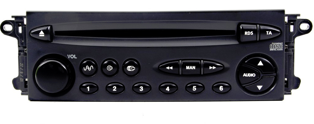

Ok, so the vehicle is a C5 5 Door Saloon 2.0 HDi 110 (DW10ATED) with manual 5 speed gearbox.French_car wrote: 27 Apr 2019, 19:27 Thanks for the welcome and for the link - I will await Marcs response before proceeding on this!
Thanks
You do have the earlier RD3 unit shown below.
Now according to the specifications, you may already have the CD-Changer installed. So you will need to check underneath the front passenger seat to see if you can see the CD Changer. On later models it was underneath the driver's seat - so check there just in case.
The point being is that an aftermarket device for USB playback like James pointed to HAS to make use and mimic the CD changer port. So it can only work with 6 folders (like 6 CDs in a changer) although each CD 'Folder' can have many tracks. You won't get anything like MP3 track and artist info, but you can still use the steering wheel control stalk to fast forward tracks, skip tracks and pause / resume etc., just as if it was a CD.
So if you do have the Clarion CD changer installed, you can disconnect this plug from the rear of the quadlock and replace it with an aftermarket unit to read and play MP3 files from USB for example. There are different versions available, but all mimic a CD changer - so bear that in mind.
The benefit of this kind of option is that it leaves the head unit and harness intact and allows for dull use of the remote stalk used for controlling the audio functions, so you won't need a harness or adaptor.
If you are thinking about replacing the whole head unit, you will just need to get a compatible harness to operate the audio stalk. There are no critical functions affected by the Head Unit on this model.

GiveMeABreak wrote: 27 Apr 2019, 19:54Ok, so the vehicle is a C5 5 Door Saloon 2.0 HDi 110 (DW10ATED) with manual 5 speed gearbox.French_car wrote: 27 Apr 2019, 19:27 Thanks for the welcome and for the link - I will await Marcs response before proceeding on this!
Thanks
thank you so much for your investigative work and advice!
There is already a 6-CD changer installed under the driver seat. I didn't realise this was a factory option - I thought it was aftermarket.
It may be clarion branded as you have suggested, though I thought it was a pioneer unit, but I might just be remembering wrong.
Am I right in thinking that the folders have to be named CD01, CD02 - CD06. and that each folder can only contains up to 99 songs?
Will the one james has linked work for me?
Are you able to advise on my other 2 questions - regarding if my model has a tubo and what type of accelerator pedal I have?
