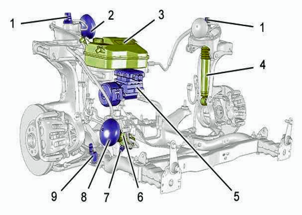

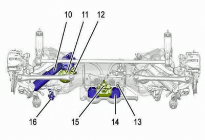

I believe the active damping actuators are fixed near the top of the struts. They have electronic cables attached to control the actuators that provide the variable damping, by opening and closing the orifice that allows the fluid to travel back and forward. So these are part of the struts. The AMVAR system was only available on the V6 models - on lower spec. versions it uses the same system as the C5 X7 (to put it correctly, the X7 gets its's system from the C6).
| Front Suspension Components | Rear Suspension Components |
| (1) Variable damping suspension actuator. (2) Front suspension accumulator. (3) LDS fluid reservoir. (4) Front suspension cylinder. (5) Integrated BHI (BHI). (6) Front firmness regulator. (7) Suspension pressure sensor. (8) Front stiffener regulator accumulator. (9) Wheel travel sensor. | (10) Rear suspension cylinder. (11) Rear suspension accumulator. (12) Variable damping suspension actuator. (13) Suspension pressure sensor. (14) Rear stiffener regulator accumulator. (15) Rear firmness regulator. (16) Wheel travel sensor. |

Yes, also there are no leak back pipes on the gaiters front or rear on this setup. The fluid is returned (using the rear as an example) through a pipe from the rear stiffness regulator hydraulic block (that has the rear centre spheres on) back to the reservoir.
None of the struts are repairable on these systems unlike the MK I and MK II C5s. They are rubber bonded to metal. So if there is ever a leak, it is a new strut. So no separate gaiters, seals or other components. That’s the downside to this system, plug and play, throw away!

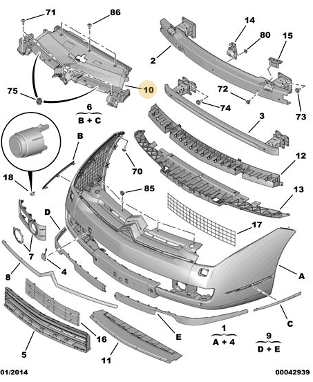

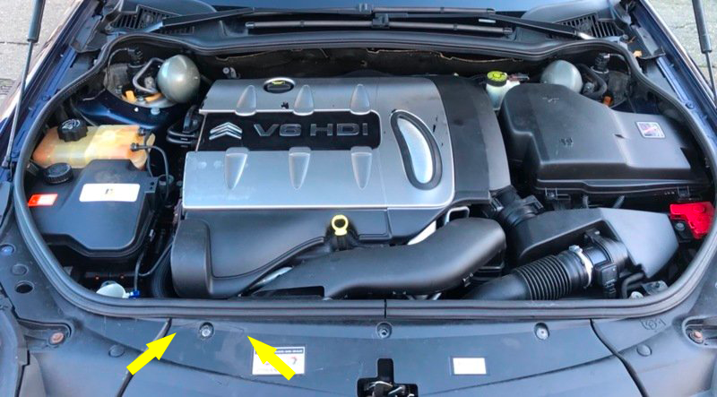

The car I am looking at doesn't have a plate that covers the engine sump, only underneath the radiator, is that normal? Also I attach a picture of the front top plastic cover of the radiator, notice the left part, there is a crack in the plastic, do you have to replace the complete bumper for that? or is it a separate piece?

Re: C6 2.7 HDI filter numbers
I can’t see any cracks in the photo Corne...
Perhaps you can circle the area you are concerned about?
Do you have the VIN of the vehicle?
I think I can see the crack. Zoom in, and look at the lower central plastic piece. There appears to be a crack that goes 'over' the securing bolt, and end near to the label.

I was using my iPhone so couldn't see it. Is this the part that I've arrowed Corne?
As for your other questions, the bumper range support is separate - item 10.

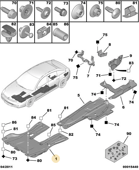

Here's the under engine protection
Hi Marc
Yes, exactly that spot, so atleast I can get it separately, now have to get a supplier and import it, aswell as the belly plate which is exactly what I need. Shame I can't get it fitted on the car before having it shipped, would be cheaper...
