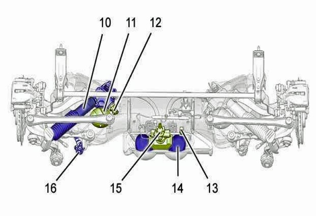

I believe the active damping actuators are fixed near the top of the struts. They have electronic cables attached to control the actuators that provide the variable damping, by opening and closing the orifice that allows the fluid to travel back and forward. So these are part of the struts. The AMVAR system was only available on the V6 models - on lower spec. versions it uses the same system as the C5 X7 (to put it correctly, the X7 gets its's system from the C6).
Front Suspension Components | Rear Suspension Components |
(1) Variable damping suspension actuator. (2) Front suspension accumulator. (3) LDS fluid reservoir. (4) Front suspension cylinder. (5) Integrated BHI (BHI). (6) Front firmness regulator. (7) Suspension pressure sensor. (8) Front stiffener regulator accumulator. (9) Wheel travel sensor. | (10) Rear suspension cylinder. (11) Rear suspension accumulator. (12) Variable damping suspension actuator. (13) Suspension pressure sensor. (14) Rear stiffener regulator accumulator. (15) Rear firmness regulator. (16) Wheel travel sensor. |

Yes, also there are no leak back pipes on the gaiters front or rear on this setup. The fluid is returned (using the rear as an example) through a pipe from the rear stiffness regulator hydraulic block (that has the rear centre spheres on) back to the reservoir.
None of the struts are repairable on these systems unlike the MK I and MK II C5s. They are rubber bonded to metal. So if there is ever a leak, it is a new strut. So no separate gaiters, seals or other components. That’s the downside to this system, plug and play, throw away!
