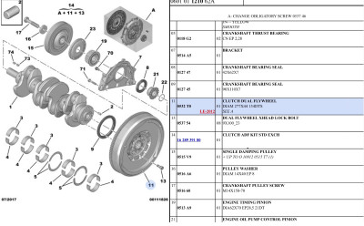

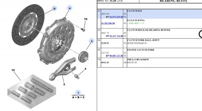

None of those are correct. Never use your registration, only 60% reliable at best. Always get the ODM part number and use that to ensure you get the correct parts.
The Flywheel is actually 277 as you can see under part number 11.
The first part numbers are the OEM ones and where there is another > 3 yrs that means an equivalent part for older cars that is generally cheaper. Parts with ‘RP’ in front of them are the later replacement part numbers that have superseded the original part number.

GiveMeABreak wrote: 17 Apr 2019, 22:28 None of those are correct. Never use your registration, only 60% reliable at best. Always get the ODM part number and use that to ensure you get the correct parts.
Click images to Zoom:
Thank you. What a happy surprise, of course I just happen to have the biggest and most expensive flywheel ever known to mankind on my version of the C5.
I will also check if they fitted the correct one last time, the part number is on the receipt. But I guess I can't do anything even if it's the wrong type, since it is 4 years ago now.
Thanks, will order the LUK RepSet with 0532-T0 wheel.
