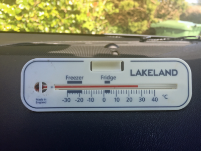

I'm in the car now doing a test as it is quite warm outside with my thermometer and will see how quickly she cools.
Readings shortly......
So update:
Not sure if this is of any help though Stu.
So update:
So car had been sitting in sun all day, unused. Inside temp started at 30°C, but then settled to 28°C on the thermometer before starting. Outside Ambient temp on the display was 24°C. Time Auto Climate was turned on was 15:40PM. All settings turned to 'LO', with Auto setting on - all flaps opened. | |
At 15:45PM, 5 minutes later, the temp. on the thermometer now shows 20°C. Note that the thermometer is placed on the dash as shown and NOT directly in the airflow on the windscreen vent. | |

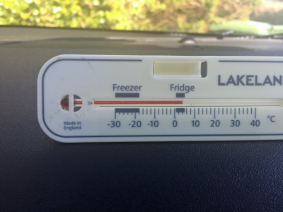

At 15:50PM, the thermometer is now showing 4°C 5 minutes later, now a lot of heat has been displaced. | |
It continues to fall slightly another 2 minutes later to about 4°C | |
Close up of thermometer. So test lasted 7 minutes to get from 28°C internally to 4°C. I suspect the top dash vent air helped the thermometer get to the 4°C a bit quicker. But overall the cabin was cooled quite rapidly for a car that was sat in the sun all day without being opened. |

Ok, so here today on the test it is 30°C outside the car. |
It's 15:56 when I got in the car and switched the ignition on. Temp. showing 29°C at 15:56. | Here's the Thermometer and the Display confirming times and temperatures before the engine is started. |
I start the car and immediately set the temperature left and right to 14 °C and press AUTO on both controls | Fan is running fast (not maximum) and all vents are open, including top diffuser. 3 Minutes later, temperature has rapidly reduced to 16°C on the thermometer. Outside temperature is still showing a high of 27°C. |
