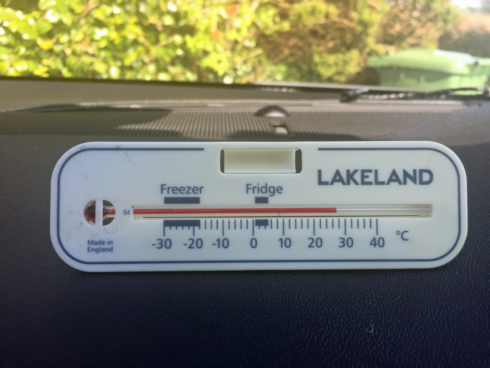

So car had been sitting in sun all day, unused.
Inside temp started at 30°C,
but then settled to 28°C on the thermometer before starting.
Outside Ambient temp on the display was 24°C.

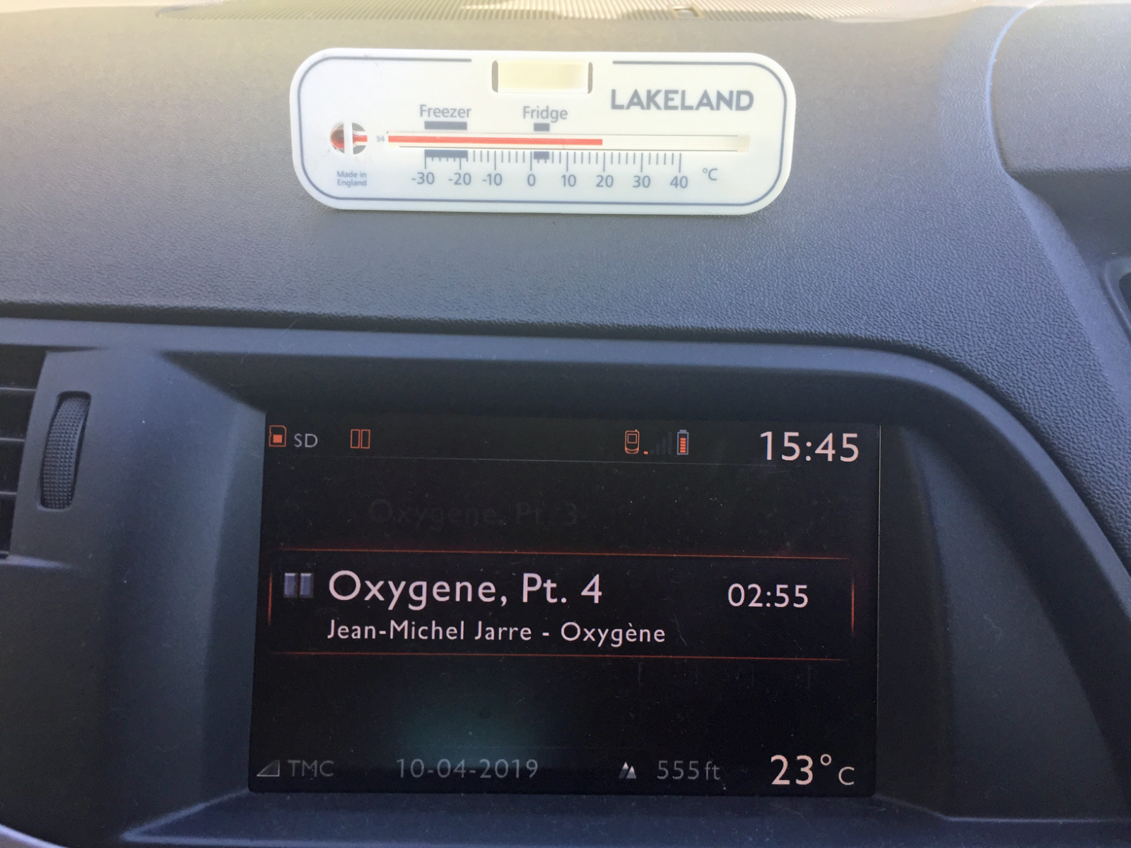

Time Auto Climate was turned on was 15:40PM.
All settings turned to 'LO', with Auto setting on - all flaps opened.

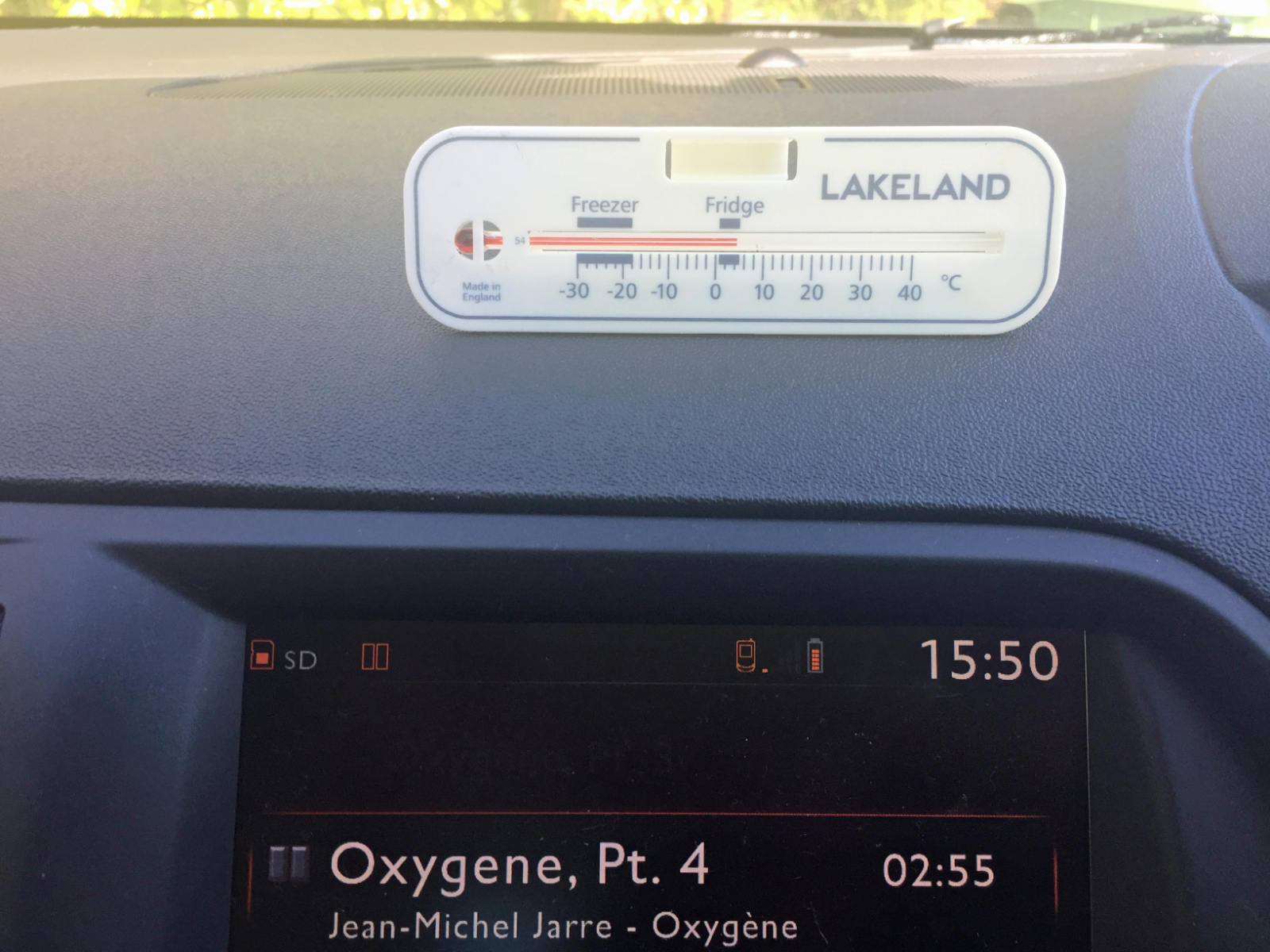

At 15:45PM, 5 minutes later, the temp. on the thermometer
now shows 20°C. Note that the thermometer is placed
on the dash as shown and NOT directly
in the airflow on the windscreen vent.

At 15:50PM, the thermometer is now showing 4°C
5 minutes later, now a lot of heat has been displaced.

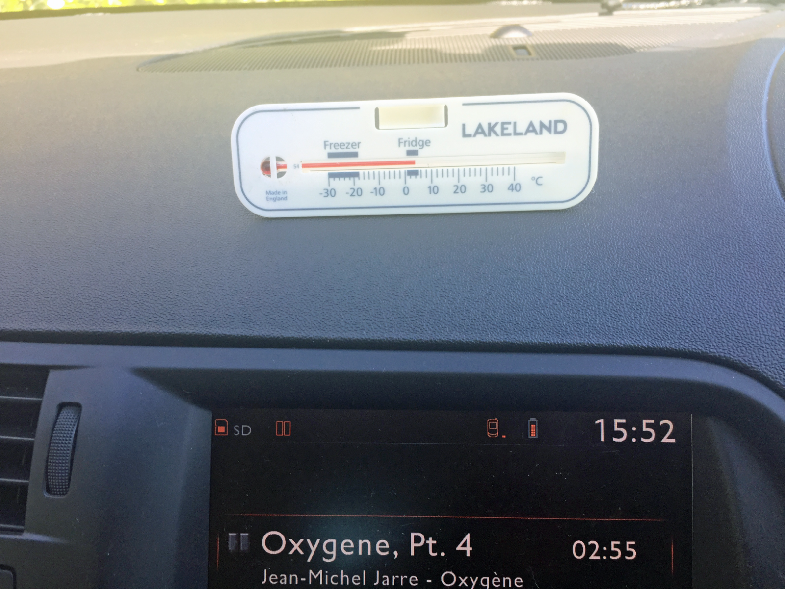

It continues to fall slightly
another 2 minutes later to about 4°C

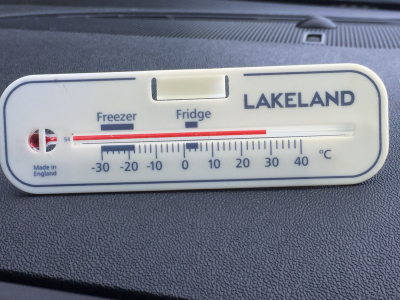

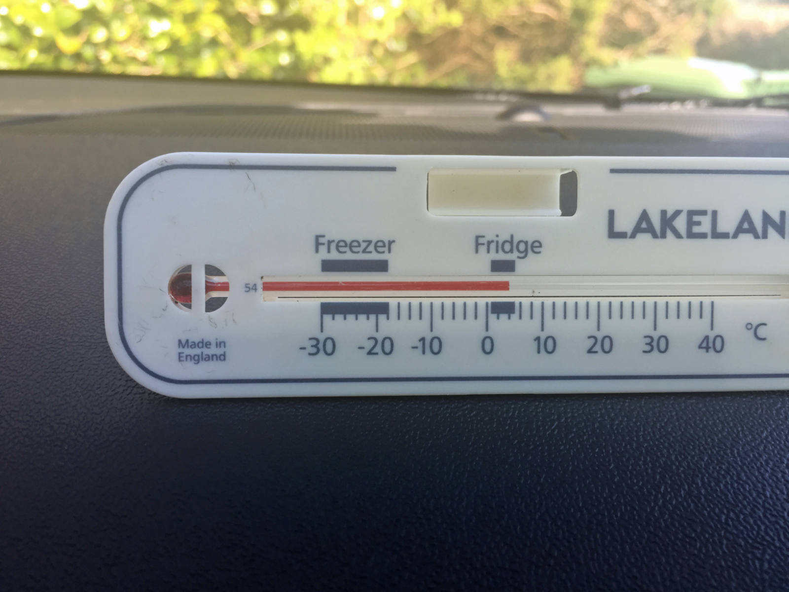

Close up of thermometer. So test lasted 7 minutes
to get from 28°C internally to 4°C.
I suspect the top dash vent air helped the thermometer get to the 4°C a bit quicker.

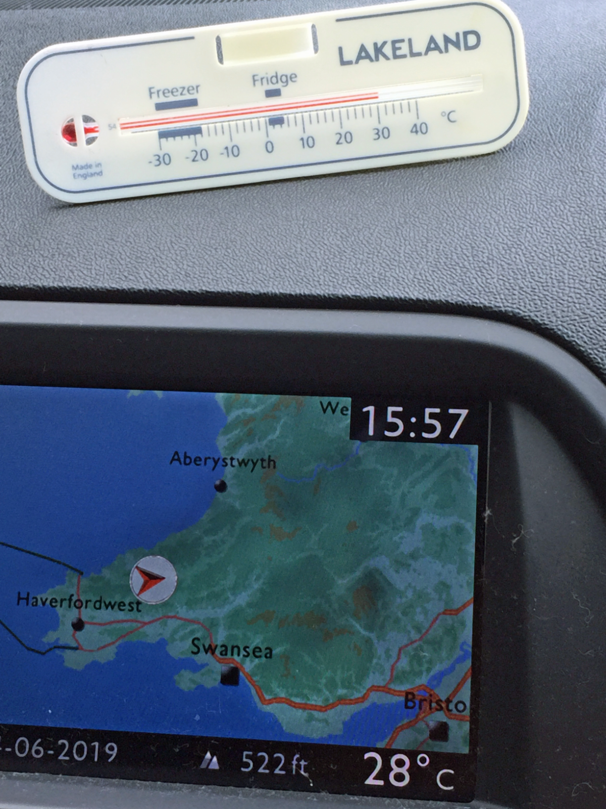

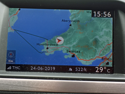

Ok, so here today on the test it is 30°C outside the car.
It's 15:56 when I got in the car and switched the ignition on.
Temp. showing 29°C at 15:56.
Here's the Thermometer and the Display confirming times and temperatures before the engine is started.

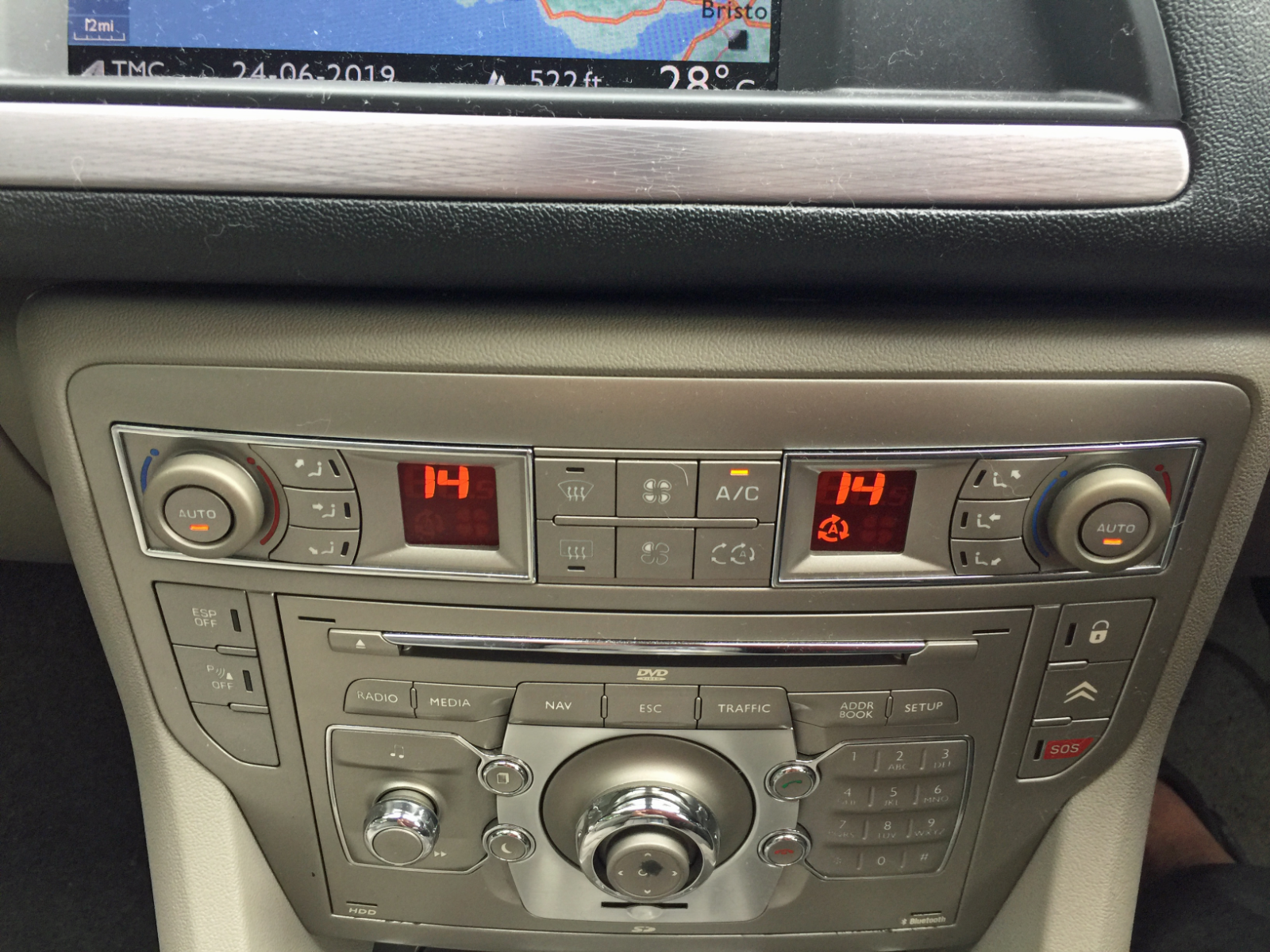

I start the car and immediately set the temperature left and right to 14 °C and press AUTO on both controlsFan is running fast (not maximum) and all vents are open, including top diffuser.

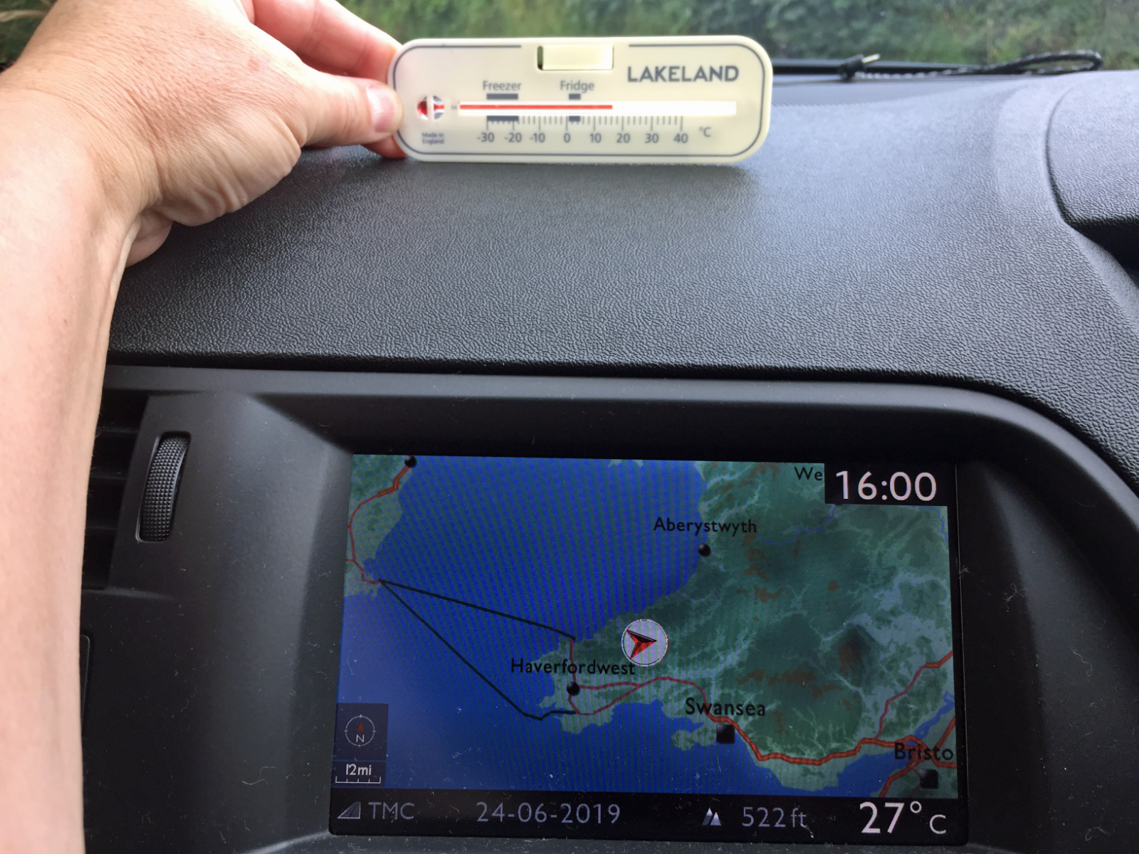

3 Minutes later, temperature has rapidly reduced to 16°C on the thermometer.
Outside temperature is still showing a high of 27°C.
So important to note that you don't set it to LO or HI as these settings are not regulated as I mentioned in my last post. But fans will reduce in speed as temperature level is reached and maintained.
