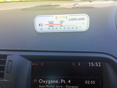

I'm in the car now doing a test as it is quite warm outside with my thermometer and will see how quickly she cools.
Readings shortly......
So update:
Not sure if this is of any help though Stu.
So update:
So car had been sitting in sun all day, unused. Inside temp started at 30°C, but then settled to 28°C on the thermometer before starting. Outside Ambient temp on the display was 24°C. Time Auto Climate was turned on was 15:40PM. All settings turned to 'LO', with Auto setting on - all flaps opened. | |
At 15:45PM, 5 minutes later, the temp. on the thermometer now shows 20°C. Note that the thermometer is placed on the dash as shown and NOT directly in the airflow on the windscreen vent. | |
At 15:50PM, the thermometer is now showing 4°C 5 minutes later, now a lot of heat has been displaced. | |
It continues to fall slightly another 2 minutes later to about 4°C | |
Close up of thermometer. So test lasted 7 minutes to get from 28°C internally to 4°C. I suspect the top dash vent air helped the thermometer get to the 4°C a bit quicker. But overall the cabin was cooled quite rapidly for a car that was sat in the sun all day without being opened. |

yep, thank you for carrying out the test for me, good choice of music....
Alway, got into car tonight after leaving work, central display gave outside temperature as 23 degrees, started car and air-con started up as expected, medium speed fan. So my assumption is that the air conditioning output is determined by the outside temperature and not the cabin, therefore I think the functioning side of things is probably okay.
However,
Marc, you have set me a target, I know my system has never been as quick as yours, so it may definitely worth a trip to Kwik-fit for a recharge & clean.

Ok, so here today on the test it is 30°C outside the car. |
It's 15:56 when I got in the car and switched the ignition on. Temp. showing 29°C at 15:56. | Here's the Thermometer and the Display confirming times and temperatures before the engine is started. |
I start the car and immediately set the temperature left and right to 14 °C and press AUTO on both controls | Fan is running fast (not maximum) and all vents are open, including top diffuser. 3 Minutes later, temperature has rapidly reduced to 16°C on the thermometer. Outside temperature is still showing a high of 27°C. |
