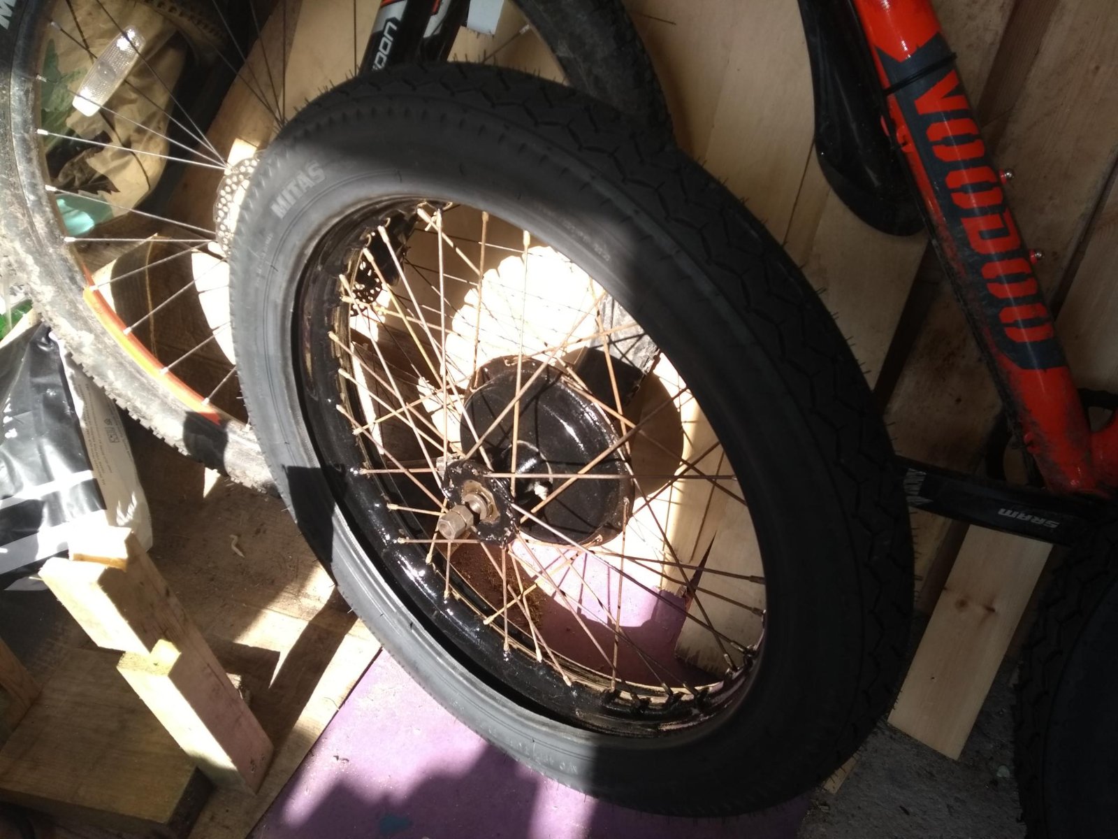

Then moved onto the tyres, success with the rear
I got the front on, but school boy error in not putting some air in the tube meant I pinched it with the tyre levers, and wrecked it, so had to take it back out again...
