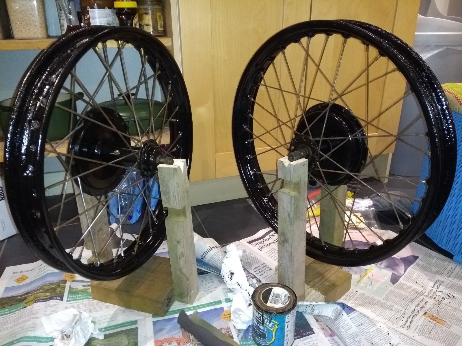

I decided to fit the new spokes to the rear wheel before painting, as then I could true it a bit, since getting any of the nipples to turn requires heating them which will ruin the paint. So here it is in the vice with a guide to check the run out - note the G-cramp holding it to the bench is home-made - most likely by my Grandad, which is pretty apt!
It wasn't any worse than when I checked it before, I tweaked a few spokes to true up the worst bit - it's not perfect, but it has pulled it back a bit. Don't want to go any further as one of the nipples I tried before disintegrated - maybe I heated it too much...
Then I needed some supports to hold the wheels up whilst I paint them, a few mins with a few offcuts of wood, and voila:

First coat of paint on the wheels at the weekend. Need to put another on tonight then I can move on to the frame and forks, and the brake back plates, ready for a rolling chassis build.
It's a bit difficult to see in the pic, but given it's just a brush finish with Smoothrite they've come out really well. I'm not sure how impressed Mrs W was that I was painting them in the Kitchen
