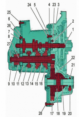

So here is the official Saxo Gearbox data - you can make your own minds up based on the facts....
Note the last section with the uprated boxes and the warning at the bottom about Gearbox interchangeability...
These are the gearboxes listed for the Saxo that were uprated and from build date August 2000:
Diesel variants are marked in Purple.
Key:
(1) Entreprise versions.
(2) VTS variant vehicle trim level.
(3) VTS Taiwan variant vehicle trim level.
(*) tyres : 165 x 70 R 13 or 165 x 65 R 14.
(**) tyre 185 x 55 R 14.
Special Features
This gearbox does not contain any adjustment.
This gearbox has a reverse brake (5th gear synchronizer).
This gearbox has a device that prohibits changing from 5th gear into reverse gear.
The length of the splines on the primary shaft, clutch end, is increased by 2,5 mm on gearboxes in the following sequences:
| (1) input shaft. (2) release bearing guide. (3) clutch housing. (4) gearbox casing. (5) intermediate plate. (6) Bearing retainer (bearing retaining plate). (7) driving gear (5th gear). (8) output shaft. (9) synchronizer (5th gear). (10) driven gear (5th gear). (11) driven gear (4th gear). (12) 3rd/4th synchronizer. (13) driven gear (3rd gear). (14) driven gear (2nd gear). (15) 1st/2nd synchronizer and reverse driven gear. (16) driven gear (1st gear). ( 17) differential crown wheel. (18) planet wheels. (19) sun wheels. (20) speedometer drive gear. (21) speedometer pinion. (22) differential box. |

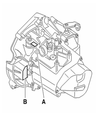

Question for Marc. Where do I find the reference number for my Saxo gearbox please. If it helps the VIN is VF7**************[VIN obfuscated, can be read by forum staff]
2010 C5 X7 VTR+Nav 160
1998 1.5 Saxo
1998 Pug 306 1.9D
2018 C4 B7 VTR+
2011 Citroen C1
1998 1.5 Saxo
1998 Pug 306 1.9D
2018 C4 B7 VTR+
2011 Citroen C1
- x 6956
Re: Citroen Saxo gearboxes

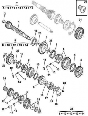

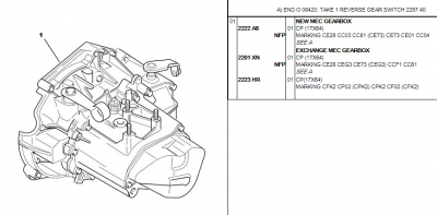

These are the only references under parts as per the diagram below, but look at the second picture to locate the identification labels / markings of the gearbox.
Click diagram to Zoom Identification:
There is also a gearbox repair kit: Part 229945 still available from Citroen for £376.91 (I know, silly money) containing all of the parts marked 'A':
There are also individual parts still available from the following Diagram for your Gearbox:
| ( A) identification label stuck on the clutch operating lever. (B) location of engraving of serial and gearbox numbers (example : 20 CC 17). |
