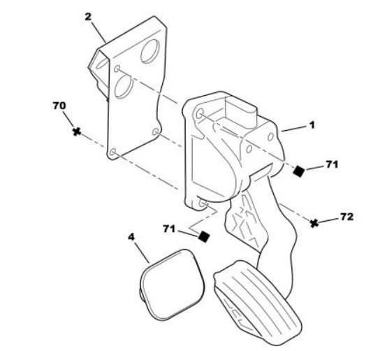

I've only just had time to see your last posts - but glad you have it sorted now. Was it the accelerator potentiometer they replaced?:
Re: Xsara Picasso Idling
No, it was assemby of butterfly valve with motor.
I’m sorry, I can’t find the exact english expression for that part right now
