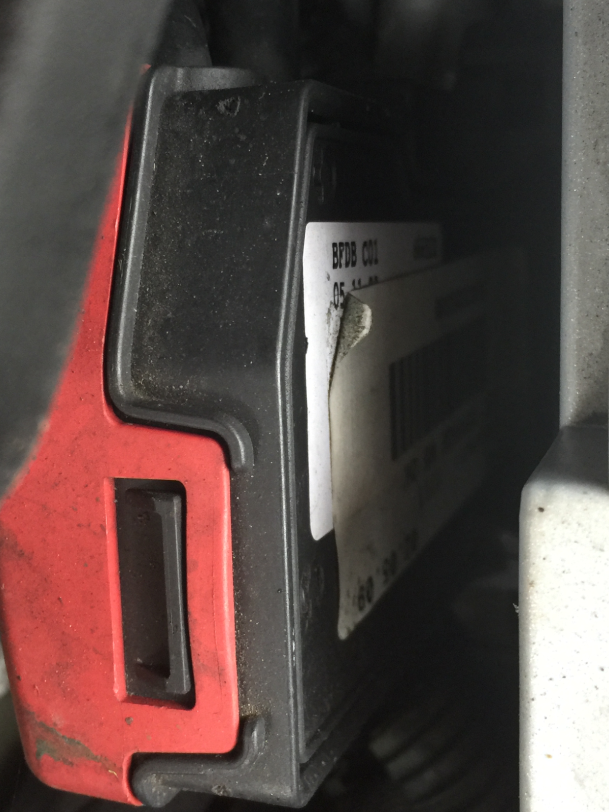

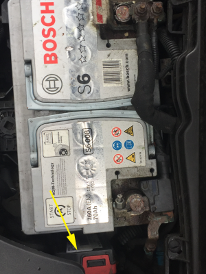

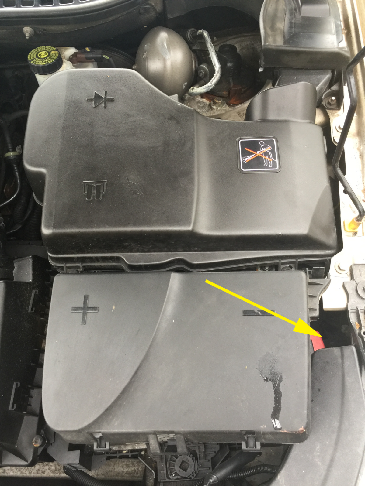

It's here Avi - on the side of the battery inside the Red BFDB Fuse Box shown:

Thank you both. I've seen that red/black box before I've asked, but never thought that it will be so good hidden.
