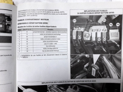

It's here Avi - on the side of the battery inside the Red BFDB Fuse Box shown:

Just had a look at my 2009 handbook and says the same thing. However the Revue Technique manual is much clearer. The fuses - there may be up to 9 of them - are to the right of the battery when you lift the plastic battery cover. They are in a vertically mounted plastic box and are shown in the attached manual page. (Acknowledgement to Revue Technique. ) The one you want is indeed F6. Just checked on my car - the box is red and black and will have to be pulled apart I think, to get at the fuses

Thank you both. I've seen that red/black box before I've asked, but never thought that it will be so good hidden.
