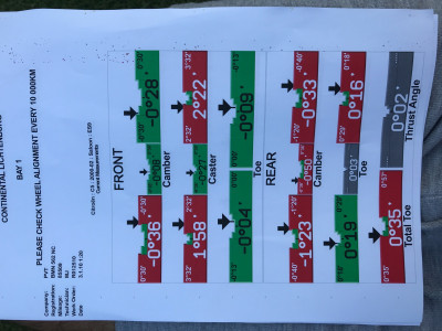

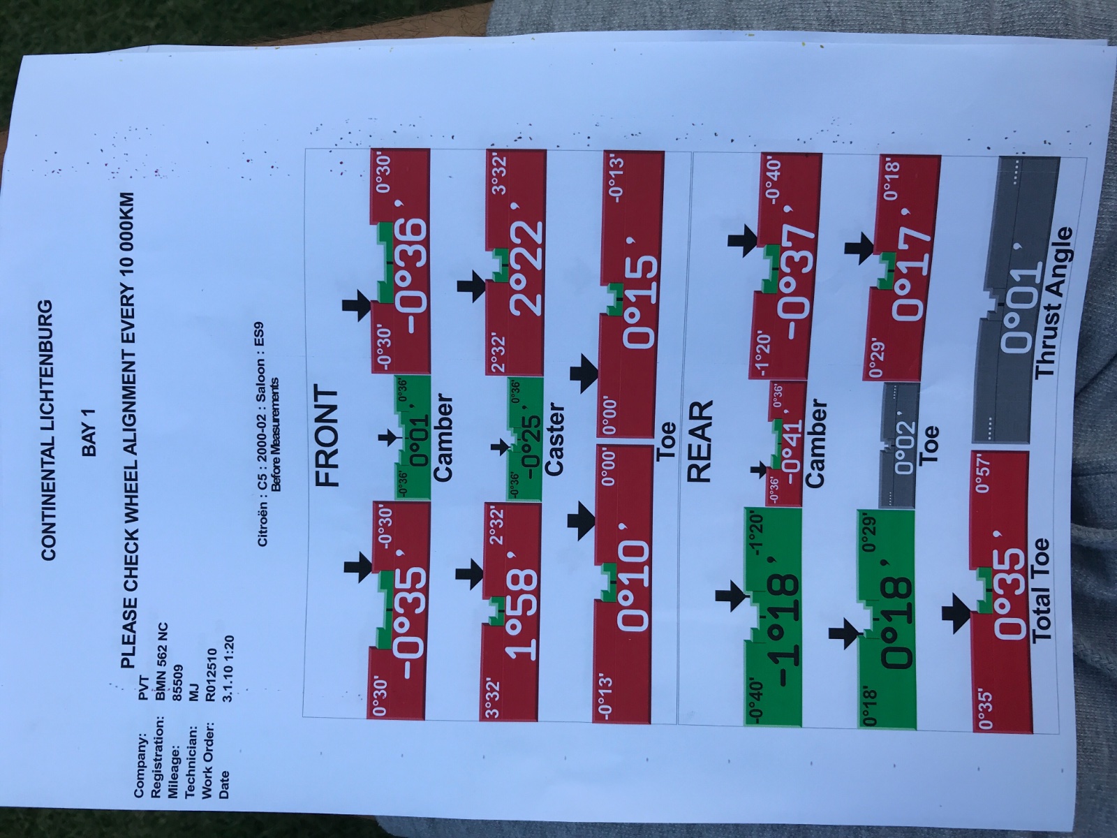

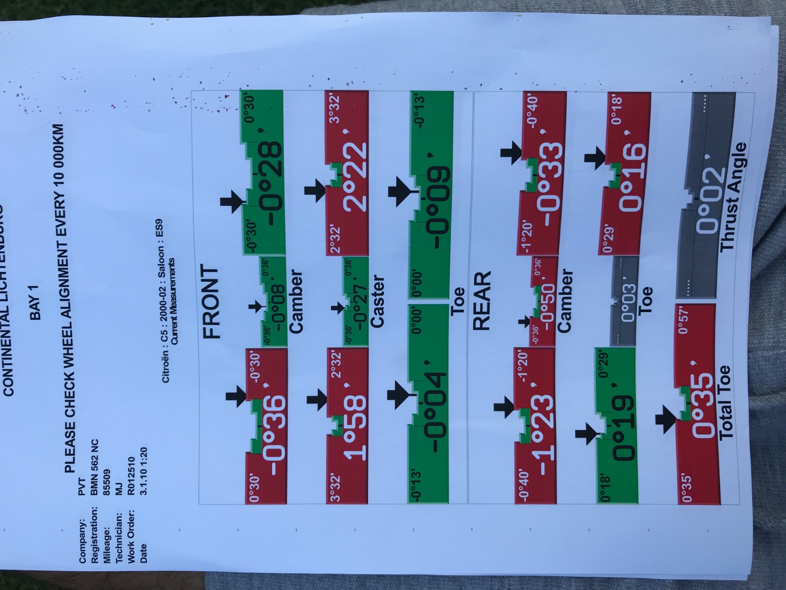

After replacing my inner tierod end the car had to get wheelalignment. I don’t drive her muck so took her for one today.
Apparently the caster and camber is out and non adjustable, is that true? He gave me a printout. Toe could be adjusted. But that was it.
I attach the printout. ES9 I believe is to do with the engine code?
What do you guys suggest to rectify the caster and camber?

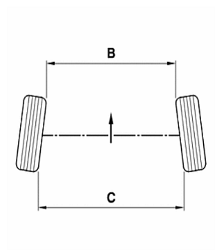

Hi Corne, that is also my understanding - here is the official data and settings:
N.B.: Front of the vehicle (following the arrow ).
B lower or equal to C : Positive figure (+) (toe-in).
B greater than or equal to C : Negative figure (-) ( opening).
Geometry of the front suspension
Rear axle geometry (Prior to build date (RPO) 9435). Your build date is 9055 Corne, so is relevant to your C5.

Re: C5 mk1 wheel alignment
Thanks Mark.
Now just trying to figure out how to do what to get it to the correct specs. I guess my vastor and camber is out. But how do you adjust the not adjustable?
The only thing I can suggest is to check the bushes and front lower control arms, bearings etc. for damage or wear Corne.

In South Africa. We do not have an MOT. You buy a car. Put it through a roadworthy test and as long as it is yours and not in a serious accident you never have to do any roadworthy ever again. So I have to keep a close eye on it and due to the lack of dealerships and likeability for Citroens one must do most things yourself. Your average mechanic does more damage to a Citroen than repair it this side of the world...
Well I don’t have any tyre wear and the steering wheel stays centre and no pulling on the road. Only concern after adjustment today is that when you accelerate I need to turn the wheel slightly anti clockwise. So I guess there is movement. I hit a pothole 2 days ago and lost a tyre. Im wondering if it didnt do more damage than just the tyre....
