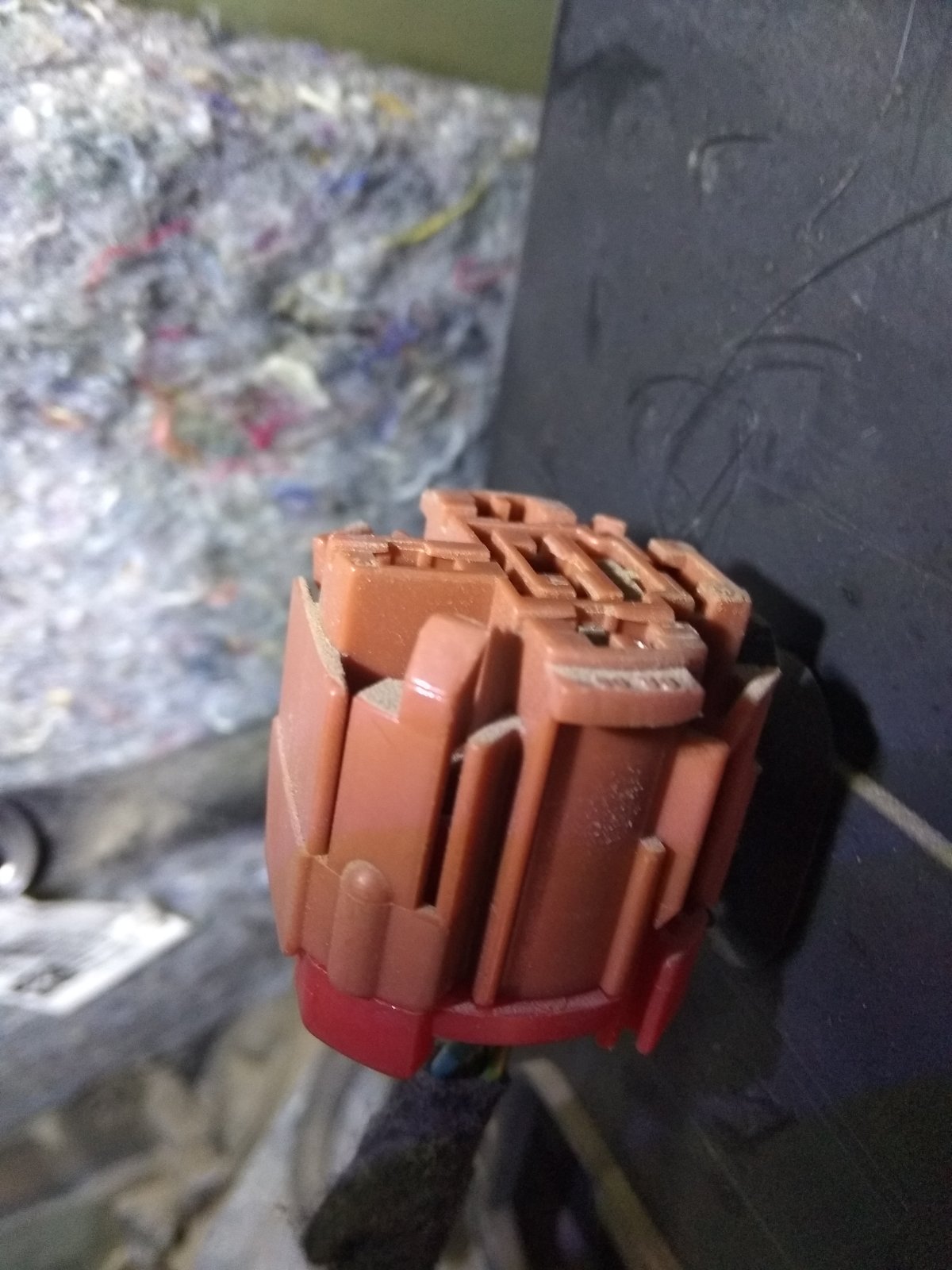

could you tell me if this is the socket for the tow bar electrical? I'm looking to install a tow bar on my C5 and I've found this socket in a sort of "hidden compartment" on the inner left side of the luggage compartment (please be aware that it is a left hand drive vehicle). I really hope that it's this socket, if not (this is the place for a disappointed emoji), please tell me what is this socket for and more important, where I can find the actual socket.

Towbara and the electrical harness AND the trailer fuse box unit are separate items Avi.
2 things to consider. There are manufacturer-specific electrical kid and generic third party units. The manufacturer approved units are designed to interface with the car’s stability control system (ESP) so that it knows when you are towing and can adapt the road holding programme to take towing trainers or caravans into consideration.
There is a special trailer fuse box and relay unit available that fits into the rear left compartment on a saloon, where the plugs are there ready, the wiring harness then plugs into this unit. The trailer unit then talks to the BSI and to the ESP ECU whenever the electrics are plugged into the unit. It also provides proper fusing for the trailer lights for example.
There are several approved tow bars available depending on mcwhicle model. If you want these I can supply you with them.
Unfortunately that picture won’t help and could be anything.

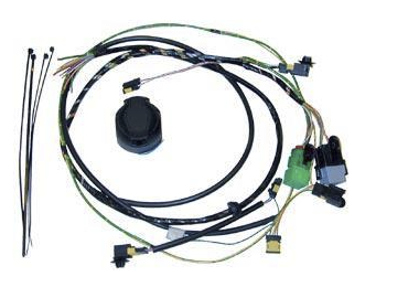

These are the Cirtoen Approved parts for your specific C5 Avi:
Note: In the table, I have included the Trailer Relay Unit and the 13 pin socket separately - however if buying the electrical harness kit (9428F7) - these are BOTH included in that kit!
Electrical Harness:
| Vehicle -Specific Fuse Box and Supplies, Part 9688EL | Electrical Harness Part 9428F7 |
| 13 Pin Socket Part 1609119280 | 9427EA Tow Bar that can be removed without tools |
| 9427CZ Tow Bar with Tow Ball that can be removed without tools | 9427CY Manual Retractable Tow Bar (needs Tools to Remove) |
| 9427CX Swan's Neck Towing Ball | 9427CW Manual Retractable Towbar |
| Blank | |
| 9427CV Swan's Neck Towing Ball (Removable Neck) | Blank |
Electrical Harness:
- This harness is particularly suitable for providing the lighting supply to trailers or cycle-carriers on tow bars.
- This harness has been developed to incorporate all of the vehicle special features.
- It also provides an electrical supply to the fog lights and reversing lights.
- Comes with a 13-way socket to correspond to the trailer socket.
- It incorporates all the features needed for good compatibility with this vehicle and is SAFE, RELIABLE and EASY to fit.
- The functionality of the harness will be obtained by configuration of the BSI (fitting by the network is imperative).

You've wrote that there are plugs in the rear left compartment. these are exactly what I'm looking for. the towbar kit that I've ordered (haven't received it yet) includes an interface to the vehicles system that plugs into those plugs. as I've mentioned before, I've looked into the luggage compartment and removed the "cover" that allows access to the rear left tail lamp and that socket was all I've found. could you give me some hint where these plugs might by?

Avi - have a look at this post - Elis was looking to wire in hi amplifier on his X7 saloon and clearly shows a picture of the inside left boot area. That looks like the brown plug you are asking about and as I think I answered in that post it should be the under inflation detection unit connectors.
viewtopic.php?f=52&t=58078&start=105#p544852

This is what I've found on the right side. did I hit gold?
The black wire on the left of the connector is not connected. just a short wire.
