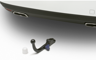

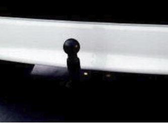

These are the Cirtoen Approved parts for your specific C5 Avi:
Vehicle -Specific Fuse Box and Supplies, Part 9688ELElectrical Harness Part 9428F7
13 Pin Socket Part 16091192809427EA Tow Bar that can be removed without tools
9427CZ Tow Bar with Tow Ball that can be removed without tools9427CY Manual Retractable Tow Bar (needs Tools to Remove)
9427CX Swan's Neck Towing Ball9427CW Manual Retractable Towbar
Blank
9427CV Swan's Neck Towing Ball (Removable Neck)Blank
Note: In the table, I have included the Trailer Relay Unit and the 13 pin socket separately - however if buying the electrical harness kit (9428F7) - these are BOTH included in that kit!
Electrical Harness:
  • This harness is particularly suitable for providing the lighting supply to trailers or cycle-carriers on tow bars.
  • This harness has been developed to incorporate all of the vehicle special features.
  • It also provides an electrical supply to the fog lights and reversing lights.
  • Comes with a 13-way socket to correspond to the trailer socket.
  • It incorporates all the features needed for good compatibility with this vehicle and is SAFE, RELIABLE and EASY to fit.
  • The functionality of the harness will be obtained by configuration of the BSI (fitting by the network is imperative).
