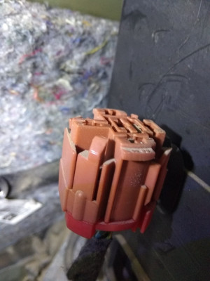

could you tell me if this is the socket for the tow bar electrical? I'm looking to install a tow bar on my C5 and I've found this socket in a sort of "hidden compartment" on the inner left side of the luggage compartment (please be aware that it is a left hand drive vehicle). I really hope that it's this socket, if not (this is the place for a disappointed emoji), please tell me what is this socket for and more important, where I can find the actual socket.

Re: Is it the socket / connector for the tow bar?
Towbara and the electrical harness AND the trailer fuse box unit are separate items Avi.
2 things to consider. There are manufacturer-specific electrical kid and generic third party units. The manufacturer approved units are designed to interface with the car’s stability control system (ESP) so that it knows when you are towing and can adapt the road holding programme to take towing trainers or caravans into consideration.
There is a special trailer fuse box and relay unit available that fits into the rear left compartment on a saloon, where the plugs are there ready, the wiring harness then plugs into this unit. The trailer unit then talks to the BSI and to the ESP ECU whenever the electrics are plugged into the unit. It also provides proper fusing for the trailer lights for example.
There are several approved tow bars available depending on mcwhicle model. If you want these I can supply you with them.
Unfortunately that picture won’t help and could be anything.
Avi - have a look at this post - Elis was looking to wire in hi amplifier on his X7 saloon and clearly shows a picture of the inside left boot area. That looks like the brown plug you are asking about and as I think I answered in that post it should be the under inflation detection unit connectors.
On the Tourer the connectors are definitely on the LH side but I think the Saloon might have them on the RH side so I assume that your car is an Tourer. I fitted a Westfalia tow bar and manufacturers electrics on to my Tourer last year. The electrics actually work the lights on a tow board without activating the BSI but, of course, you won't get all the clever bits like modifying the ABS and reversing sensors.
Have you looked on the opposite side (RH side) above and behind the wheel arch?
No. I took it for granted that it should be on the left side. I'll check it.
This is what I've found on the right side. did I hit gold?
The black wire on the left of the connector is not connected. just a short wire.
