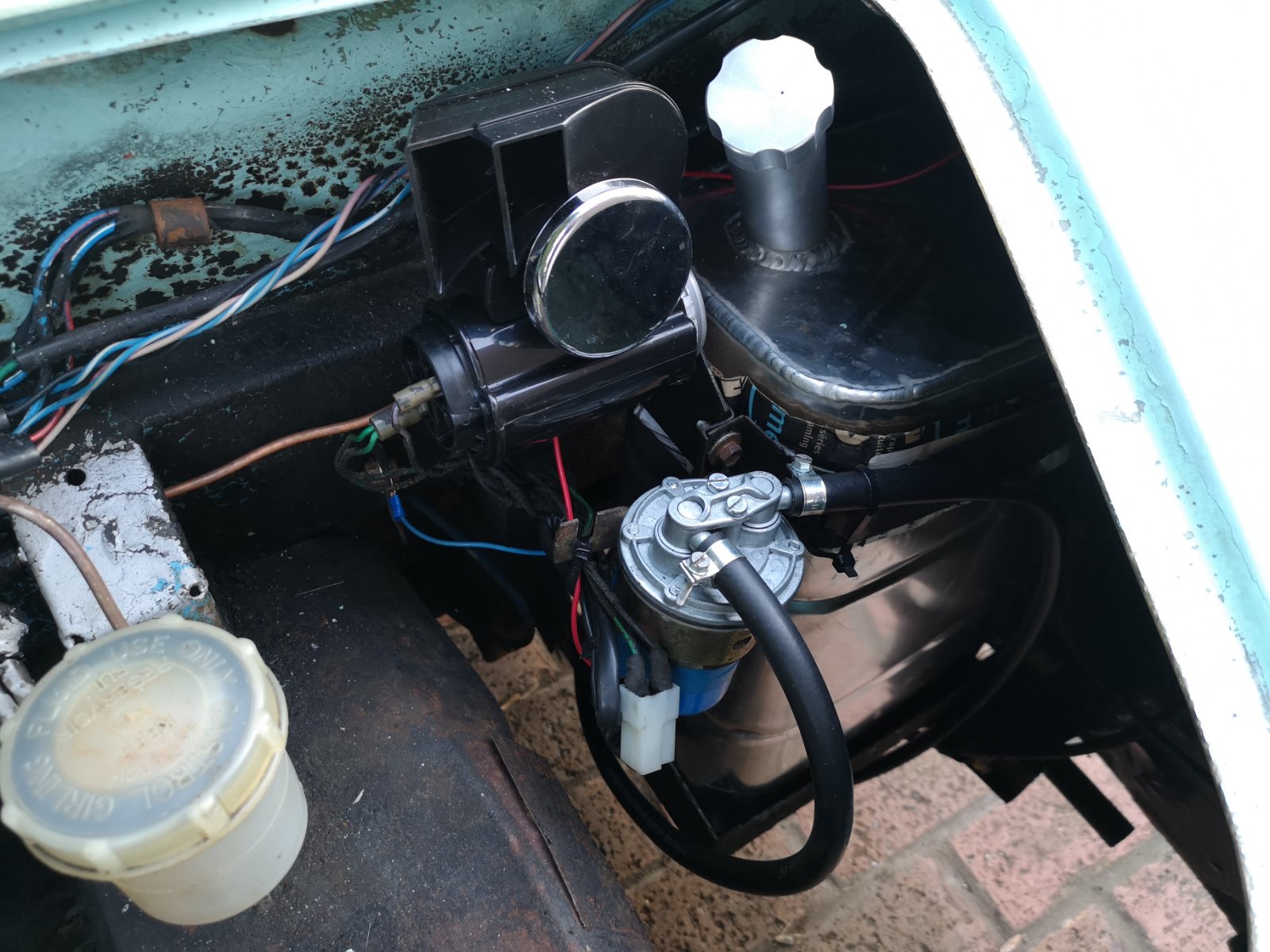

Having the electric fuel pump in hand meant that I could start doing a bit of investigative work on TP's fuel system. Step one though was to test the pump and to run a bit of clean fuel through it first, as I've no idea when it was last used nor what it last pumped. Not too much gunk came out really which was good to see.
Attaching it to the car however did pose a bit of a problem. Connecting it directly in place of the original fuel pump was going to be a bit tricky on account of the hose connections on the electric pump being 5/16" rather than 3/16" like on the original. However the tank outlet is 5/16" and I have a reducer up front changing it down within a couple of inches of the tank. So it makes sense to just plumb it in up front - which is where I've generally seen electric pumps installed anyway. Can plumb the existing tank outlet to the pump, then the outlet onto the existing reducer. Annoyingly I don't have quite enough 5/16" hose to sensibly position the pump, so I'll need to go and get some tomorrow. I basically want to hang it from the top tank retaining strap in the front compartment - currently it's cable-tied to the nearest chassis rail.
In the engine bay this left me with a slight quandry as well - as I needed to join the two bits of hose that were the pump was bypassed - however I didn't have a joiner specifically that size anywh...Wait...I think I know exactly what will do nicely.
Going back about a year, one of the things I remembered happening when I was starting to contemplate the fuel injection conversion on the Lada was that the fuel return hose connection barb pulled out of the carb body when I attempted to disconnect the hose from it. The bit of my brain centred around improvisation figured that this would probably make a perfectly good hose joiner if I could find it. Thankfully this didn't prove difficult as I'd stuffed it back into the carb before dumping that in the box of "leftovers" from the injection conversion.
This indeed did the job nicely, and allowed me to tether everything to one of the support struts in the engine bay.
Obviously I'll do some proper hose trimming and rerouting if I stick with an electric pump long-term, but this will do just fine for testing purposes.
Initially running things up hasn't shown any evidence of air being drawn into the system with the engine having run for 30 minutes or so. I have seen the occasional bubble *leaving* the fuel filter, but nothing on the inlet - so this must this is just a certain amount of fuel evaporation taking place within the filter housing itself. It is just the occasional one too, rather than a pretty steady stream we had before.
I'll get some more hose tomorrow so I can secure the pump in a slightly less dodgy way, then will look to do a bit of a road test to see if there's any noticeable difference in behaviour.

Zelandeth wrote: 19 Feb 2019, 19:41
Could this be the cause of the bubbles you saw with the mechanical pump, which probably transfers more heat to the fuel?
OnlineZelandeth
- Posts: 5310
- Joined: 16 Nov 2014, 23:36
- x 1597
I don't think so, there's an order of magnitude less of them now and they're only visible on the the outlet, there's a totally solid column in the inlet, whereas there were clear gaps in the fuel delivery at both sides. The other difference is that it's only visible at idle where the pump is only pumping once every few seconds - as soon as the revs and fuel demand go up it seems to behave - whereas it kept playing up before.
I think the real test will be tomorrow when I take it out for a run round the block and see what happens...

Perhaps not likely to be an issue here, but it is not usually a good idea to site the fuel pump significantly above the bottom of the tank because of the risk of vapour lock in the suction line.
OnlineZelandeth
- Posts: 5310
- x 1597
The pump is a bit higher up than I'd ideally like, but it's just a matter of "that's where the things I can easily attach it to are" at the moment, especially bearing in mind it needs to be kept the right way up. I'll be more inclined to drill holes for brackets when I'm not using borrowed hardware.
I then went and gave it a blast round the block a few times.
Usually after this I'd be starting to find a loss of power and the filter would be visibly empty save for a tiny splash of fuel.
That's a bit better...no bubbling visible today at all.

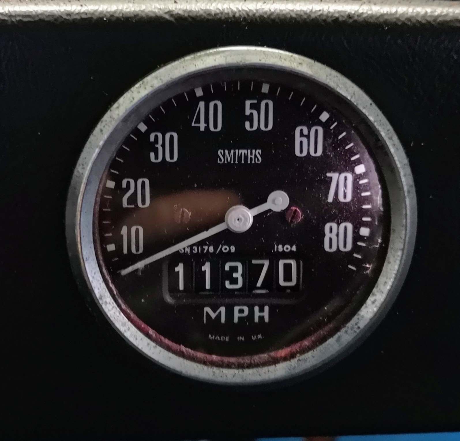

End of play today we have this on the odometer...
That's another five miles covered for those playing along at home. Would probably have been more actually as mechanically things were going just fine - however the indicator stalk decided to part company with the handlebars.

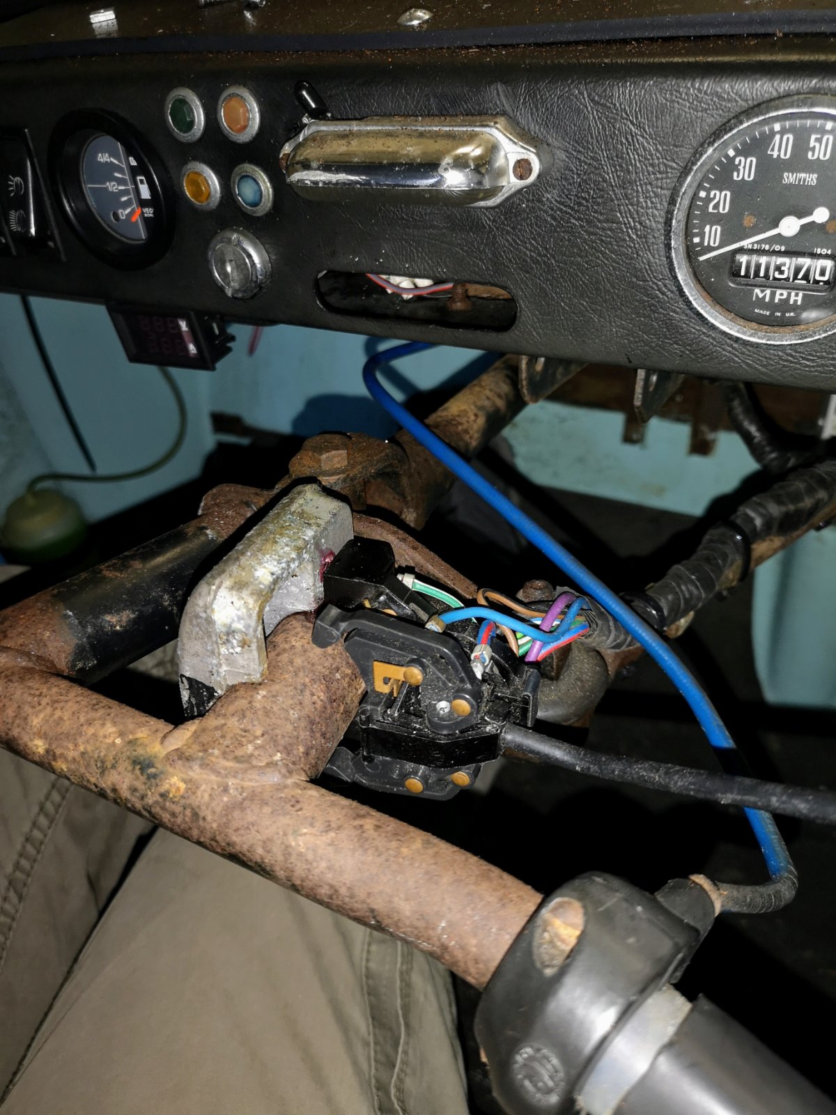

One of the screws landed in my lap, the other however ended up on the floor and was long gone by the time I got home, probably escaping via the gaping chasm at the bottom of the doors. So had to go digging in the drawer of random fasteners to find a replacement and put it back together...
...This time sticking a load of threadlock on the screws. If it comes off again I'm resorting to the epoxy.

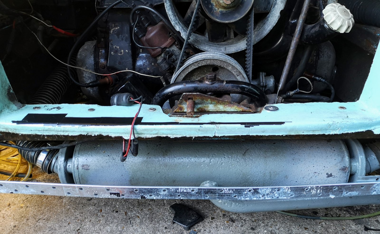

While I was doing that I rerouted the throttle cable a bit so that it was less in the way of the indicators. That proved to be a bit of a problem before, especially once the stalk got slightly loose and started wobbling around.
I made an executive decision though and forced myself to do some actually useful work with regards to doing a bit more of a permenant repair to the largely missing bits of body.
Off with multiple layers of duct tape and a large chunk of the metal frame which I deemed to be overkill.
Interesting that it looks like the nearside of the exhaust has been running cooler, I'll make a point at doing an actual measurement of the cylinder head temperatures after a run to see if there's an obvious disparity between the two.
I've just left the one band along the lower edge to help the resulting panel retain a decent degree of rigidity. The original panel would have had a lip moulded into it to help with that, but that's kinda hard to do by hand...so a bit of metal strapped to the back will do.
I then got the foam core board out and set about fabricating a new rear bumper. I love this stuff...It's got way more strength to it than cardboard, doesn't go soggy if it gets wet, but you can easily cut it with a sharp knife and bend it by hand.
Of course I ran out of daylight halfway through this, but this was the end result of the construction of the base framework. Trying to get photos of a semi-matt black surface with little ambient light was a bit tricky, but hopefully you can see that there is something like the shape of an actual lip below the engine cover and a bumper here now.
While I was rapidly running out of time by this point I was determined to get at least some fibreglass laid down over this. I only had a couple of small bits left from the current pack of matting anyway, so figured I'd just use that and then call it a day. This is where we left things.
Don't worry about the bits dangling down under it, that will get a nice clean edge cut in due course. I've realised quite a few errors in my workflow working with the fibreglass here, and that one of the key things to make your life easier (especially when working on vertical surfaces like this) is to work with small pieces of mat at a time, or you end up with finely atomised bits of glass fibre stuck to everything except the surface you're trying to stick it to.
Once I've got a few layers on here though, a skim of filler and some paint on it I reckon we should be able to get a result which should be good enough. I'm not worried about a perfect factory finish here, "presentable from ten paces" will do just fine. A slightly junior level looking bit of fibreglass fabrication is less likely to get me pulled over by a grumpy traffic cop I reckon than having half of the rear of the car made of duct tape.
The only other thing I immediately need to get the fibreglass on will be the mounting points for the front cover hinges, as the cable ties can't stay there long term...

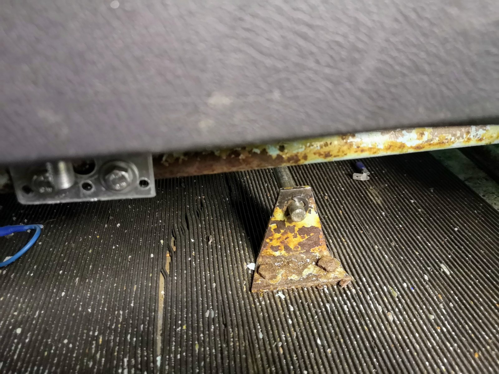

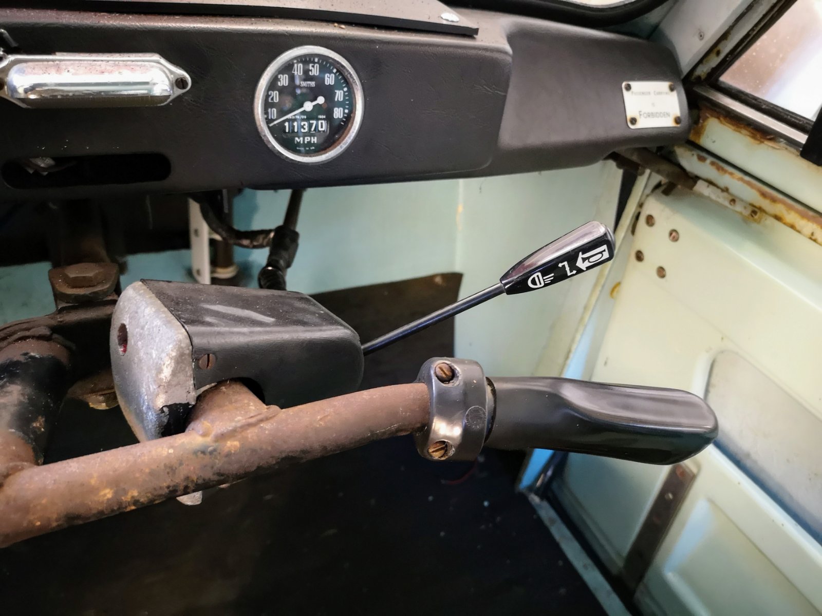

Number one went on this end of the gear selector rod to stop it from falling out of the bracket.
There's also been another attached just behind that bracket to prevent the whole lot from being able to wobble from side to side - important as the handle is really quite close to the seat frame and I don't want to have it touching the frame and causing yet another rattle or buzz in the cabin.
I'll take it out at some point and bend the handle away from the seat very slightly, but that's very much on the "it would be nice to do some day" list rather than anything which needs immediate attention.
The second missing circlip has been added to the seat belt buckle to stop the bar in the middle of it from being able to fall out.
This was never a problem when the belt was actually in use as the tension on everything held it in place - At least I don't need to remember which way to hold it when taking it off now though.
Only other task which has been done was to reattach the front cover. This had previously been held on with cable ties through the bolt holes, but is now properly attached.
Not really much to be said about that! It is nice to have it done though, as I think having eliminated the cable ties - much like the rear valance - helps make the car look more like a car that's actively being restored rather than a wreck beyond all hope.
