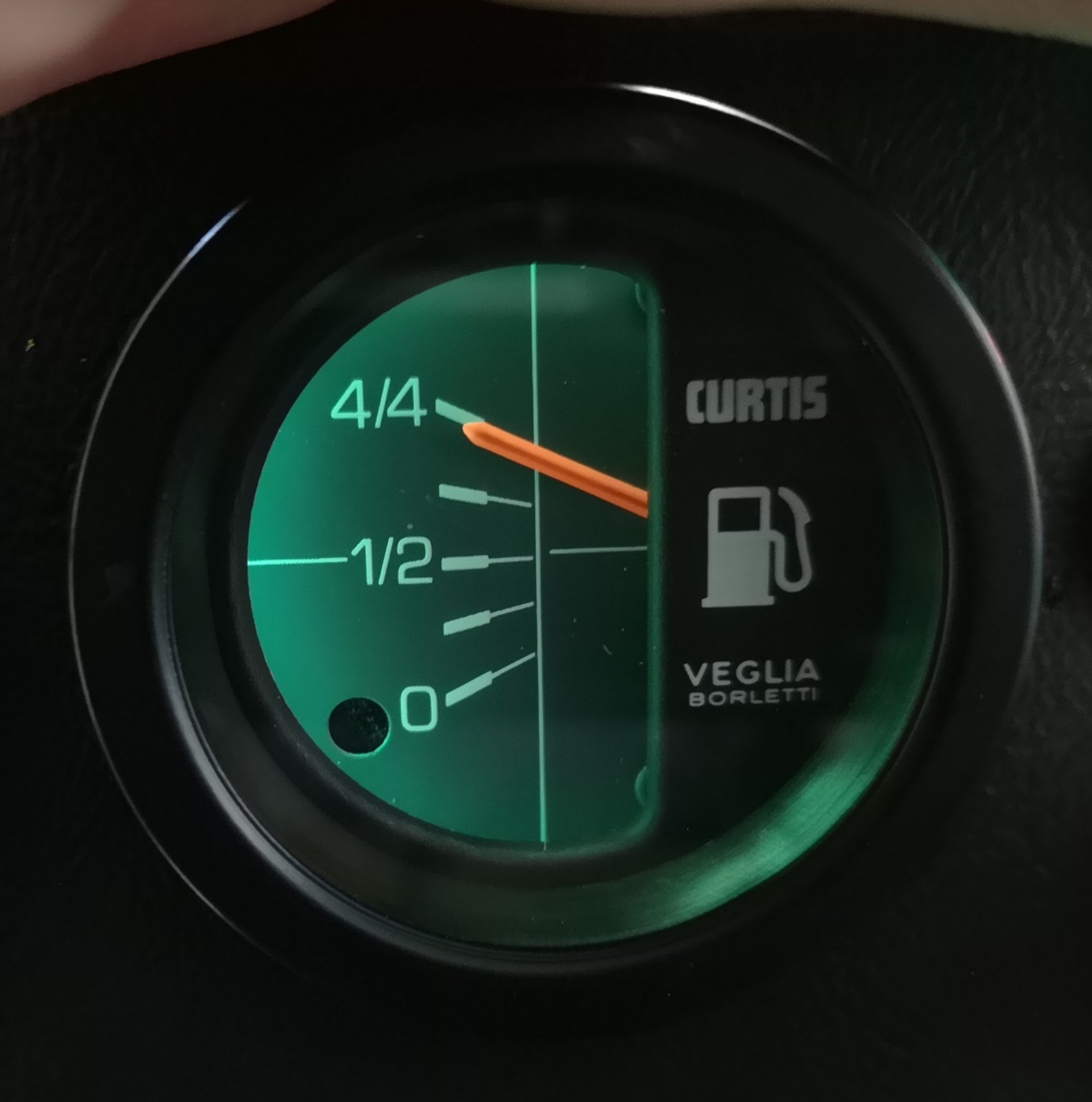

[] Fuel gauge. As mentioned before, the sender I'd fitted was for the later Curtis/Veglia gauge, so have no reading on the old Smith's moving iron gauge. With my meter I was pretty quickly able to figure out which wires were what, and made up a jumper for the ground connection (through the case on the old one, which is isolated on the new one).
Was my guesswork right... let's see...
Yep! That's exactly how much fuel is in the tank. This gauge is damped, so rocking the car only resulted in a tiny amount of gauge wiggling, but it definitely did move. I'll have to wait to see how accurate the tracking is as the tank is used. There's no wire in the original vehicle loom for the warning light, so I'll need to route a new conductor for that at some point. That isn't a priority though at the moment. If I'm smart, I'll ignore that until I get around to pulling the dash to properly repair a couple of ancient wiring bodges back there and to add some mommon sense stuff like relays.

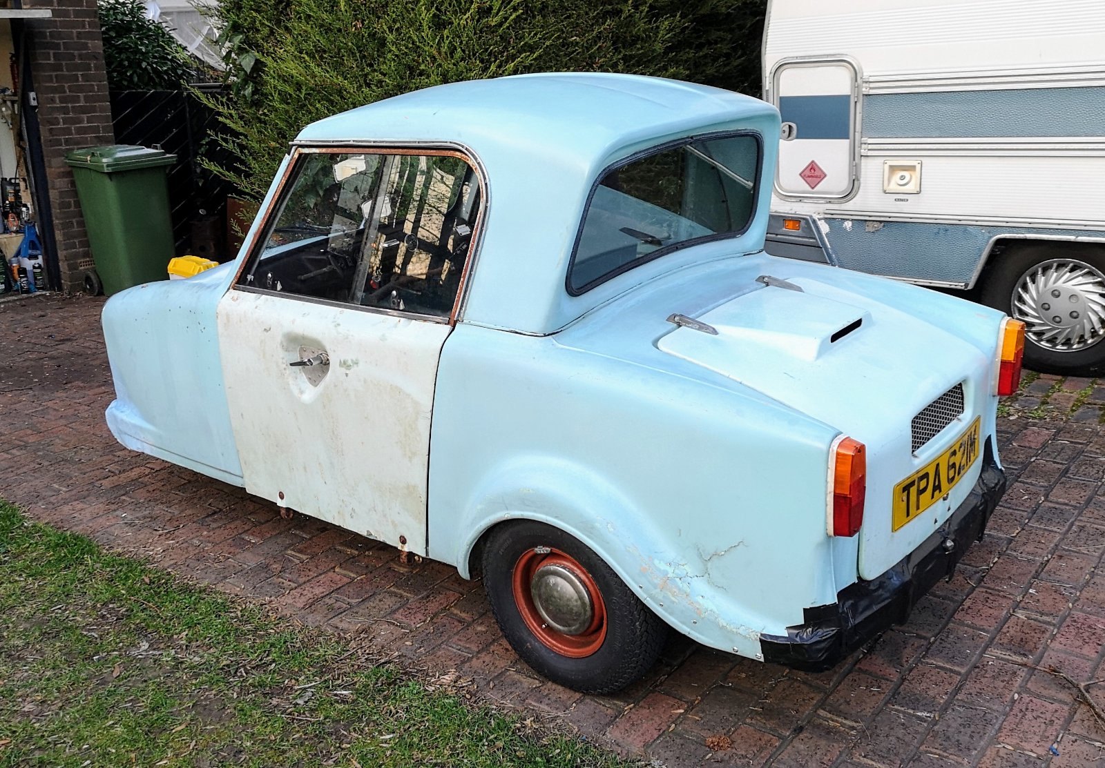

Let's have a quick recap...
Here's how TP was looking from the rear when she arrived in my driveway (more or less)...
Fast forward to a week or two back...
Bringing us up to date, here's how things were looking as of close of play today.
Now this isn't exactly a work of art, but I think I'm within my rights to declare this to be a big improvement.
Obviously there's a load of filler and sanding to be done yet. The very quick blast of paint over the surface was purely to allow me to see properly how close or not I'd got to the contours I was aiming for. It was quite hard to tell in bare fibreglass.
I forgot to take a photo of it, but I've also filled the holes in the front panel. My solution to this was to stick a duct tape patch loosely to the underside of the panel, creating a pocket into which I could pour some resin - filling up the pocket, and then used some glass fibre tissue to patch the outside. This won't be as strong as it would have been using actual matting, but it's not subject to any real load so should be fine. I reckon the only reason the hinges have been ripped out here is that the lock had seized and someone decided they wanted into the hatch, so they used brute force.
I've also reattached the lower door seal on the nearside which will hopefully slightly reduce the draught level in the cabin.
Bodywork wise I think the next thing I'm going to do is a slightly better securing solution for the transmission access hatch, as it has vibrated itself completely loose again during the last trip. I don't like the little springy clips they've used there - they're fine for securing bits of trim, but something that big and heavy is less than ideal. I'm going to get a few bits of steel bar, rivet them in place over each hole through the panel, then drill and tap a hole through that - I can then use M5 machine screws to secure it - and bolts for the bottom ones which are awkward to get a screwdriver at becaues of the driver's seat being in the way. Will take a couple of hours to do, but should save me a lot of faff long term.
I think it's when you start thinking about that sort of detail that you realise that you've pretty much comitted yourself to a car being a keeper...
