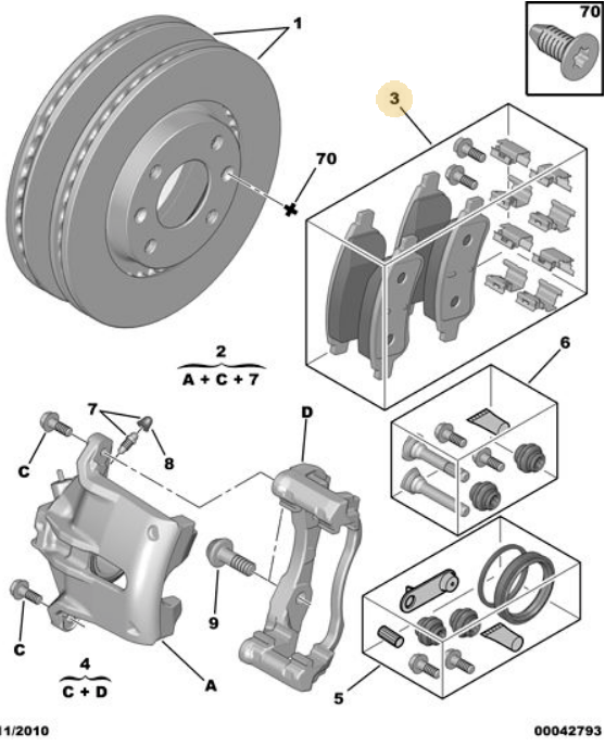

Re: 207 Front brake caliper question
I certainly would not recommend ECP for parts lookups - they are invariably wrong as has been commented by many members, myself included.
Always best to get proper OEM part numbers first, then you can cross reference. There are a lot of aftermarket parts databases that are simply inaccurate and do not account for model variations.
As you can see there are various repair kits for your 207:
(3): BRAKE PAD KIT
(4): BRAKE CALIPER YOKE
(5): BRAKE CALIPER REPAIR KIT
(6): SET COLUMN SCREW
If you want part numbers for any of these, shout.
(3): BRAKE PAD KIT
