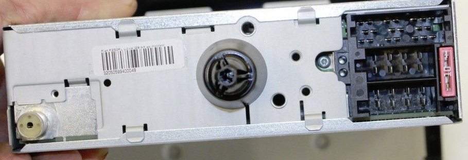

Ok, so there are only 2 fuses related to the audio system that I can detect oin the vehicle network and 1 fuse in the back of the unit itself. The vehicle fuses are both on the BSI.
There is a 10A fuse on the back of the unit which I would check first of all:
BSI: F49 (5A) (Parking assistance ECU, Audio system, Controls at the steering wheel, control panel, Battery cut-off ECU), so should not be this if your parking assistance is working ok.
