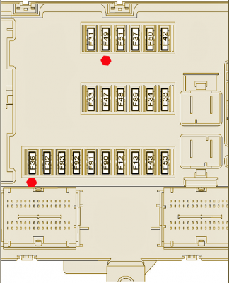

Ok, so there are only 2 fuses related to the audio system that I can detect oin the vehicle network and 1 fuse in the back of the unit itself. The vehicle fuses are both on the BSI.

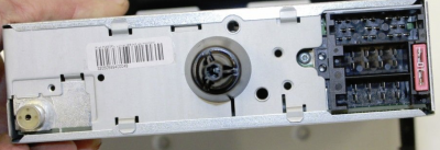

There is a 10A fuse on the back of the unit which I would check first of all:
BSI: F49 (5A) (Parking assistance ECU, Audio system, Controls at the steering wheel, control panel, Battery cut-off ECU), so should not be this if your parking assistance is working ok.
BSI: F36 (10A) (Audio system, Air conditioning control, Alarm, Tachograph, Battery cut-off unit, Webasto Timer).
On this vehicle the BSI is located on the right hand, not the left.
BSI Fuse Diagram - I have highlighted the fuses with a red marker.

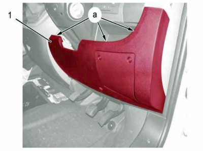

| It may not be necessary, to gain access to the fuses, but if it is, then also
