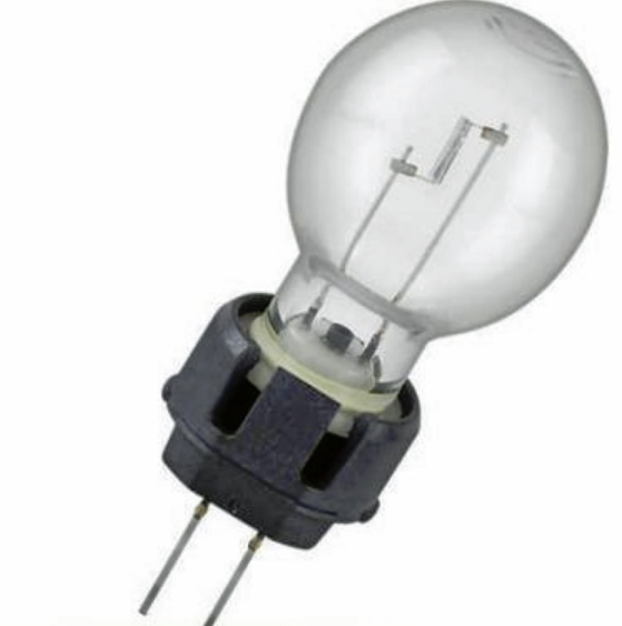

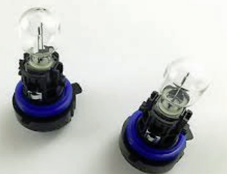

If I were using a PCB, I most likely would. These particular DRLs are just like the G4 Halogen Steve, having long pins that go somewhat to support the bulb in the holder. When upgrading these, we have to actually separate the bulb from the neck shown in the picture below. Once this is out the trick is to secure the generally 'thicker' body of the LED into this crown and then mount the crown into the bulb holder. As each LED is different in construction, they will be of different thicknesses. so a combo of trimming / shaving the innner neck to all ow the LED to be inserted, but tight enough that it will support it.
So there isn't any circuitry in the neck itself, it just needs to be non conductive. There are probably half a dozen designs of LED equivalents so will be a custom solution I suspect for each.
Original Bulb & Neck Removed from HolderOriginal Bulb in HolderTypical LED Replacement

Wish I had taken a photograph of mine as it has a different neck, which fits snuggly into the bulb holder. Hence looking at silicone rubber compounds they would appear to be the solution.
Kenny
