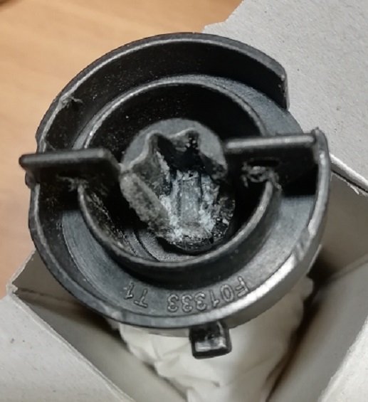

Hello All,
Happy new year to all, now to the problem/ issue.
Just changed the DRL's on my C5 x7 checked they were working and refitted bumper( Make: Lumro)
Next day nearside not working,before I had to remove bumper again enough room for my hand to reach bulb holder and moved it slighty bingo working again. I did notice it would turn and bulb would go off and on depending how far it was moved.
Did an oil change moved vehicle both working still, when I moved it back offside not working tried to do same as before but no success.
My thoughts are the fit my not be as tight and the connection is not be made very well.
Thoughts please.

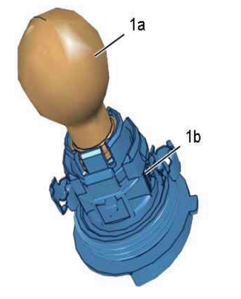

AS I'm sure you know Kenny, these HP24Ws have a quarter of a turn lock, which is what makes the little sods so hard to get out in the first place, along with the tight seal.
So as far as the replacement is concerned, have you bought a complete unit with the holder, or just the bulb and separated it out (even though officially they say it cannot be done)?
I ask because when I upgraded mine with high powered LEDs, I had to modify the base holder to incorporate the LED bulb and ensure it was a tight fit in the holder.
If you have not bought an official bulb or bulb and bulb holder unit, the contacts may not be as per the original giving the intermittent issue, or as said previously, it must be locked for that quarter of a turn to engage the contacts.

Thanks for the reply Marc,
I have separated the broken bulbs from theirr holders. I inserted the led lights into these holders as a set of spares.
I fitted the lumor replacement units, bulb and holder. They were given a 1/4 turn when fitted.
How did you fit the LED bulbs into the holder?

Once I removed the bulb carefully from the plastic collar tags, I had to manually grind down the plastic vertical pieces that support the bulb a little at a time until I got a nice tight fit. I used a scalpel type blade to be able to trim thin layers off.
It meant carefully sinking the 2 long wires of the led into the holes of the holder, but not pushing too hard as the pins are slightly narrower than the holes. So it was a balancing act to get the pins in and the bulb wedged in nice and tight so that it wouldn’t move or come out with the car movement.
I must of done a decent job as they are still working

Well the bulb had blown after 2 days!!!!!!!!!!!!!!!!!!!!!!!!!!!!!!!!
Fitted the LED bulbs instead and still working.
Kenny
Kenny
