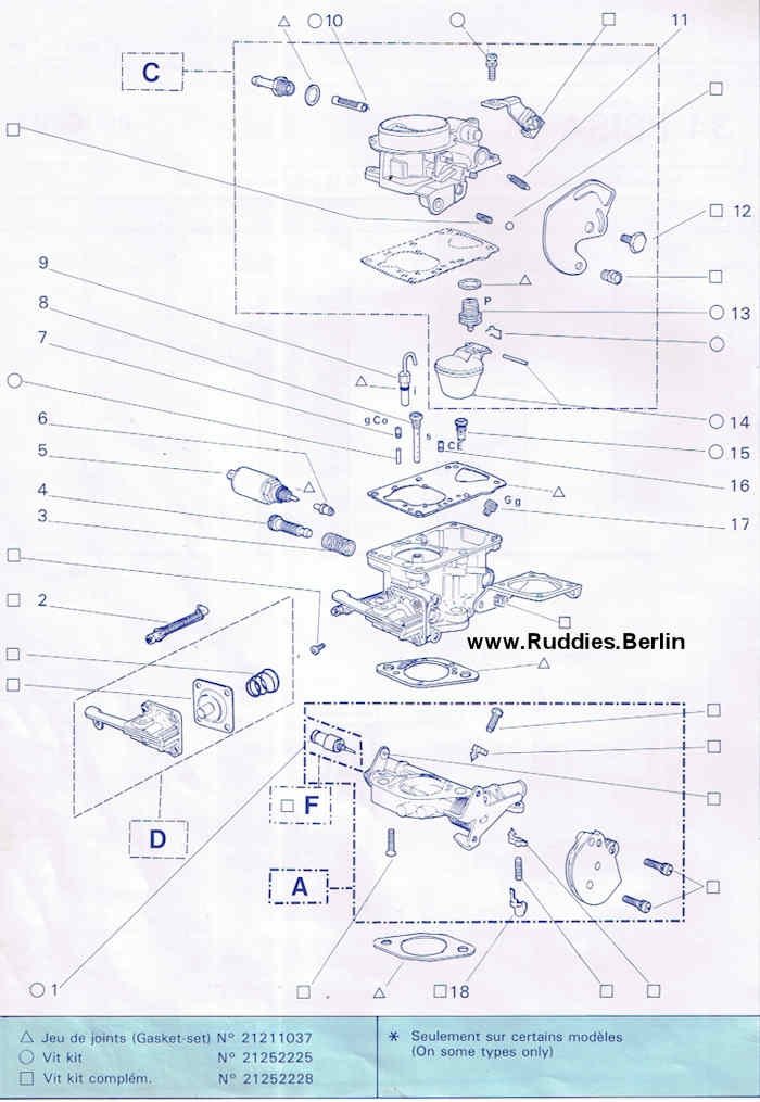

Purely to assist anyone trying to work out what the problem might be - here's a couple of diagrams of a 34 PBISA 16:
34 PBISA 16 #1
34 PBISA 16 #1
34 PBISA 16 #2
34 PBISA 16 #2
Images taken from https://www.ruddies-berlin.de/34PBISA_PEU.htm
Reading on another forum about a similar Solex problem, they found that the bent pipe at #9 in the upper diagram was missing from theirs. What it attaches to was still there, but the pipe had made a successful bid for freedom.

That's the jet for the throttle pump, it is there and squirting fuel ok when the throttle is opened, diagram is handy, just trying to get the plugs out now
