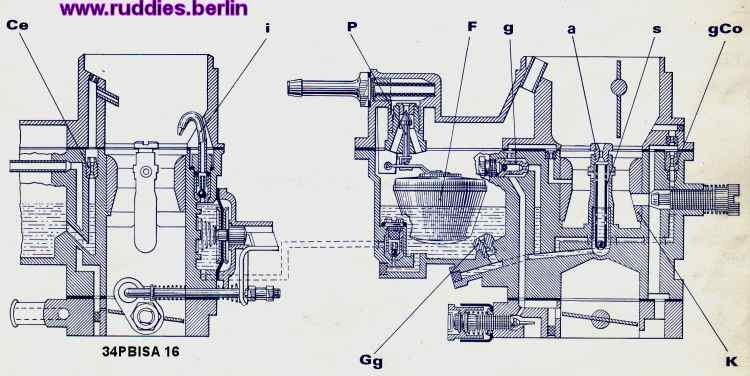

Purely to assist anyone trying to work out what the problem might be - here's a couple of diagrams of a 34 PBISA 16:
Images taken from https://www.ruddies-berlin.de/34PBISA_PEU.htm
Reading on another forum about a similar Solex problem, they found that the bent pipe at #9 in the upper diagram was missing from theirs. What it attaches to was still there, but the pipe had made a successful bid for freedom.

That's the jet for the throttle pump, it is there and squirting fuel ok when the throttle is opened, diagram is handy, just trying to get the plugs out now

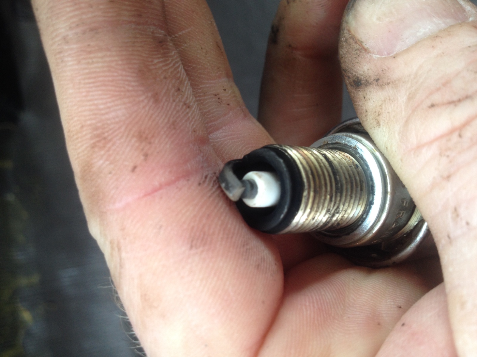

Here are the new plugs after 400 miles, looks lean, the soothing could be because I was running it on choke coming home yesterday to keep the temps down, time to look at the fuel pump next.....

For someone who claims to know nothing about carbs you are going in the right direction! Running hot can be a sign of lean, and also over retarded(?) timing - but making it go better with the choke out, certainly points to a fuelling problem. The mixture screw only adjusts the mixture at idle - once the main butterfly opens the mixture is determined by the fuel level in the carb, and the main jet. This carb was widely used - my VISA has a 32 version on it. Did the carb look like it had been messed with before you had it off? Could someone have fitted a carb from a smaller engine; or even the wrong jet (no idea how you would tell!!). Has it got a fuel filter, and have you changed it?
