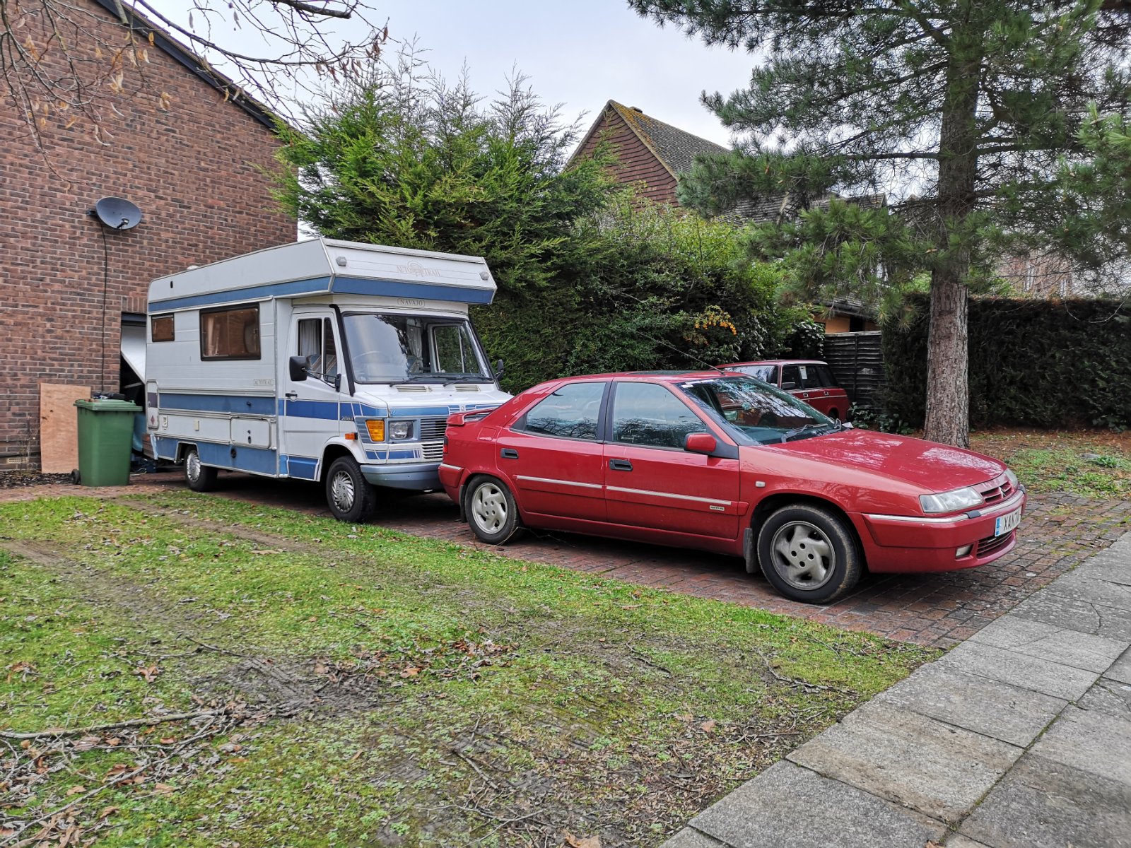

One of the main things I wanted to get done today was a driveway rearrangement. This would get the Activa off the lawn, Lada off to one side, boxed in by Chris' modern company car overnight, and the van boxed in by the Activa overnight. Also means that I won't keep having to ask people to move their cars for me.

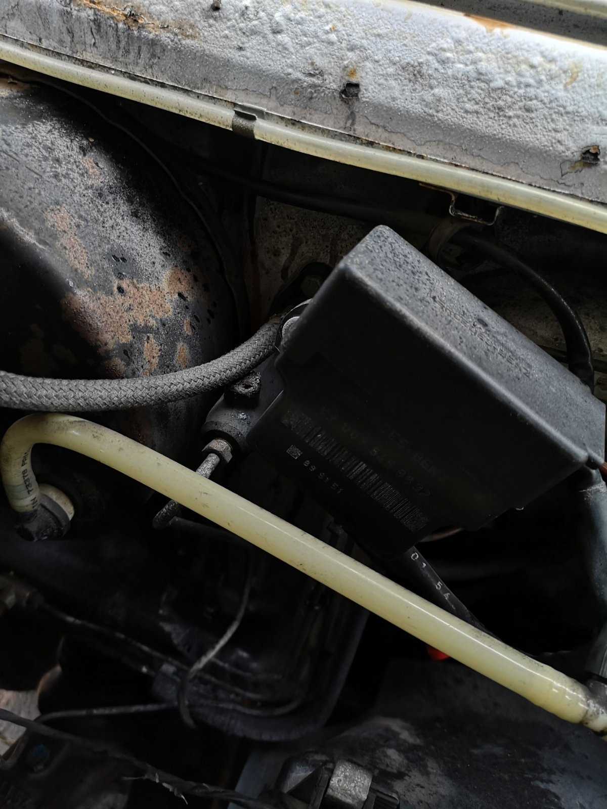

First though I needed to properly bleed the clutch on the van as I was sure there was still air in it. This was a simple one...two minute job. However the pedal was still "sinking" over time - and with your head buried in the footwell you can hear the clutch pedal "hissing" as this happens. Oh well, looks like I need a new master cylinder as well then. Not the end of the world, will get one ordered. Access predictably is fine to change it.
Having bunny hopped my way out of the drive I was able to stick the Lada off to one side and put the van where I wanted it...and answer the question nagging at the back of my mind...do I actually have enough space to get a car, the van and still open the garage door?
Just!

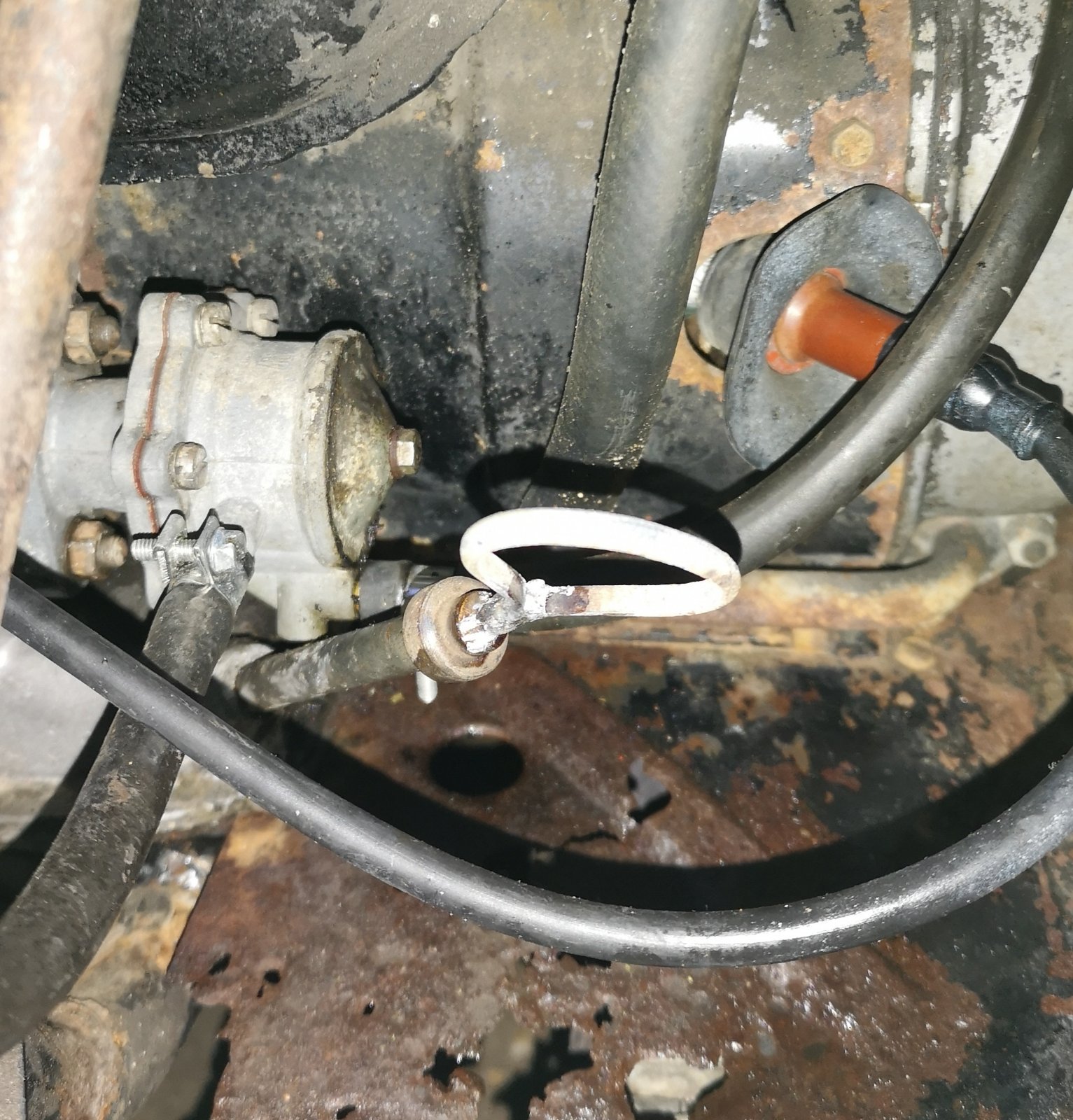

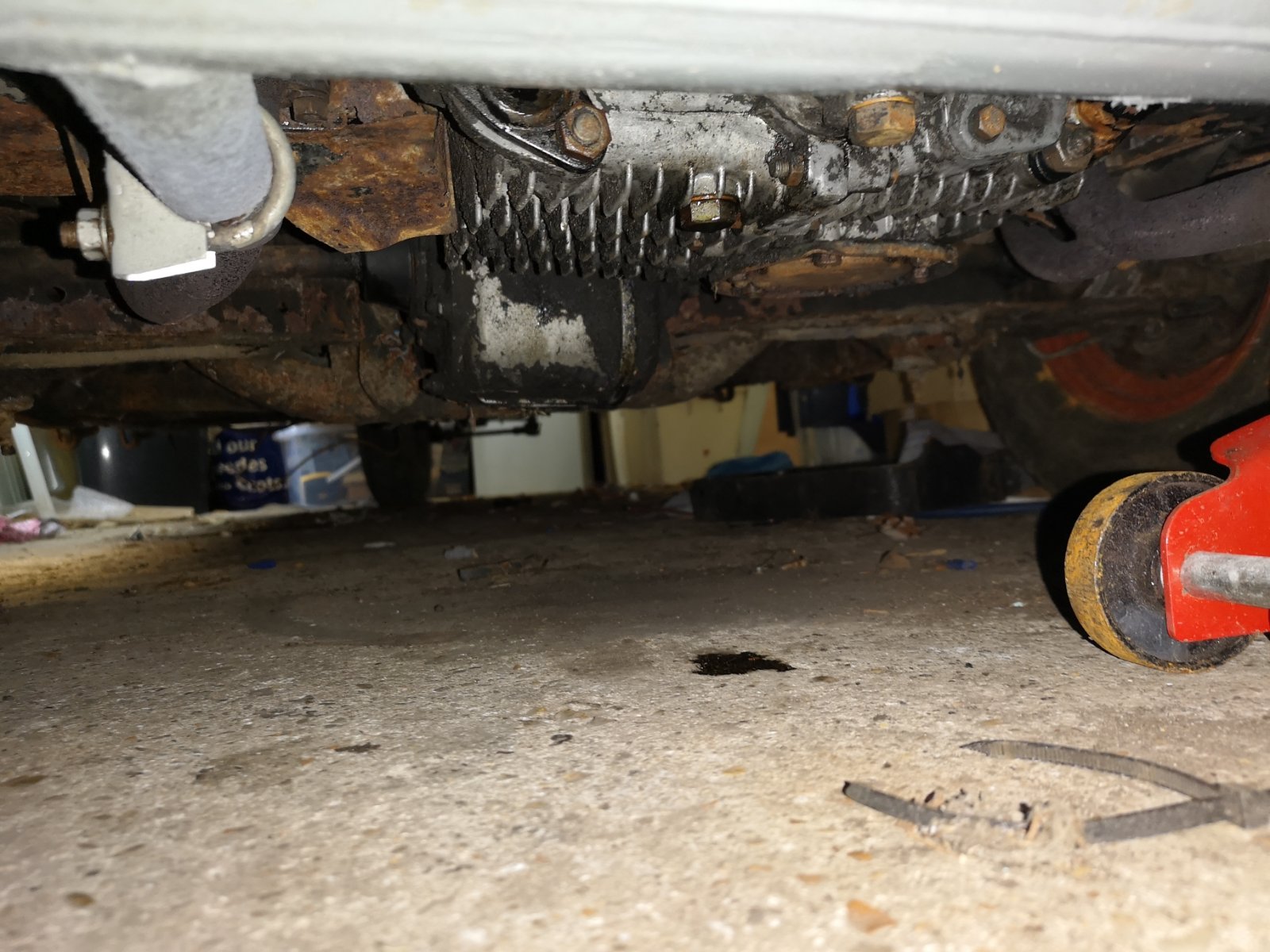

Last task for the day, something on the Invacar. Today's task being to sort the main oil leak. This was a bit of an odd one as the cause was the dipstick.
The way this is constructed is that the cap has been brazed onto the rod that makes up the dipstick, which is doubled over to make the handle. The issue I had was that there was obviously a pin hole down the centre of it, and due to the bottom of the dipstick tube being below the oil level in the sump it would "bleed" whenever the engine was running.
After half an hour and the messiest bit of brazing in the history of the world, this was the result.
Engine has actually been running for about 20 minutes there, and no sign of seepage... I'll take that as a win. All the oil on the tinware by the fuel pump is from this leak historically.
The only other leak is this one...
Which is coming from the sump drain plug, just a new copper washer needed hopefully.
Was quite nice in that when I left it sitting on a fast idle for twenty mins or so to check for oil leaks, then opened the door and the cabin was toasty warm...the heater does actually seem to have an effect on the cabin.

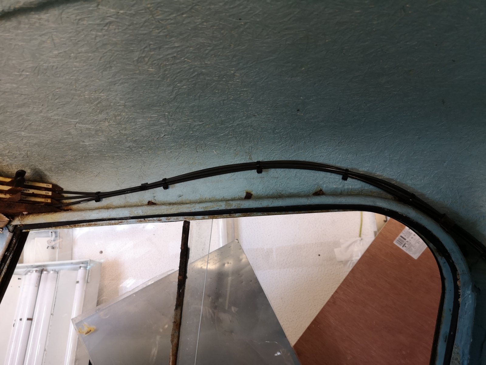

Oh, and someone asked me how the door opens/closes on the Invacar, so here's a quick demonstration.
Simple but effective - and I think a solution which saved them from having to provide something heavy duty enough to anchor normal door hinges to, as the "hinge" is effectively attached directly to the chassis. The door stay is attached to the dash support beam.

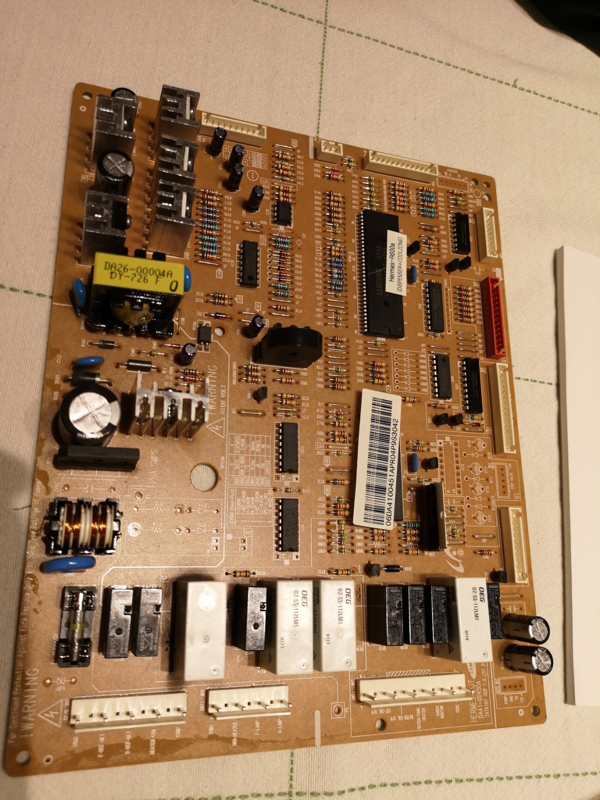

Well this evening had a bit of excitement.
Noticed early on that the fridge didn't seem quite as cool as it normally is... wasn't sure if we were imaging it though. However a quick check soon revealed that it wasn't cooling.
Of course this time of year the fridge and freezer are full to bursting. Cue frantic shuffling of everything into our old fridge (the huge double door American style thing in the kitchen came with the house as the seller couldn't fit it into their new house), the chest freezer in the garage, and some overflow into the fridge in the van which is also now cooling.
Cue 30/70% response between "argh, broken thing..." and "yay, an engineering challenge!"
Okay...so quick assessment. No cooling, internal circulator fans running, condenser fan running, compressor not running.
Lower rear cover off (no idea why I keep putting all eight screws back in given I have to take it off every couple of months to clean fluff out of the stupidly designed condenser), compressor is stone cold. All the starting kit and protection circuitry is built into a block on the compressor, only wires to it are a switched power line and a common ground. Initially I wondered if it might have a stuffed start/run cap, but stone cold compressor suggested otherwise.

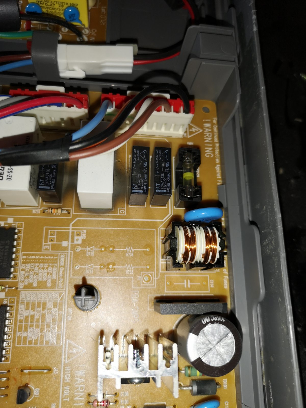

Quick check, no power getting to it. Now this being a modern unit, it's not just a thermostat and a compressor...there's all manner of microprocessor nonsense involved. Despite this though I was pretty sure that there would be a relay involved in the actual motor control for the compressor. Time to dig into the brains of the operation.
Well...what then followed was a twenty minute argument with the metal cover on the electrical enclosure on top of the fridge. Daft design which consists of two screws on the one side and two totally inaccessible clips. It eventually succumbed to my will when I made it clear that I wasn't *asking* it to open.
Immediately obvious when the cover was opened was the unmistakable whiff of fried electronics. Sure enough it seemed the magic smoke had escaped from something.
Didn't take long...hey look...one crispy relay.
Investigation showed the coil to be open circuit. A further bit of experimental poking, bridging out the contacts resulted in the compressor merrily buzzing into life. Didn't sound laboured or in any way unhealthy...so hopefully just a relay having decided that it's time had come. Two quid later and I've a new relay on the way.
I hate to think how many folks would have binned the thing for this and wound up paying out £800 odd for a new one. It's one of those huge double door American style jobs which cost a fortune for some reason.
Though I do have to ask the question of *why on earth* does a fridge need this much control logic?!?
Simple answer...it doesn't! It's downright ridiculous is what it is.
Hopefully the new relay will restore normality.
Seriously though, couldn't it have waited a couple of weeks?
