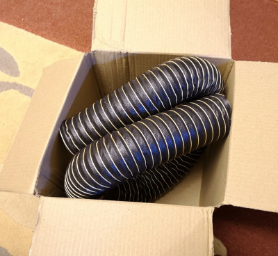

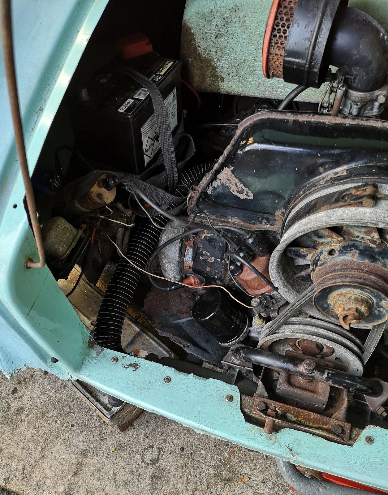

This little package arrived this afternoon.
Was a little tricky to tell from the sales page on eBay, but it does look to be a pretty much perfect match for the original heater ducting still present on the car.
Didn't take long at all to get the missing ductwork reinstated.

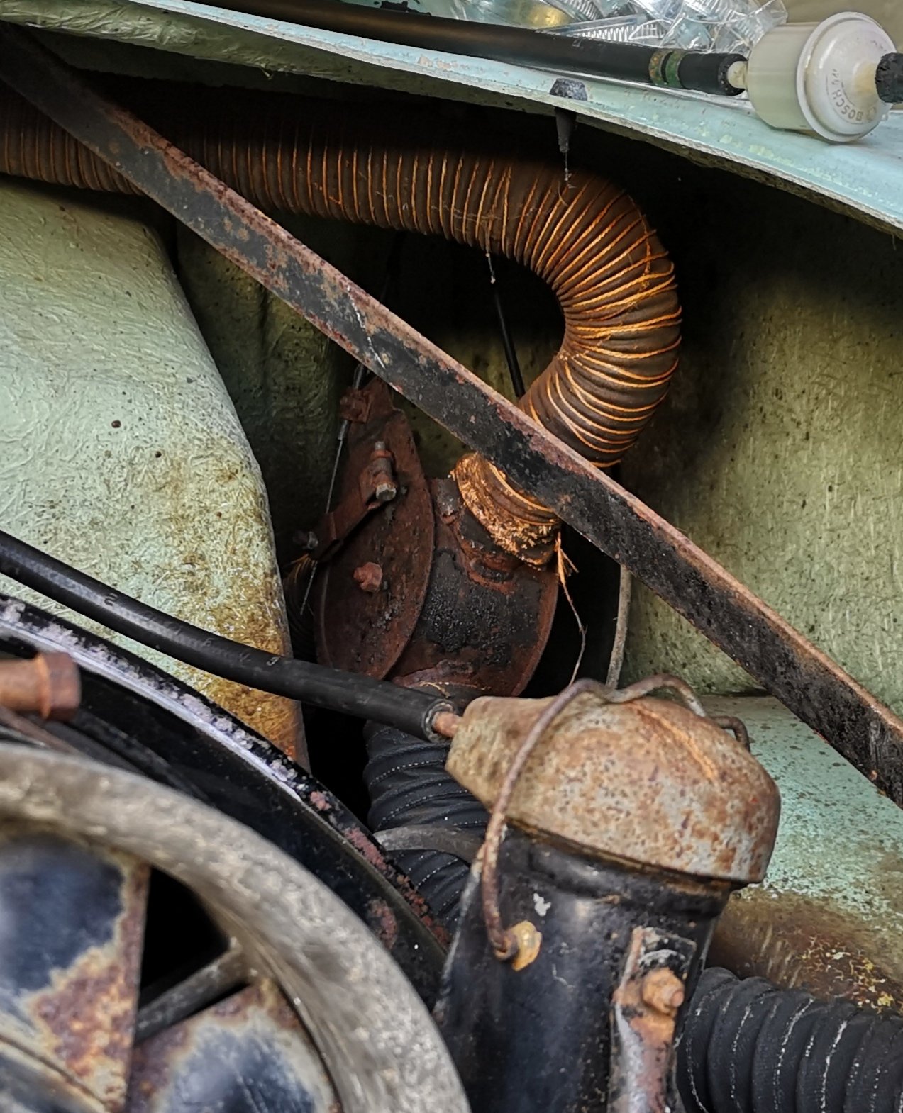

I think the original duct was actually routed up into the inner wing down behind the battery, coil and voltage regulator. However I can't really see any particular reason for this so opted for the more economical route which will get in the way less. Getting the battery in and out is already enough of a faff without adding any more congestion to that corner. It's not as though anything will get stretched like this as everything to which the duct is attached here is all rigidly fixed together.
When I first started my old VW T25 up after it had been left sitting for about ten years the amount of crud that came flying out of the heater vents was truly comical. I was expecting much the same here, however that wasn't the case. All we got was this little bit of foam out of the demister vent.
While there's good flow through the cabin heater vent, the windscreen demister is less impressive. It's quite likely the duct is still full of crud though, and the flaps in the control box are a bit stiff. I'll pull it out for a good clean, lubrication of the moving parts and a quick lick of paint at some point soon.

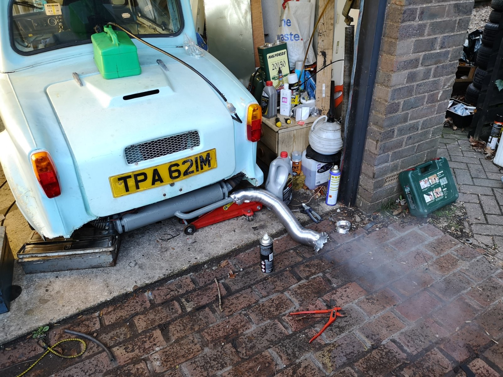

This is apparently one of the more difficult Invacar bits to get hold of, so I'm very glad that it's both present and in working order.
Don't worry about the lack of hose clips on the fuel hose you can see in the above image. That hose is literally just sitting in a fuel can at the moment as there's no tank on the car. The fuel system will all be properly sealed with appropriate fasteners when installed. I'm planning to get some marine grade fuel hose for that given the issue I've had with the stuff from pretty much any motor factors perishing in next to no time lately. At least this thing is a bit less of a fire risk than most Reliants as it doesn't have the carb hanging right above the exhaust manifold.
Given that I didn't want to play automotive Tetris, I wasn't really able to back the Invacar out the garage, so having it running long enough to test the efficacy of the heater meant I had to deploy my extremely technical solution for stopping it filling the garage with exhaust fumes.
The tailpipe on this thing vents directly out the offside of the vehicle rather than out the back, so if not reversed out of the garage it does a good job of filling the garage with exhaust fumes. This results in the lounge smelling of car for several hours afterwards...hence my having come up with a way to convince the fumes to vacate the premises. For all it's hilariously crude, it seems to work.
Speaking of exhaust fumes, I made sure to have a CO detector in the cabin during this test as the exhaust heat exchanger had never been proven before - glad to report that it never twitched during the test. I will fit one in the cabin as a matter of course though as it just seems a sensible safety precaution.
The heat exchanger actually seems to work very well. I was only keeping the engine at a fast idle, I imagine the exhaust will run far hotter with the engine under load. Even so, the air coming from the vents was positively furnace like. I'll tick that off as a result I think.

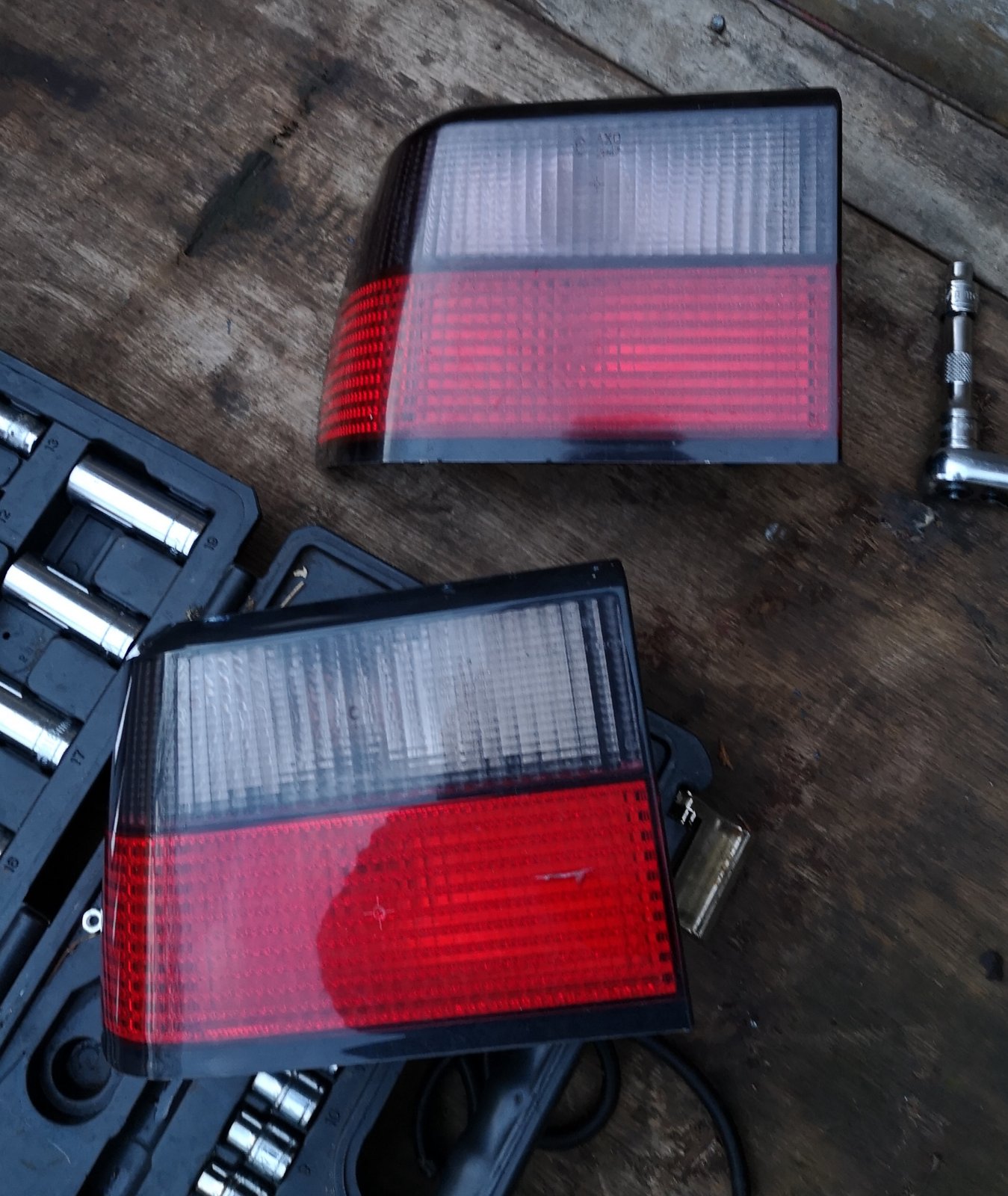

Before I packed up for the afternoon I finally got around to sorting one of the really minor issues I'd identified with the Xantia. The nearside outer tail light had a small crack in the lens. Not really an issue as it didn't let water in or anything, but I had a good used replacement floating around in the box of bits of Citroen, so seemed daft not to change it.
The seal on the back seems to be in far better shape than the one that came off the car too which I don't reckon can be a bad thing.
Nice when a 30 second job is actually as quick and simple as it should be.

glad to see the low-tech exhaust gas removal system Zel, my sort of solution
Puxa
Zelandeth
- Posts: 5328
- Joined: 16 Nov 2014, 23:36
- x 1607
Pug_XUD_KeenAmateur wrote: 23 Dec 2018, 19:52 glad to see the low-tech exhaust gas removal system Zel, my sort of solution
Think having been involved with Ladas in one way or another for the last 30 years has rubbed off on me! Basic but effective is usually my preferred solution.

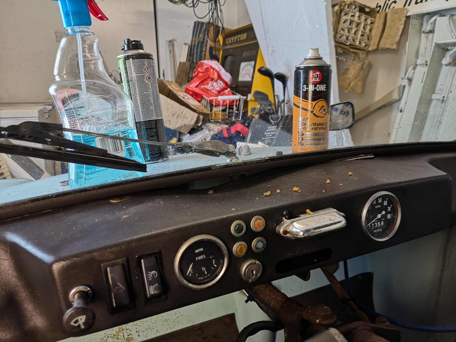

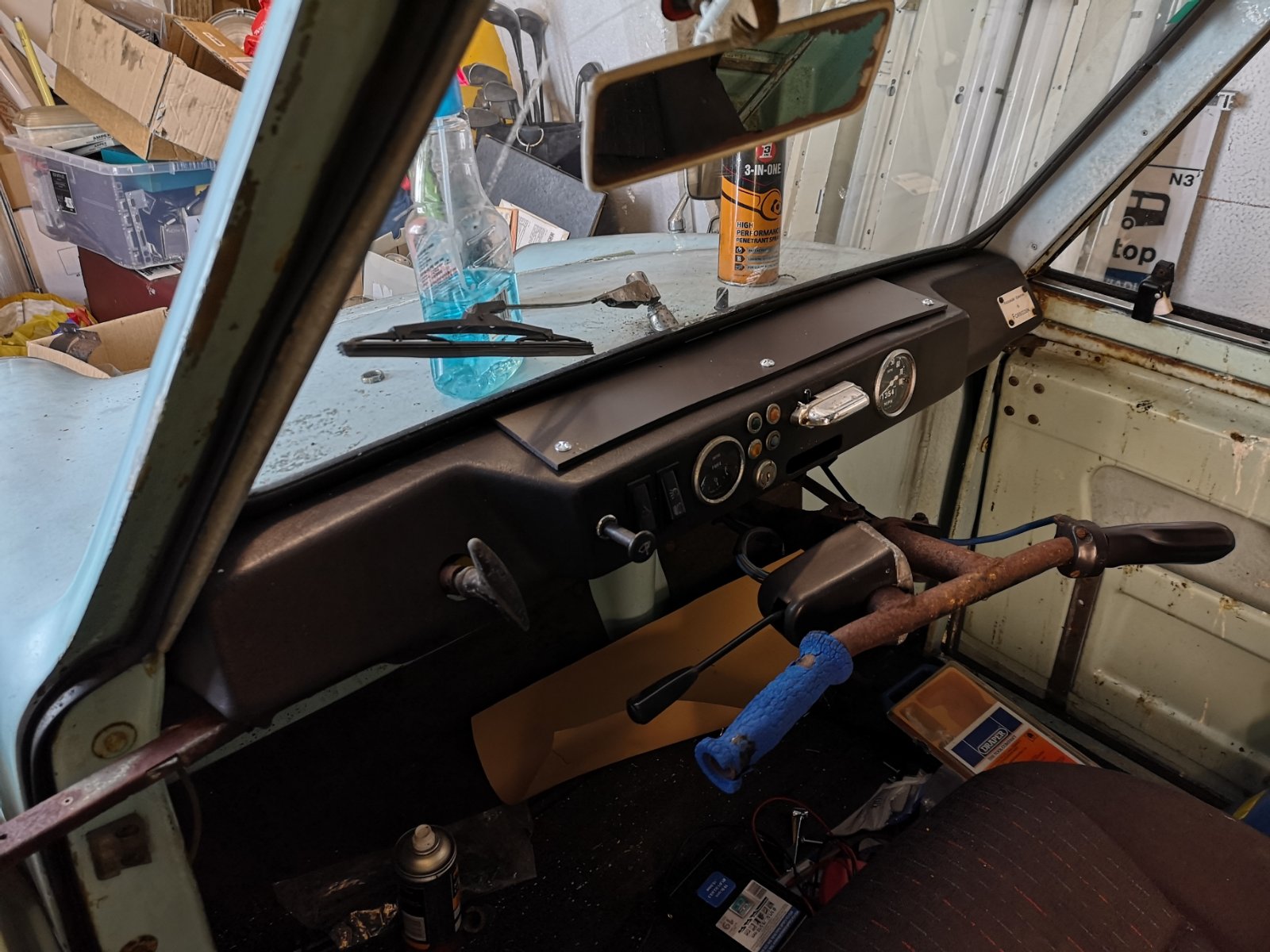

Today I could potentially have got something useful done...but me being me, ticking off a minor cosmetic job was my preferred option.
The gaping hole in the top of the dash being the target of this afternoon's attention.
Long term, taking the dash out and swapping it for the spare one I have is the proper solution. However between seized fasteners, the general fragility of the dash and the fact that everything on the spare dash will need to be swapped over, that's not a job I'm looking forward to.
Short term though it's time for a bit of a bodge.
Let's go grab a bit of Foamex board, cut it to size and bolt it to the top of the dash.
Not going to win any prizes for beauty, but to my eye at least it's less visually offensive than the huge split that was there before. It has also vastly improved the structural integrity of the dash. Operation of the switches for the headlights or wiper no longer makes the whole thing creak and wobble.
Surprised it's the first time I've used this stuff for anything on a car to be honest.

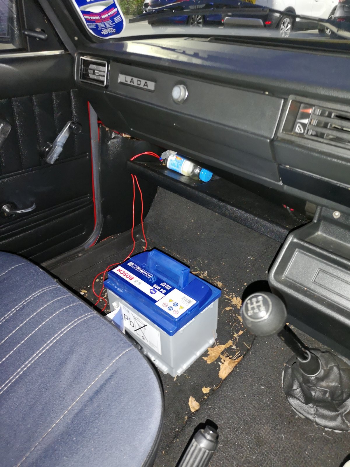

Going to give someone a lift somewhere this afternoon revealed the battery in the Activa seriously struggling to start it. It got it going but only just.
Returning from the quick run out I grabbed the multimeter. We're showing 14.25V off load at idle, and 13.95 with everything electrical on. As such I'm reasonably confident the charging system is doing what it should be. I know I've done quite a few short trips lately and the car was sitting for a couple of weeks waiting for the ball joint to be swapped, so it might just be a bit low because of that.
I've connected the charger up and will leave it overnight then see how things go. The charger showed "LO" as the charge status when connected so it seems to agree that it's pretty flat. Fingers crossed a good overnight charge will be all it needs.
