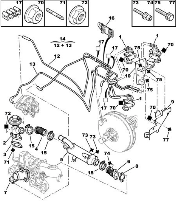

Did you connect it to something? It sounds like it could be the EGR that was disconnected...
Marc : can you please provide a diagram of the vacuum hoses on James’ car then we have something to work off when he comes over next week and specify what size of vac pipe it uses?
- Posts: 14305
- x 3304
Re: My turn for a C5!
I have connected the pipe to the electro valve that resides under that cover (there was an 'empty' spigot). There are two electro valves close together; one for the turbo, the other for the EGR (but I don't yet know which is which).
I cynically wonder if this had been done to either get some easy (and expensive) 'work', or to devalue the car to reduce the amount of money somebody would have to pay for it, or to mask an expensive fault for when somebody came to buy her. I know I bought it from a trader, but I wonder how much they knew about her.
- x 6956
Here you go - Arthur Itis in the fingers now.
Piping EGR
Piping EGR
