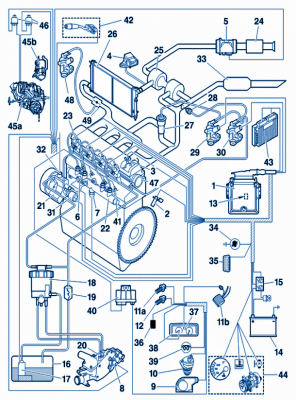

While it was quiet this morning I had a quick look under the bonnet at the vacuum piping. One of them (after the T join) headed off under the cover for the nearside sphere. After I took the cover off I found something unexpected. That pipe was not connected to anything, and had a bolt in it, blocking it. I don't know what THAT electro valve does, but I shall see what happens when I next take her out for a drive.
Michel
Re: My turn for a C5!
Did you connect it to something? It sounds like it could be the EGR that was disconnected...
Marc : can you please provide a diagram of the vacuum hoses on James’ car then we have something to work off when he comes over next week and specify what size of vac pipe it uses?

I have connected the pipe to the electro valve that resides under that cover (there was an 'empty' spigot). There are two electro valves close together; one for the turbo, the other for the EGR (but I don't yet know which is which).

- x 6954
Here you go - Arthur Itis in the fingers now.
Piping EGR
Piping EGR

Sorry about putting you to all this effort, Marc.
OK, re-connecting that pipe has not made any difference to her whatsoever. If I scratch my head any more I SHALL end up bald!

How much of a vacuum should there be on the vacuum pump (and should it be a smooth or pulsed vacuum)? I checked the pipe was secure on the pump, then I disconnected it and fired up the engine. There IS a vacuum, but it does not seem that strong, and (if the sound is anything to go by) it is pulsed.
- x 6954
James, have a look at the mechanics manuals I uploaded
viewtopic.php?f=3&t=61218#p590278
The pressures for the air supply circuit to the butterfly valve / EGR etc are shown there for testing,. There is not a lot of pressure needed at all:
Download the C5 MK I 2004 manual and look on pages 218-219. Your engine is the RHZ variant.
